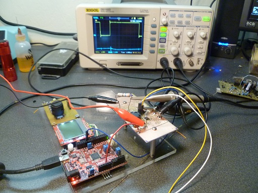

    here's a link to a video i made just doing a few basic tests on my new front end board, for these tests i used Moodz's unipi project as a pulse generator.
    http://youtu.be/_GooYyYEwwo
    if you noticed the ripple in the wave forms, i haven't figured out what is causing it, i'm thinking my cheap Ebay scope probes may be to blame

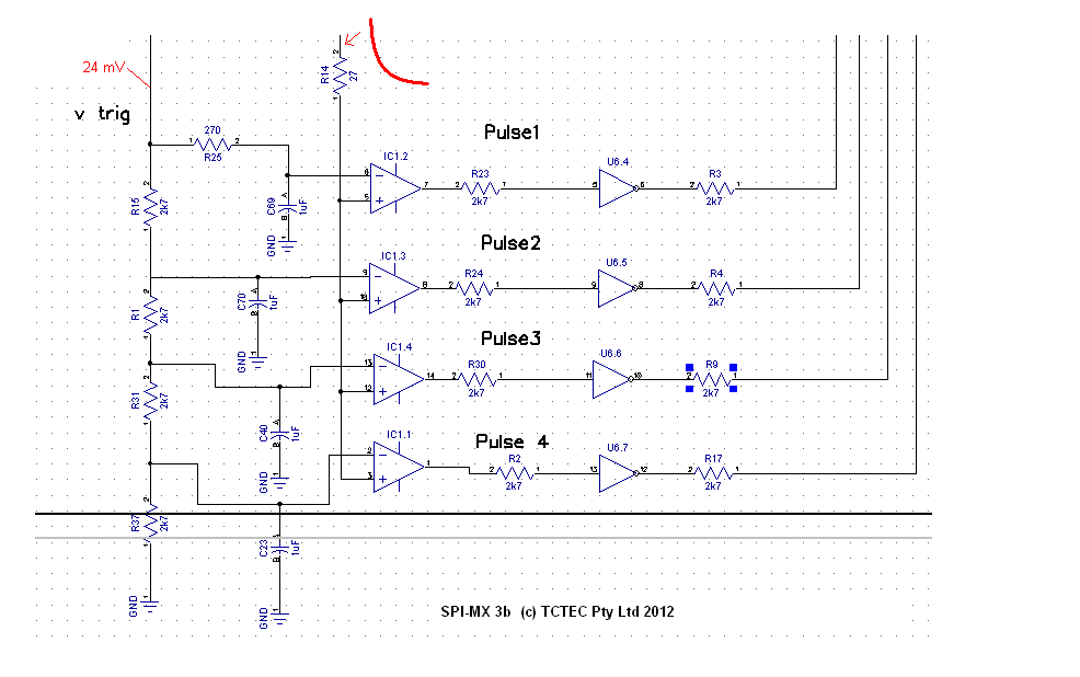

          I have attached the circuit I use to convert the discharge signal to pulses,the coil signal goes straight in.

            your circuit is pretty cool,
            look at your pic 32 data sheet, your circuit may be already their for you.

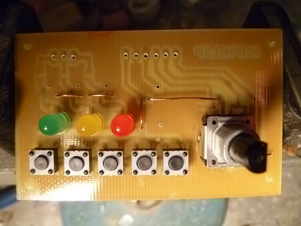

                    It's been a while sense i posted, but trust me I've been hard at work on my project. ( check my postings in moodz's thread)
                    I've reached a point where some sort of menu for adjusting all of the timing parameters important.

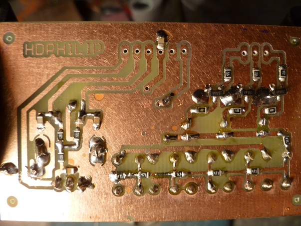

                    so in order to solve the menu problem, I've created a pushbutton input board.
                    this board has the following features:
                    A. 5 push buttons that work on a voltage divider, so they will use only 1 analog input.
                    B. rotary encoder with a push switch
                    C. 3 led's, these can be programmed for testing purpose
                    I'm not sure yet on how the menu will be put together, but rest assured it will be cool....
                    so here some pictures:

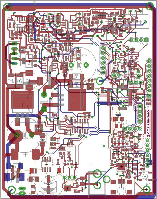

                          • here's the latest on my version of the qed:
                            still have some more work to do, hope it works!
                            Philip

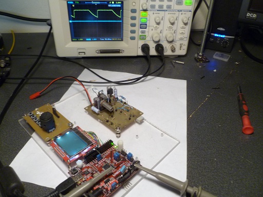

                            • here's a few pictures,
                              before i send off my pcb board to the fab house, their are a few important aspects of the QED i want to experiment with.
                              the first is the power supply. and the second are the OPA2735 circuit.
                              so what i've done is made a pcb to test out those circuits, but most important of all is to write some software to support them.
                              then with a good handle with the pic32 software i'll be able to sleep a little better when i do have a pcboard made.
                              also on the board i included a charger circuit for the lipo's, but it didn't turn out as well as i wished, but well enough to give it a try.
                              the other picture is my test setup, if all goes well the QED power supply should power it

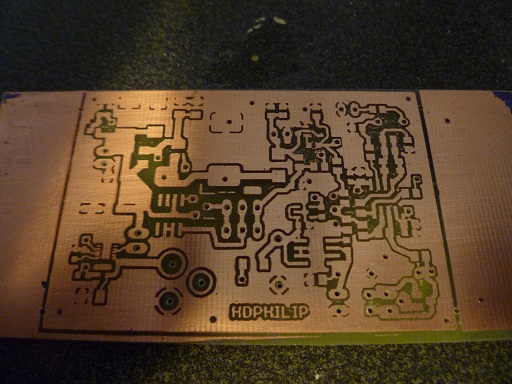

                              • well the QED based power supply board seems to work, here's some numbers so far,
                                input 7.1 volts 228 ma
                                output -7.00 volts 178ma
                                so were off to a good start
                                next step hook up the feedback loop, work on the software, put some numbers on the lcd display, add the +5,-5 regulators do some more load tests.
                                here's the newly made pcboard (this morning) on the operateing table
