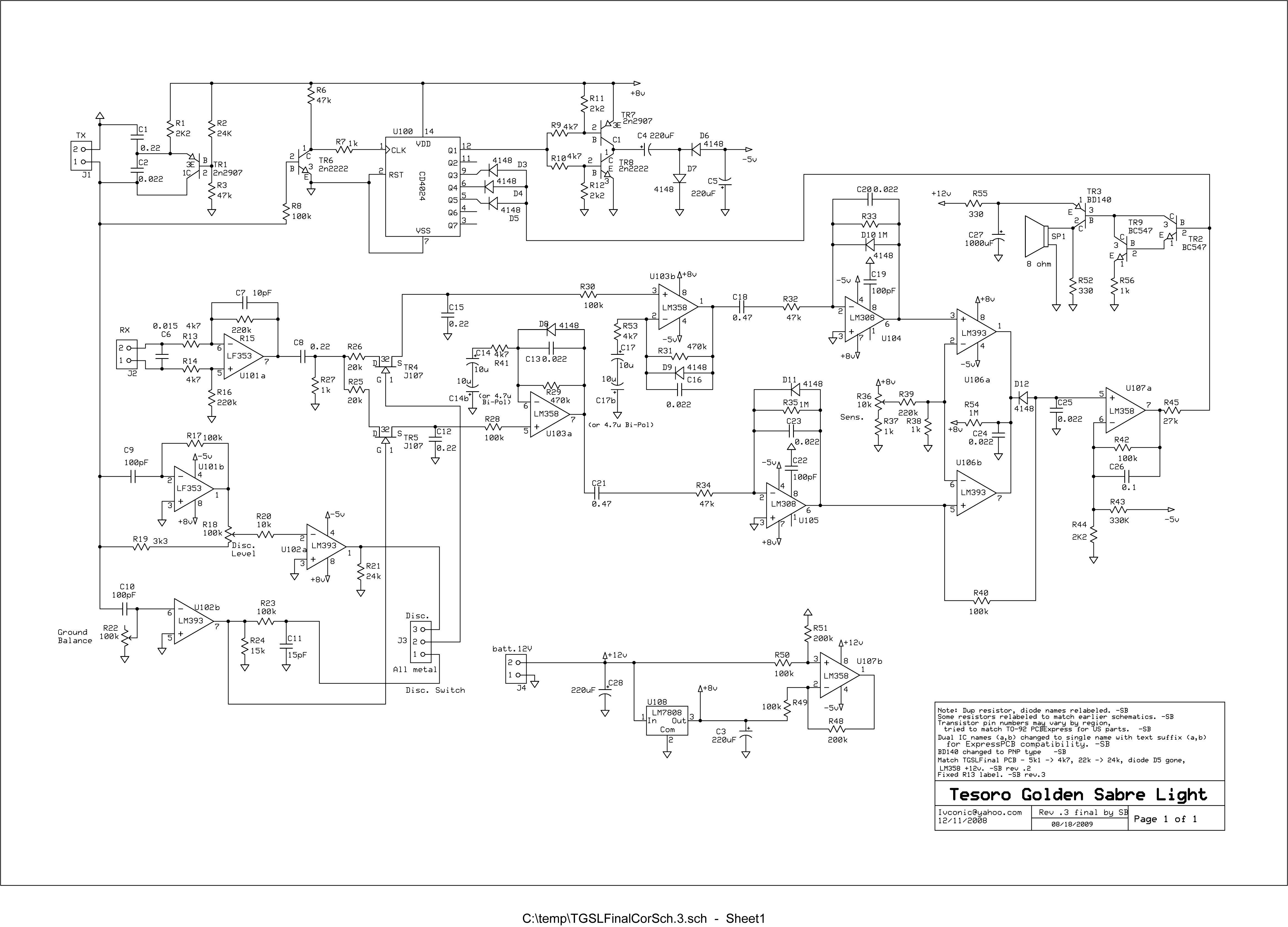

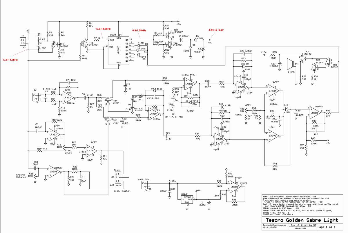

it's that making by Ivconics, C1=220000PF,C2=22000PF,C6=0.015UF,L1=6mH.L2=6.5mH

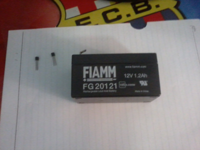

and someone ask me if he can use J108 TRA(TR4,TR5) instead J107 because he cannot found it?.
