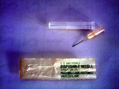

              I have Infinium and I tested it (8" coil) on stainless needle (hypodermic needles for single use). It cannot detect it at all, nor in coil touch.
              There exist (factory) moded Infinium for military use (demining), I believe it can detect such things as small stainless parts (used in some land-mines too. Regretfully too expensive machine.

                I just checked Deus on small needle.
                It was not detected at all.
                I tried all the factory preset programs.
                No detection at all.
                Yet this is indeed very small, tiny needle (~2cm long and ~0.4-0.7mm dia).
                I think we are expecting too much from detectors.

                            OK on those needles, a GMT,GM3 Whites,or a Gold Bug 2, will find
                            them easy. Also a Garrett Recon Pro ,or a Minelab F3 mine detector
                            would get them too,and at depth. You can buy both mine detectors
                            as military surplus with the complete kit including chargers pretty cheap.

                                As I say, stainless hypodermic needle it cannot detect at all.
