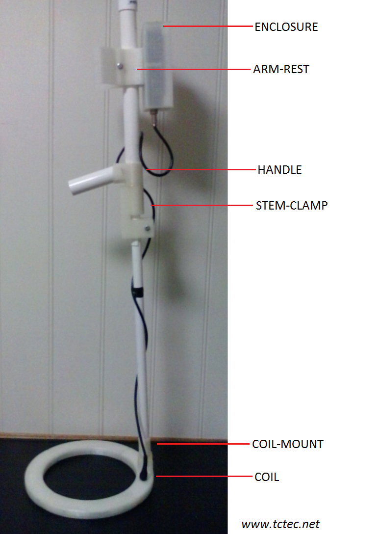

    Over the last few weeks I have been working with my New 3D printer ($1600),
    and it really is a technological revolution..
    I have managed to make all the parts of a detector that are usually frustrating, in particular the coil.., but also the Clamp for adjusting the Stem, and the arm-rest.
    In some cases they may be lighter and better than a commercial detector .
    See attached.
    As a complete CAD drawing novice, I have downloaded 'Sketch-up' (free) and spent about 2 weeks using it.
    Now I feel I can draw and create almost anything.
    I am still to field test these parts.
    The main drawback of 3D printing is that is is slow. It takes a half a day to print some of these components.
    Also, the coil has to be made of 13 separate parts and glued (epoxied) together.
    If you have a 3D printer...then feel free to download them.
    https://github.com/tctec/SpiMX-Shield-Parts-1
    Plastic: PLA , no 'supports' or 'rafts' , Shells = 4, Fill = 20%
    Notes:
    The top stem and Handle is 25mm PVC pipe
    The lower stem is 15mm PVC pipe stiffened with pine dowel glued (Liquid nails or Epoxy) inside.

      Is this a PI detector?

              This must be TEC's SPI-MX, see http://www.geotech1.com/forums/showt...ses-Arduino%29

                    From searching they seem to use, ABS (acrylonitrile butadiene styrene) thermoplastic,
                    and PLA (Polylactic acid) is derived from corn and is biodegradable. PLA is not the recommended plastic to print with, as the material starts breaking down after a few months and printed parts are brittle.
                    The material is very sharp when broken and can be a hazard when removing support material from the printed parts.
                      for all the chatter about 3d printing, its still only of use for prototyping, i have a makerbot replicator(older model with laser cut plywood case), and for small plastic parts its ok, but for long lifespan parts, its better to use the made part as a pattern, and cast parts from stronger materials.
                      pla degrades too quickly, and abs is harder to print and noxious too, i have experimented with nylon, but illness cut my experiments short, i have not been in the workshop for months.
