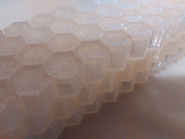

                          Here is something I printed yesterday , it is 1cm hexagons, separated by 0.5 mm gap. When I brush epoxy on it , it becomes quite strong. How strong I don't know yet...
                            Interesting, I was thinking about trying to print a riffle tray for a river gold sluice, do you think PLA would hold up in water.
                              Good idea, I'm not sure how long PLA would last, I haven't used it in water yet. I think it breaks down over time. It should last a for a few sessions at least..
