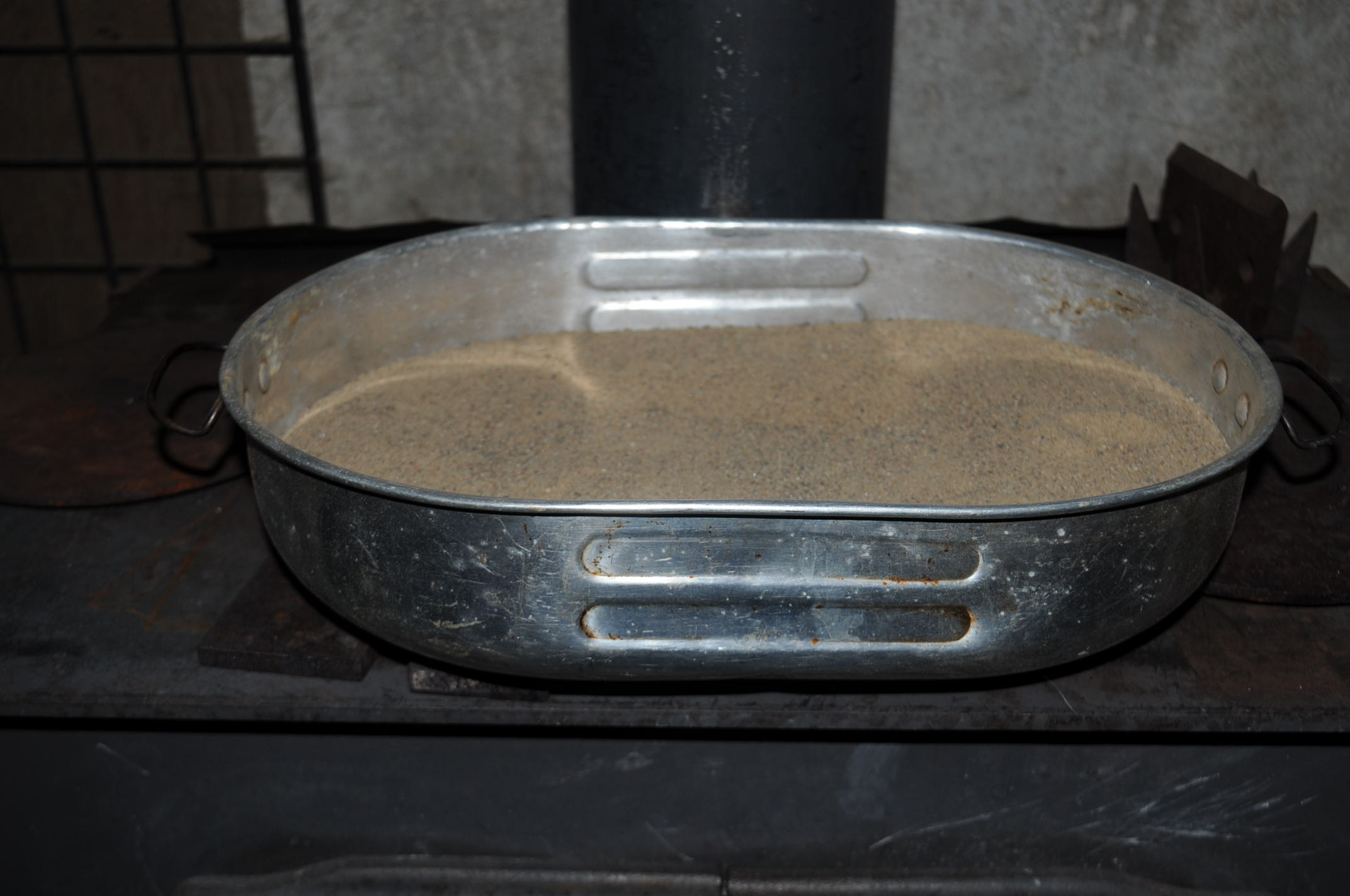

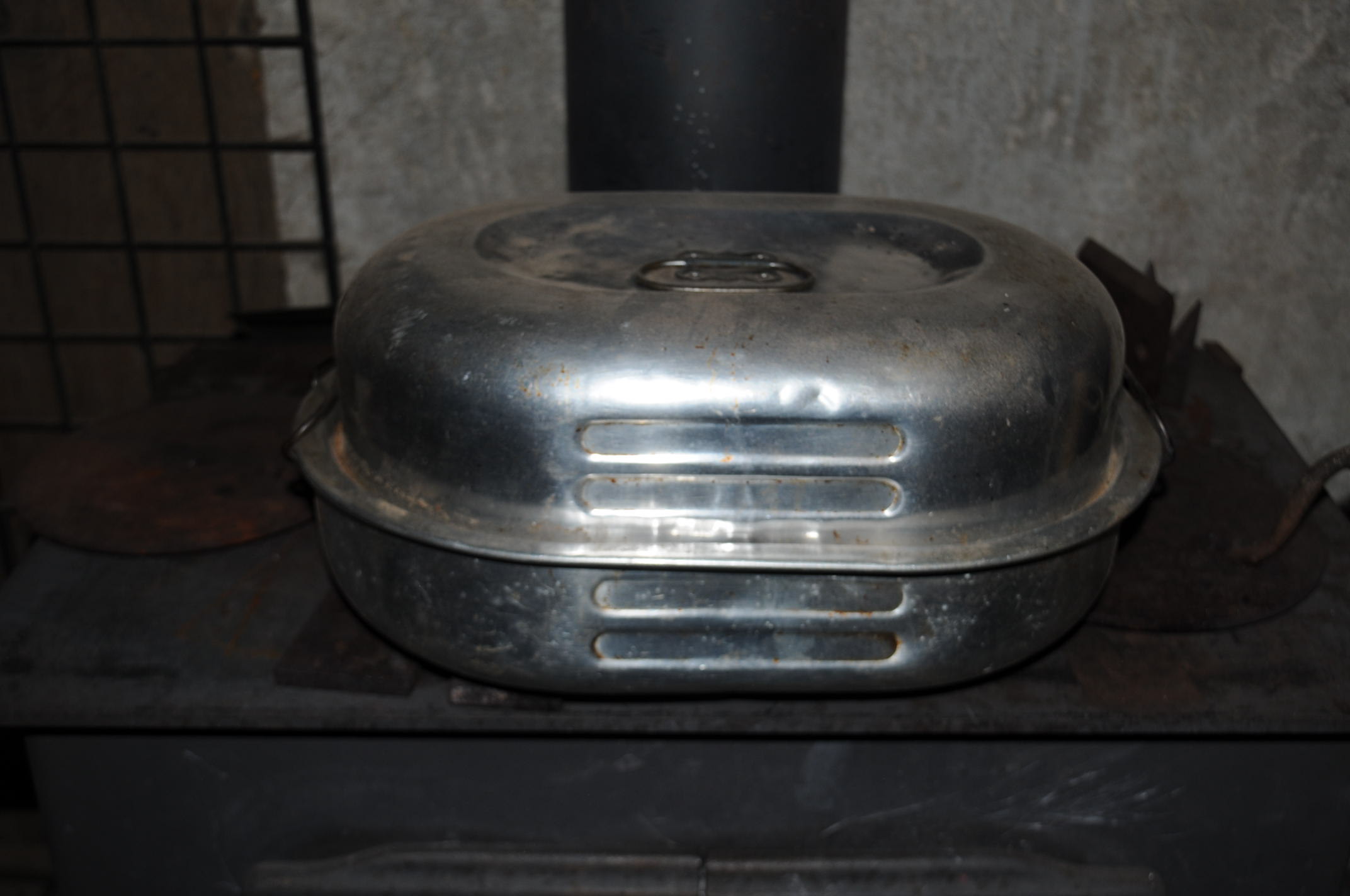

            Holding parts in sand while heating is actually a very good idea , I have oven rotisserie pot thing that is half filled with sand, which I use to dry nylon filament over the wood stove ( see photos) ) I will print a few test pieces and try to anile them in the sand.
            What I use for stems now is 1/2 inch and a 1 inch PVC pipe, I cut to length and place the 1/2 inch on the wood lathe and reduce the OD so that it slips into the 1 inch pipe. It works out rather well and doesn't take long to make them fit lose enough to slide and still be snug enough to be stiff when swinging a coil around.

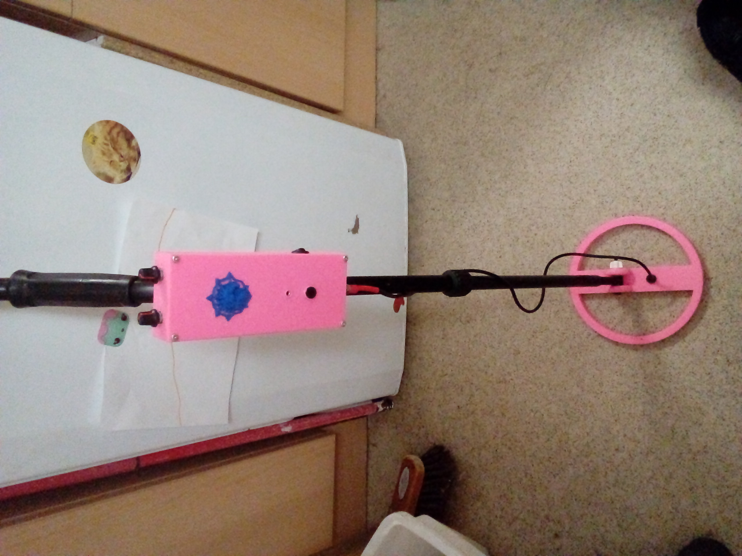

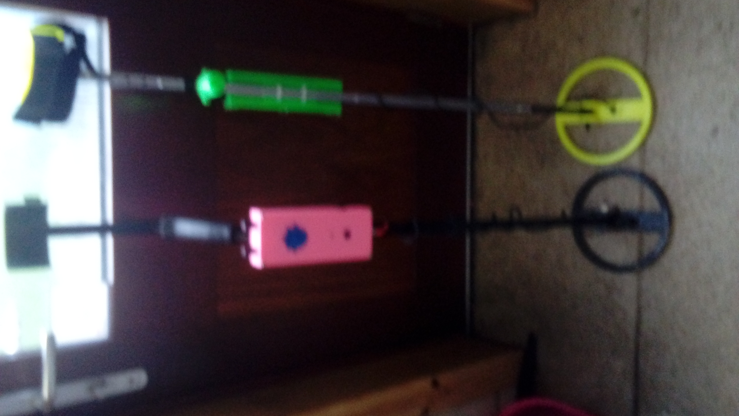

                      its all printed apart from the stem that folds, the bottom stem is printed my kids barra has had some treatment lol in she has never broke nothing, it must be the way your all printing them

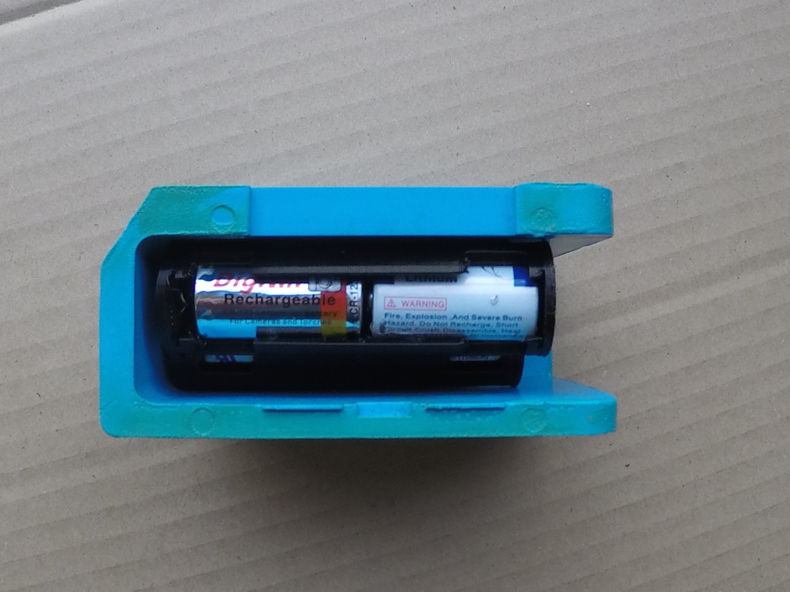

ID:	350480 just finished some battery holders for a compass 77b that I required through ebay. missing some parts and not working so good repaired board and all is sweet with detector but had to make up some cr123a battery holders to fit in battery box, next will be a cover for speaker and battery box cover/lock. they even fit my xt17000ml so bonus.so put it in a zip file and posted here if you would like to use it
