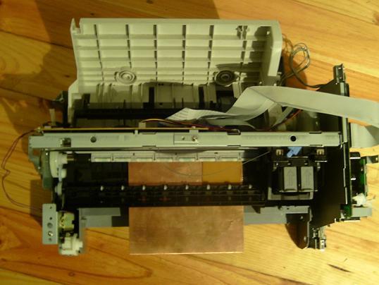

                  Not sure if Andreas still posts here, but what he was referring to his initial post was modifying a existing printer to accept the right thickness PCB+feeder plate to print direct on to the PCB instead of paper then place in acid to etch.
                  I just started to modify a surplus Canon printer after seing a Youtube video which someone did the same and produced boards to accomidate up to SMT format. Dont have a link to it, but you could do a search.
                  The process is you first print on rear feeder plate to see where you will place the blank PCB. Then you tape the PCB on the rear plate where the outline is established, heat it up with a hot air gun to allow ink to stick better and re-feed it through the printer to produce the track layout. Reheat the board again so the ink dries up well and then place in the etching solution.
                  Very simple process with great results if you can modify the printer to accept the right thickness.
                  Not all printers will do due to mechanical restrictions and some require the scanner bed connected due to fault symptoms diagnosis restricting proper operation.
                  The one i have here still works without the scanner bed so even though it detects that it is not connected....it still works. Not many do, but this model Canon does
                  There is alot to modify, but will see if the effort is worth it. Slow project, but on the to do list.
                  Cheers Sid
