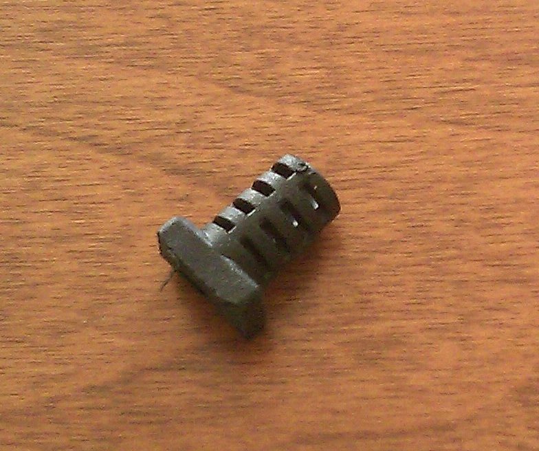

      Nothing special there.. Just feed the strain relief through the bottom of the coil shell, the cable through the top, then crazy glue in place. The epoxy does the rest.

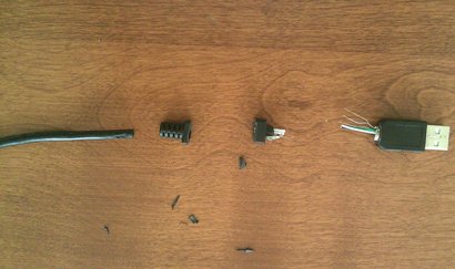

        I think I get it. To confirm:
        Am I correct that you sacrifice one connector of the USB cable, cutting close to the pins so the cable strain relief is still part of the cable, then just position the strain relief part to poke through the coil shell, and solder the coil wires to whatever is left when you cut the connector?
        I am interested in your streamlined coil shell for some time later, it looks nice and light.

          Yes, that's correct. If you do it right, you may even be able to leave the strain relief connected to the cable instead of removing it like I did. I just superglue it back on.

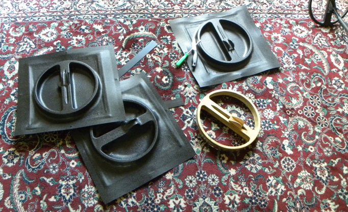

              I was on a roll today..
              I can crank one out about every 10 minutes.. but I have to find a faster way to cut them..
                Hoowee -- i'm salivating...!
                -SB
                  Nice work Don. Could you use a hot wire to cut them?
                    I can give it a try, but I'm wondering if it would just melt the plastic and weld back together after the wire passes. I've done model airplane foam wing cores before and the wire just vaporizes the foam as the wire passes.
                      Could you put a little dremel with a cutting tool in a jig, put the forms on your coil winder turntable, and rotate it around? (probably take me weeks to set up... not to mention plastic dust... never mind!)
                      Laser is the way to go! I think Goldfinger had one that would do nicely...
                      -SB

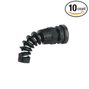

                        I finally found a source of "real" strain reliefs:
                        http://www.amazon.com/Heyco-PIGTAIL-LIQUID-CONNECTOR-package/dp/B001BQ02VE/ref=sr_1_1?ie=UTF8&s=industrial&qid=1295455753&sr= 8-1
                          http://www.amazon.com/Heyco-PIGTAIL-...5455753&sr=8-1
                          Good to know, thanks!
                          -SB
