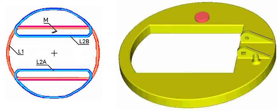

              Don, I would like to produce housings for a model differential sensing head. My loop configuration is DOD as shown below.
              My question is how to form robust ears for clevis tube? With your former they will be hollow and will have thin walls.
                strenghten the sensible parts with epoxy and glasfibre
                                Mike,
                                Yes, the "ears" for the clevis are hollow and have thin walls but once filled with exopy they they become extremely rigid. I have not broken one yet. I sometimes even mix in short strands of fiberglass. It is easy to make them as strong as needed.
                                I think that might be the way that Hays makes theirs as well.
