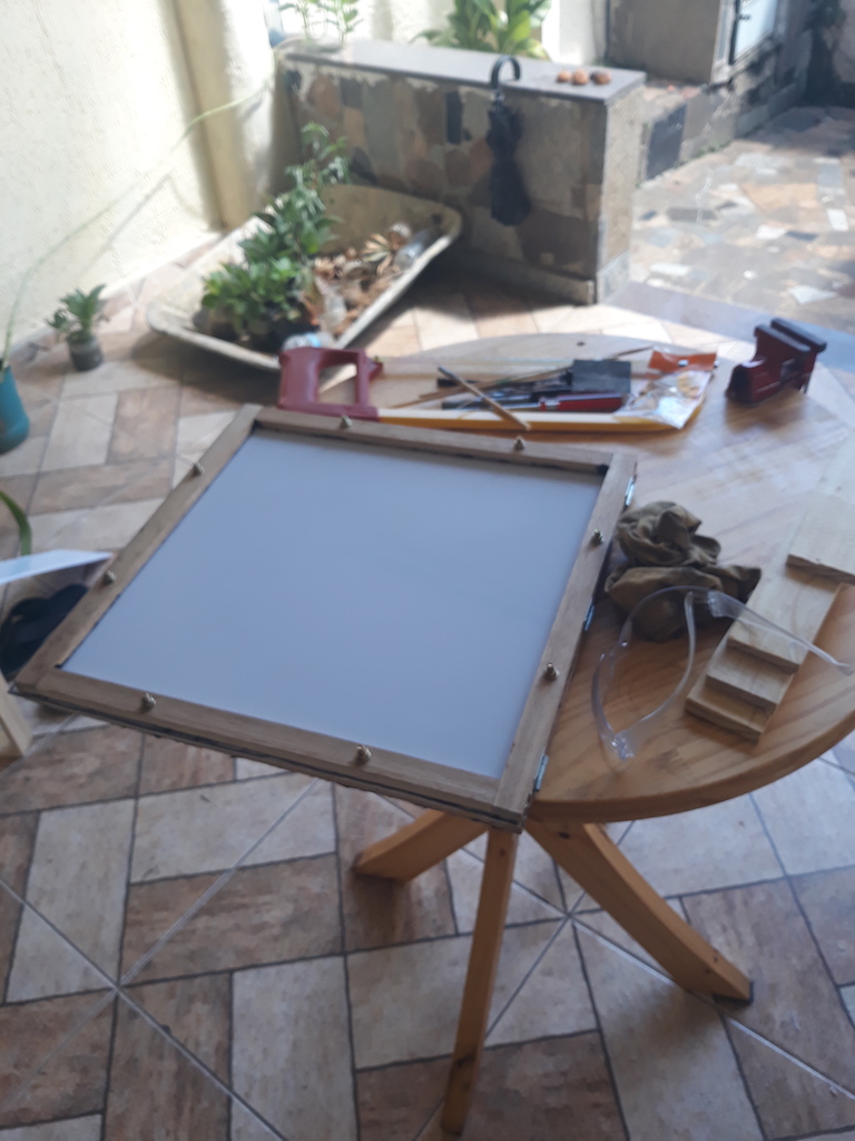

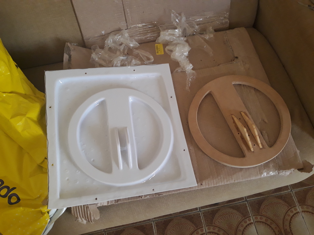

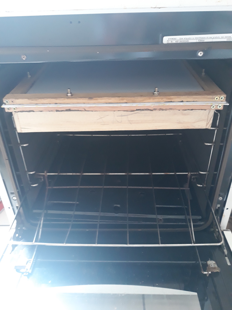

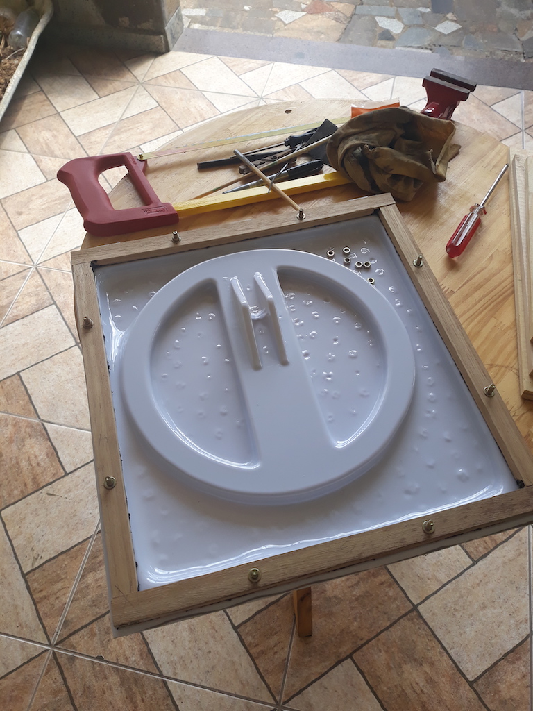

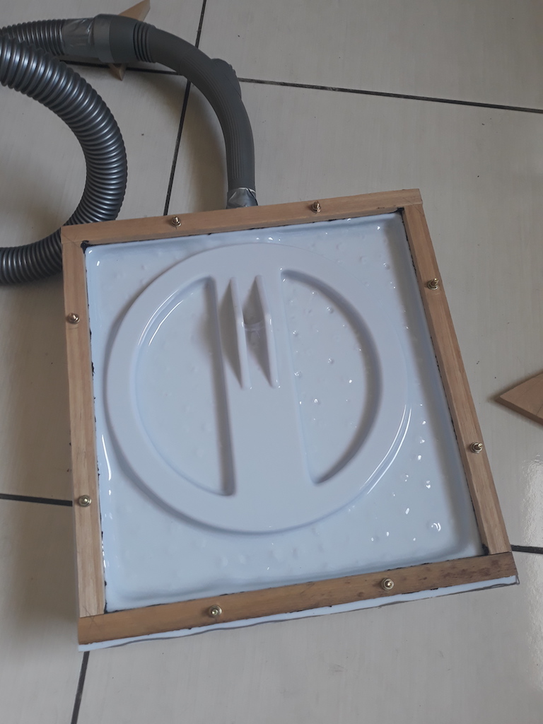

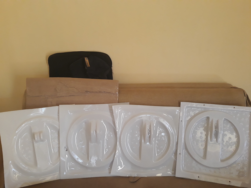

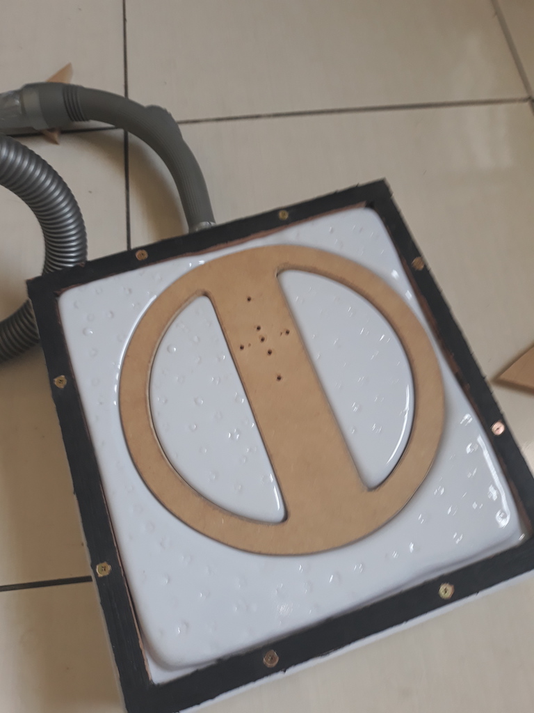

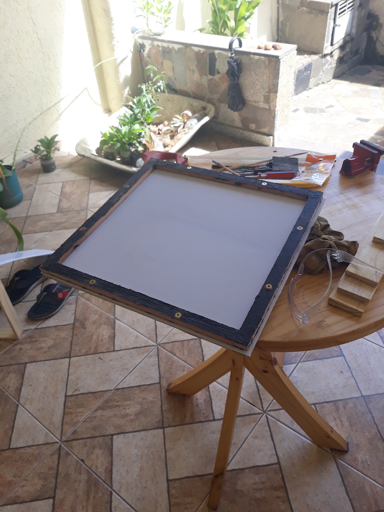

          Finally it almost worked!
          I added some screws to the frame, to keep the sheet in place while heating.
          Also bought an infrared thermometer to ensure a good temperature.
          Used 2mm polystyrene because here is difficult to get other thicknesses like (1.5 or 1.6mm).
          Formed at about 150 degrees celsius at the center of the plastic.
          My only problem is that it seems that I slightly moved the form to one side (not perfectly centered) so one of the sides not formed perfectly but I will fix this next time.
          Here is a video and some pictures of the work:

          From error to success (left to right):

            Well done. Try adding two small wooden pegs to the bottom of your former. These should line up with two holes in your vacuum table and will prevent the former from moving.

                I have alignment tabs on the edges of my former so it goes into the right place everytime.
                Along with temperature, I measure the amount of sag in the plastic while heating for consistency.
                Inside your tabs.. no need for a wrinkle. It may be too hot if that occurs. Use a piece of wood to stretch and coax the plastic to the center of the tabs. It took me a long time to get it right but I hardly ever have a dud or a wrinkle anymore.
