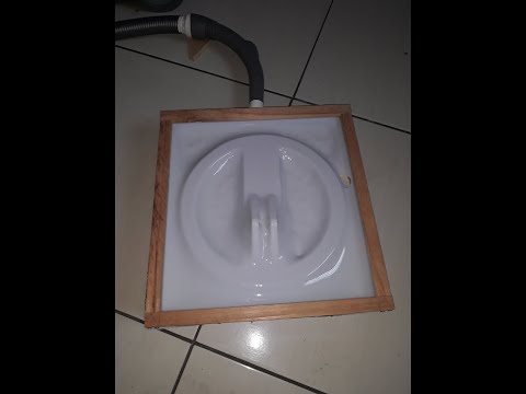

                  This was my first vacuum form try, but I failed.
                  I think this polystyrene (2mm thick) plastic is too brittle.
                  I need to find an ABS sheet but it is difficult here in Brazil.

                      The ear part is too thick, make it thinner. Good luck!

                        You will have several fails before you get it right. Keep on trying. Looks like your plastic cooled before it had fully formed. You probably need more holes in your vacuum bed. Make sure these follow the inner and outer perimeters of your former, especially on the tight inside curves. Also, drill a few small holes through your former between the lugs. If you don't want to re-drill your vacuum bed, lay over a piece of ply or MDF with holes drilled to suit your former. The oven method never worked for me because the plastic cooled to quickly, so I built a simple forming machine with integral heater.

                              Thanks all for the tips, I will try with a thinner plastic (1mm), also I will pay more attention to the temperature and reduce the ears thickness and open some holes near them.
