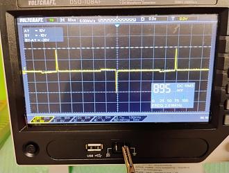

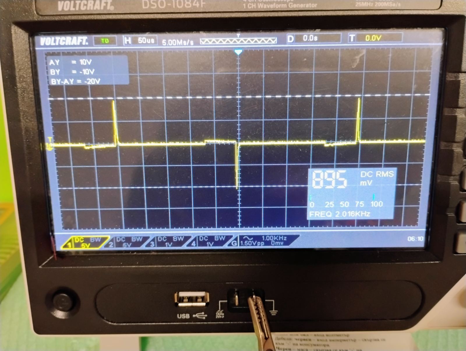

        Apologies to Carl and all forum participants...
        The video did not show how many volts the peak of the final transistors is...
        Something like that... Click image for larger version
        • #94
          At 9:14 it appears to be 250-300V.
          • #95
            Sorry again, I didn't pay attention to the scope of the oscilloscope probe...
            Thanks for the video and your time...
            I'm glad there are people like you - stay alive and well...

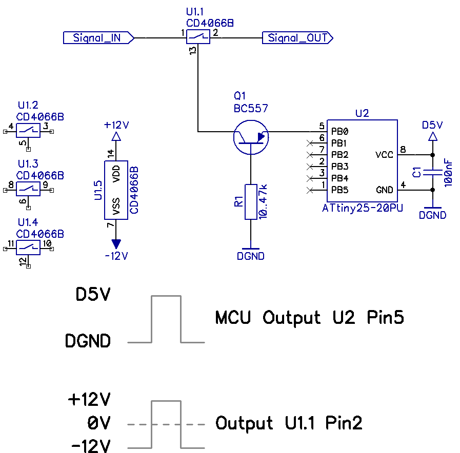

                    Could I put a 74HCT4066 instead, making the corresponding modifications on the PCB on the power pins, since they are different? I've also thought about using a CD4066 and adding 4 voltage converters with 4 PNP transistors and 8 resistors just like in the Arduino Nano PI. In your opinion, which of the two variants would be the best?
                    Any 4066 will require the level converters since the clocks must be referenced to -5V. Once you do that, probably most any 4066 will work as long as it's rated to handle the 10V power supply. Whether one is better than the other often depends on the company who made it and what IC process they used. You have to test and compare.
                    • Thank you very much Carl for responding and clarifying my question. I'm thinking of using a HEF4066 and its four corresponding level converters. I'm thinking that when using level converters, the square waves of the four signals coming out of the PIC would have to be inverted. Am I right?
                      • Correct.
                        • Hi Carl and thanks again for answering my question.
                          I need one last favor from you, as I have no experience with PIC microcontrollers. I have only worked with AVRs and I don't have any kind of compiler for the PIC. Could you post a HEX file on the forum with the four signals inverted? This would save me a lot of work, as I have opted to use a HEF4066 and the four level converters. I'm in no hurry, do it at your convenience.
                          Thanks in advance.​
                          • Hi eduardo1979,
                            For controlling of 4066 no need to use inverting pulses from uP. Emitters of the PNP have to be connected to corresponding uP outputs and bases have to be connected to the Gnd via 10K-47K resistors. Thus, PNP will works as non-inverting level translators from 0/+5 volts to -5/+5 volts.
                            • Hi detectorist#1
                              does this small circuit below shows what you wrote about the non-inverting level transistor circuit in post #103 (above)?
Name:	Non-inverting level transistor circuit for MCU.png
                              • Hi GeoMax,
                                No. CD4066B have to be supplied from +5V and -5V. And the collector of BC557 have to be connected via 10K resistor to minus 5V supply.
