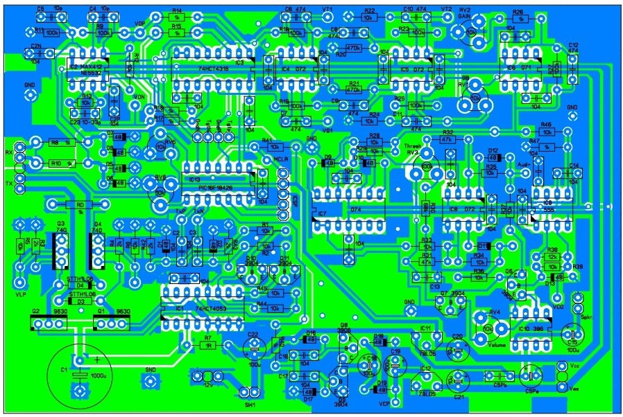

            Hello ,Ivconic​ can you post the lay shape of the board without the solder mask that you drew I want to make some corrections before I release the boards.. Thank​s.
            • #81
              I don't have it without ground planes.

                yes, but the Carl Gerbers are with a program that I didn't draw and I can't convert them to Sprint Layout or EasyEDA for correction, and in your post #54​ the mask is drawn by hand, that's why I asked, I thought you had a file that you can do correction.but there are no problems, I started to delete the top layer, it's slow, but it will be as Carl Click image for larger version

                  Hi Algan,
                  why don't you just draw your own circuit board? Then you can make any changes you want and you don't have to rely on the work of others​.
                  • #84
                    Originally posted by algan View Post
                    yes, but the Carl Gerbers are with a program that I didn't draw and I can't convert them to Sprint Layout or EasyEDA for correction, and in your post #54​ the mask is drawn by hand, that's why I asked, I thought you had a file that you can do correction.but there are no problems, I started to delete the top layer, it's slow, but it will be as Carl Click image for larger version  Name:	BiPolITMD3.lay6]_page-0001.jpg Views:	0 Size:	266.8 KB ID:	433929 said, I need sound correction and someone else
                    In half an hour or so, you can clean up the board that you converted from the Gerber files by marking the unnecessary paths and using the "delete" function. Then you use the "test" function and check for missing connections.If there are any, you restore them using the "track" function​. It's laborious, I know, but unfortunately the Gerber import function of Sprint Layout is imperfect.​
                    See partially cleaned circuit board.​
                    • #85
                      Yes, I managed to draw two boards 80mmx90mm, but I still have the generator and around the generator, which will also be on a separate board, yes it will be smaller and yes the errors may not be seen until the detector is launched, but it is important, as they say, the idea and everyone can experiment with different variants, the important thing is to try.

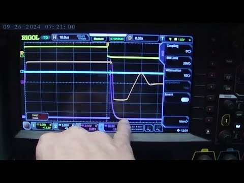

                              • #90
                                I've created a video describing the Bipolar PI circuit. Sorry for the poor quality, I need some better equipment.
