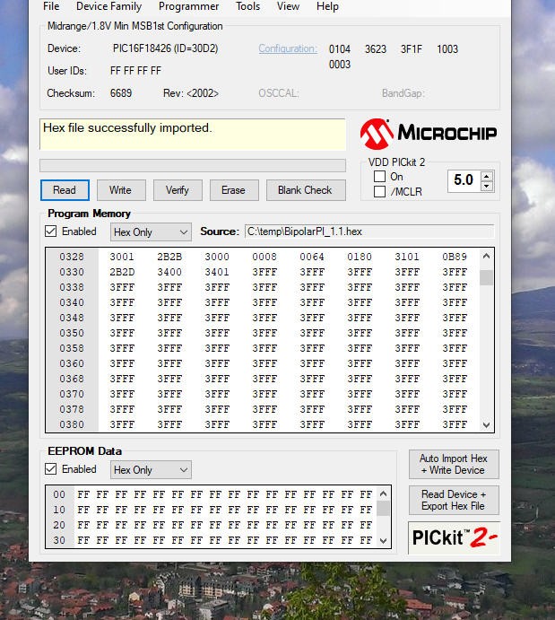

    Now I'm in the angry (productive) phase... and I'll dedicate a few days to trying to get Mplab to work with Pickit2 and support this processor.
    I've come too far to give up so easily. A moment of weakness and fatigue... but I will continue.

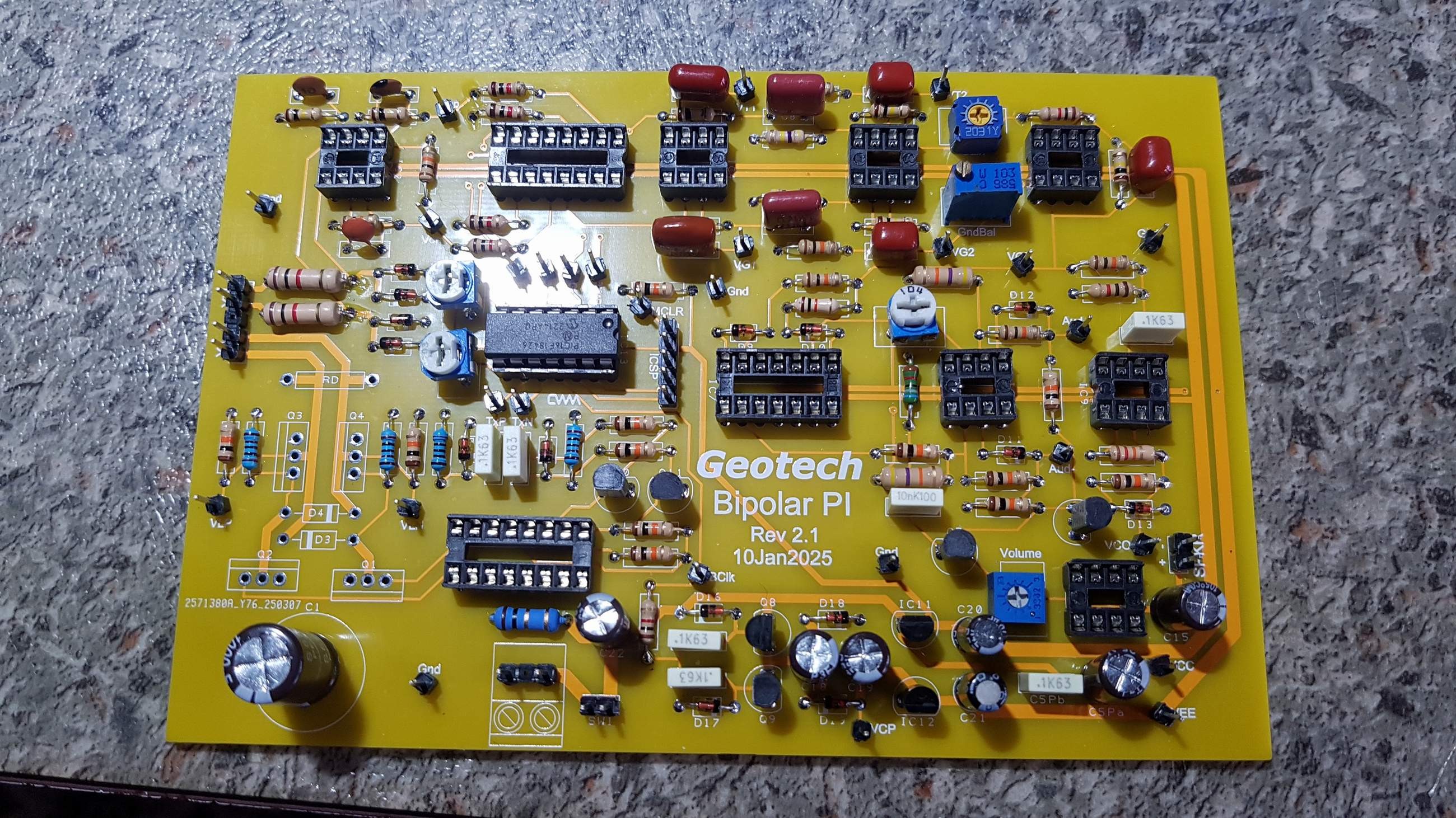

    • Say Carl... C1 is having large footprint as it was 10 000uF and not 1000uF?
      Confim or deny this, please.
      Look on my photo above; i put 1000uF and it doesn't look right.

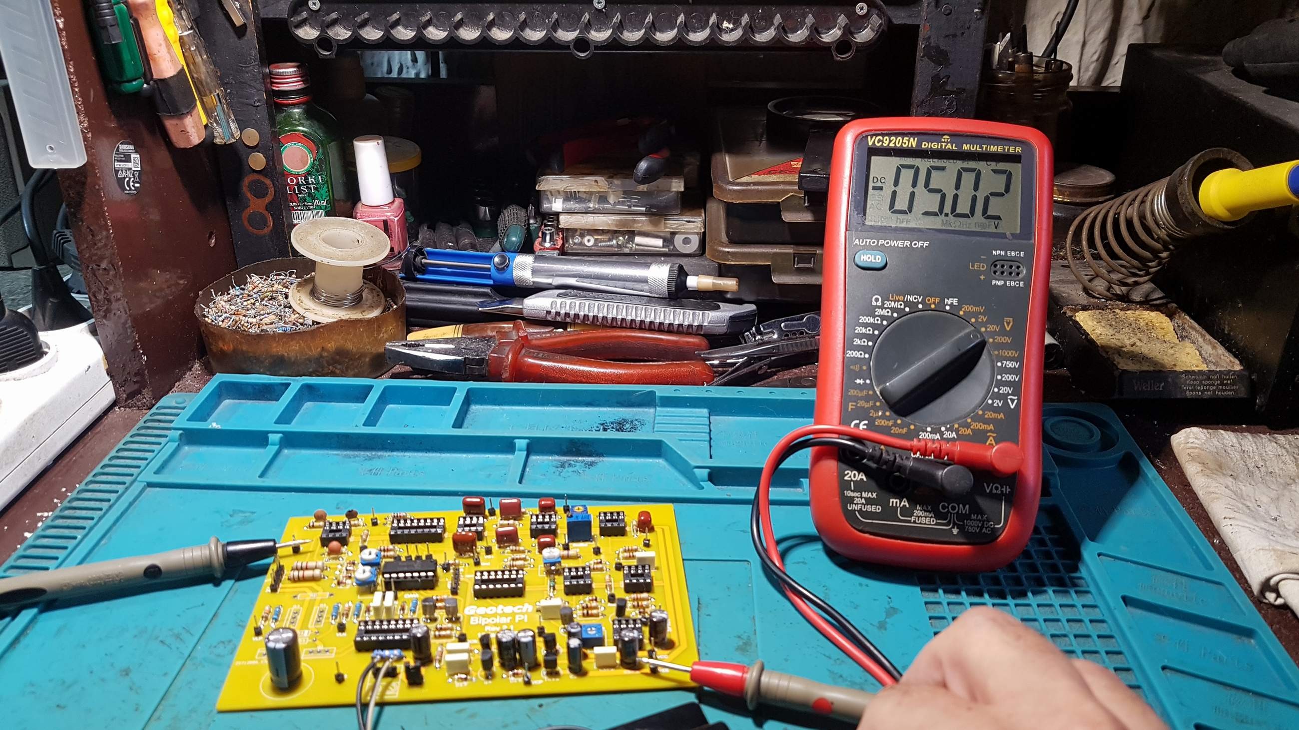

      • As I wrote... it's enough for something to make me very angry... to the point where I faint and give up... and then being so angry I IMMEDIATELY find a perfectly easy solution!
        The code seems to be flashed correctly.
        Initial test shows good generated voltage... to be continued:

        • I made the C1 footprint large so you can use a bigger cap if you want.

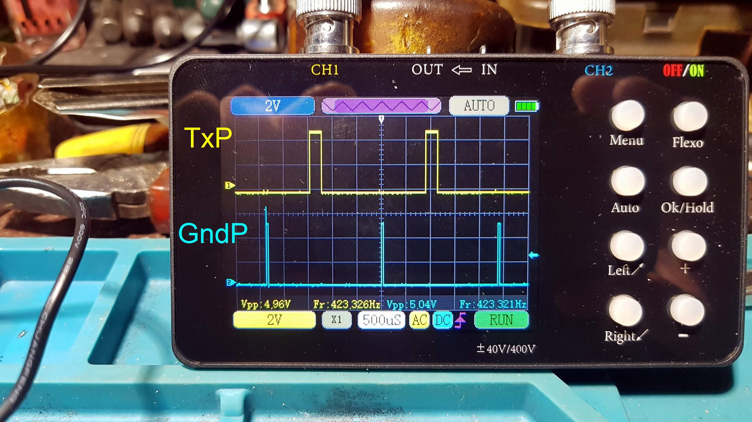

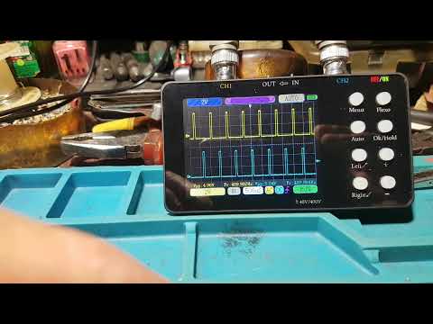

                • Have you tried the frequency control or the delay control?
                  • Flashing the chip apparently worked.
                    Everything behaves as it should.

                    I noticed that the two trimmers I put in, used ones, are not working well.
                    I will have to replace them with quality potentiometers (like in Carl's picture).
                      Video on #231 shows exactly that.
                      Oh sorry!
                      The video only shows the frequency setting!
                      I recorded the delay, but the recording turned out bad, so I deleted it.
                      Yes, delay works too.

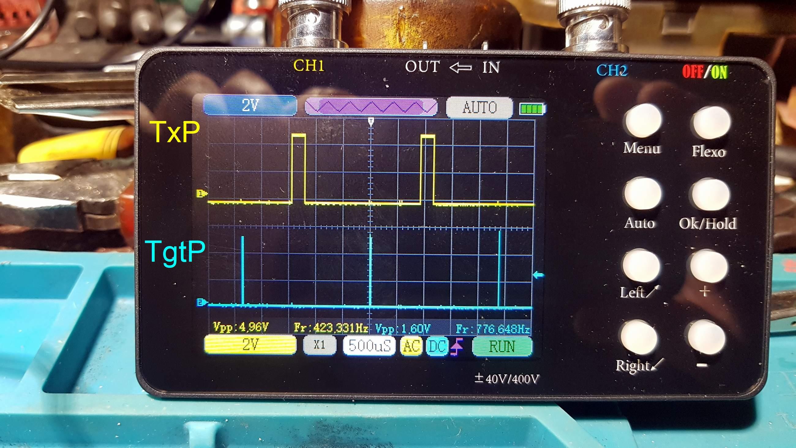

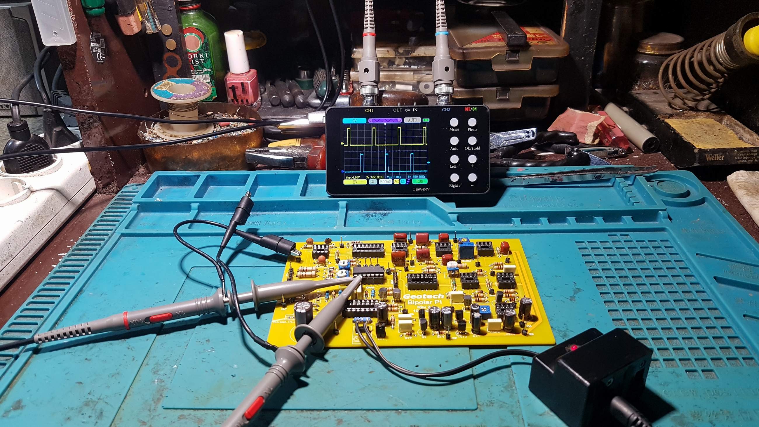

                      • Although, it is difficult to clearly see the shift in the delay on such a small oscilloscope, but it is still roughly visible.

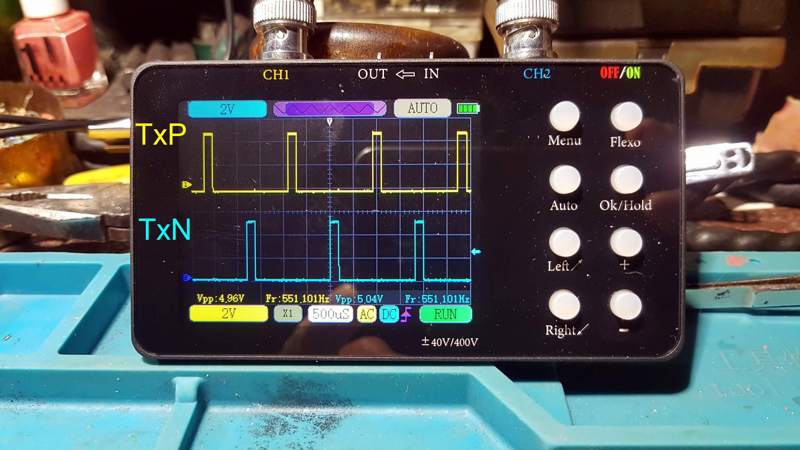

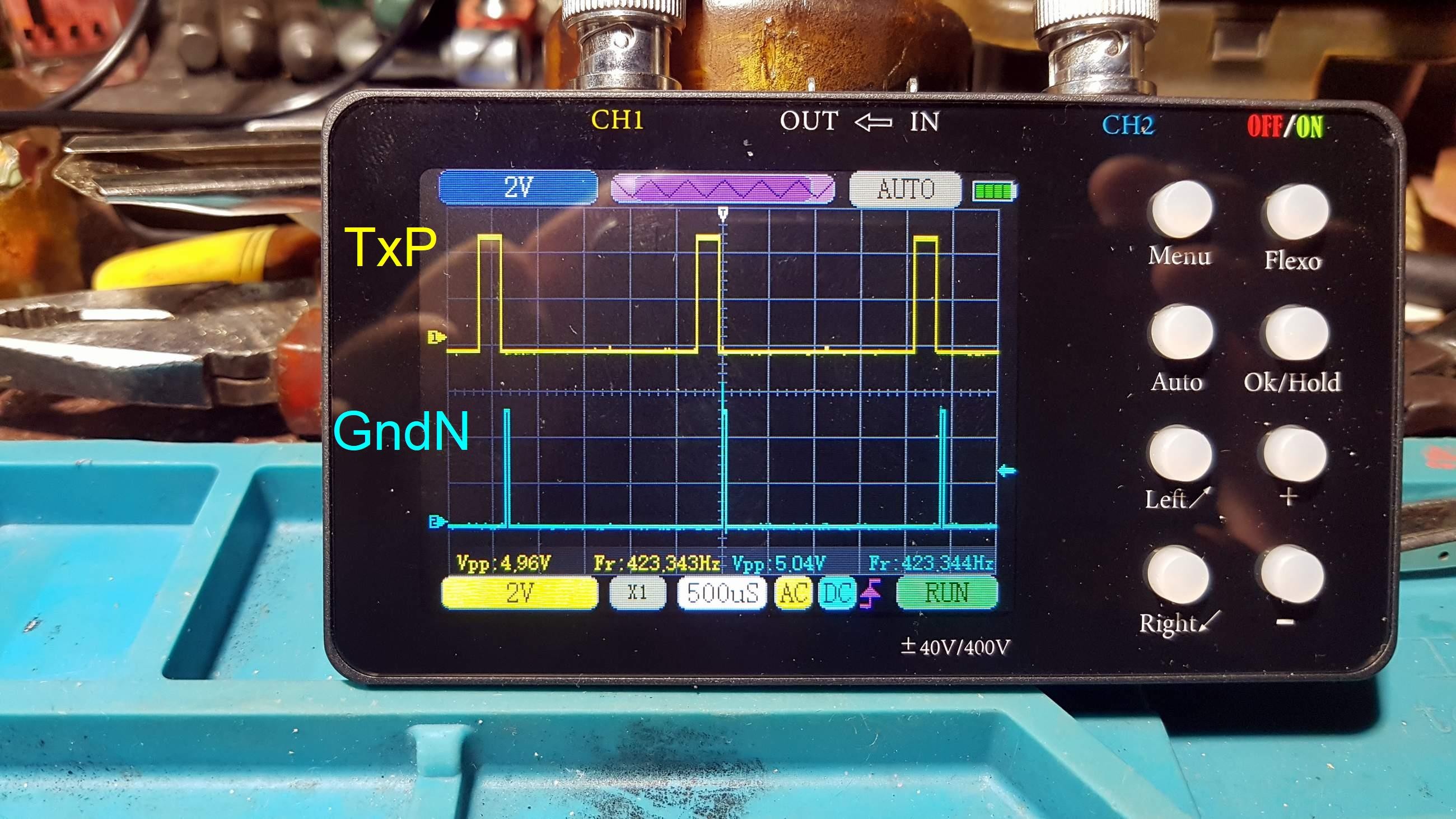

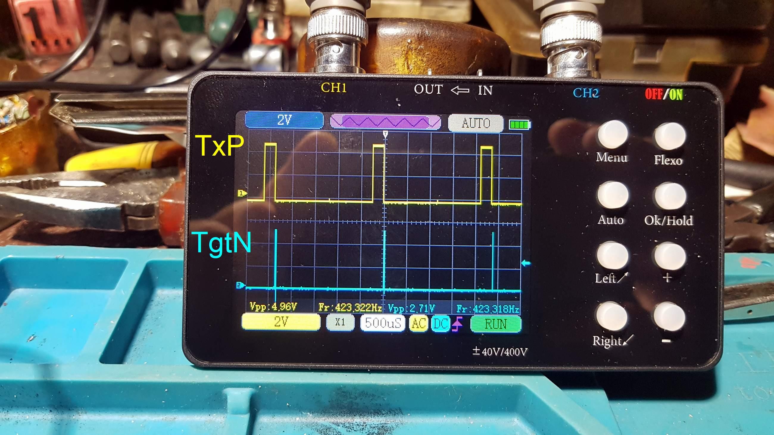

                        Yes, I noticed one thing; when I set the delay, upper oscillogram, TxP; moves, while the lower oscillogram (one of 4) stands still in place.
                        (the 10k trick doesn't work, so I can trace only one by one)
                        I might have to check everything on a big oscilloscope after all.
                        This little oscilloscope is surprisingly good... but not that good!
                        • Carl, apparently the frequency adjustment range is very wide, going from about 330Hz to as high as 1.8kHz.

                          • The question "is it safe" refers to the case if I use the proposed mosfet transistors as well as the fact that it is an H-Bridge configuration.
                            Maybe it's a good idea to "fix" the frequency with a fixed resistance?
                            It's even easier and more precise to do it in code.
                            But for now, it's good to have the ability to adjust it for further experiments.
                            I am considering some "better" P-channel transistors for now.

                            Although I've been terribly lazy lately... I'm too curious to repeat the measurements with the big oscilloscope!
                            The 10k resistor trick on all 4 samples worked very easily on the GS4... who remembers that video.
                            But it doesn't work on this one.
                            I wonder if it's because of the oscilloscope, I'll have to try it on the big one!

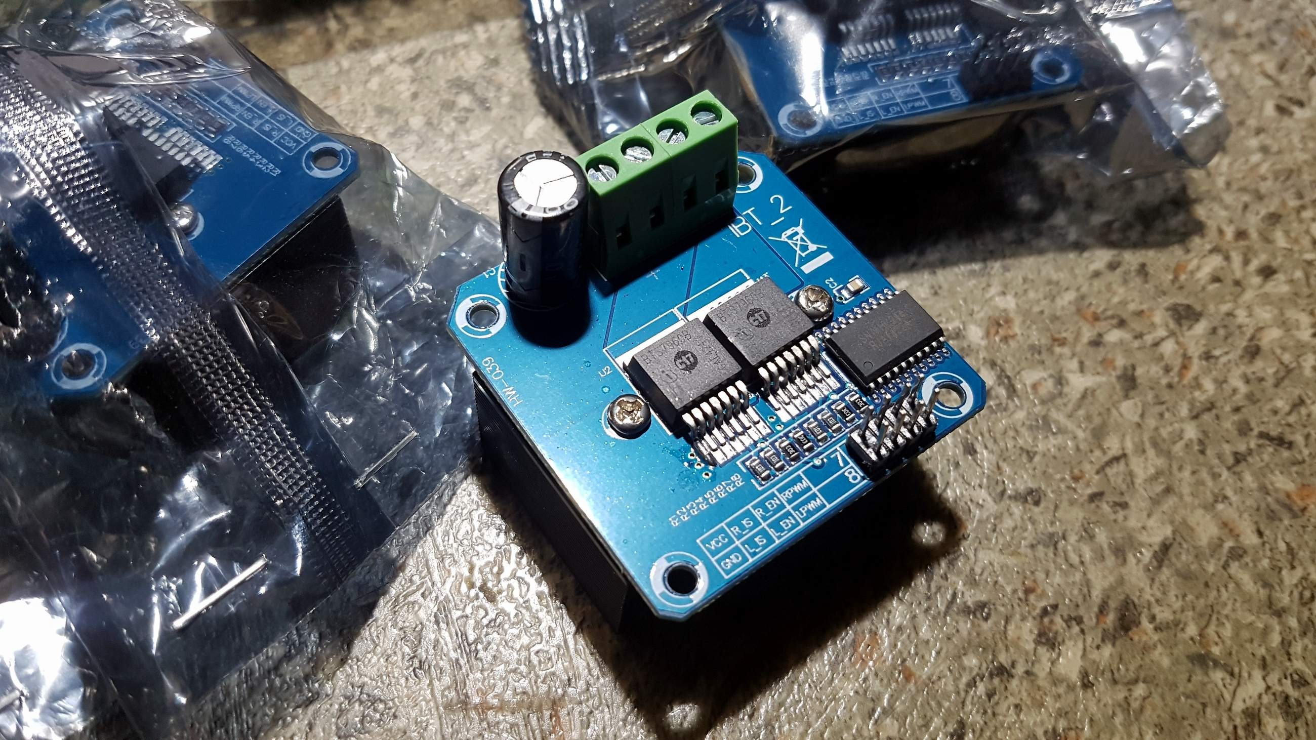

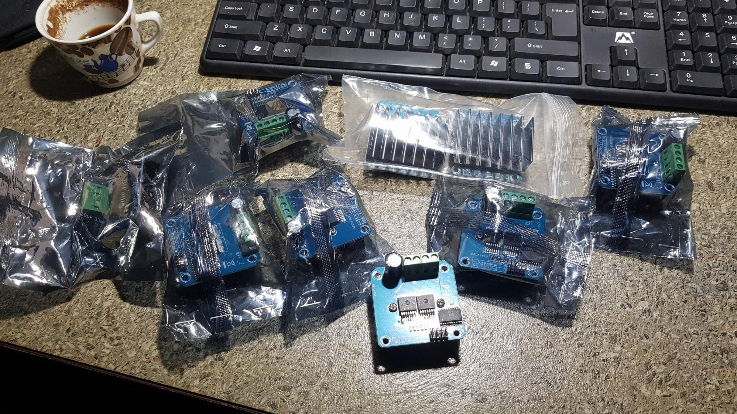

                            • Ok, this is not directly related to the topic, but if I don't write here now; I will forget later!
                              I have a "crazy" idea. How about using a finished H-Bridge module instead of the proposed TX stage?
                              (of course, only one clock and possible reordering of samples will be needed).
                              This is an idea for "megalomaniacs"!
                              The module is based on BTS7960B. The specs are fantastic!
                              - High peak current capability of min. 33 A
                              - Path resistance of typ. 16 mΩ@ 25°C
                              - Low quiescent current of typ. 7 µA @ 25°C
                              - PWM capability of up to 25 kHz with active freewheeling
                              - Switched mode current limitation for reduced power dissipation in overcurrent
                              - Status flag diagnosis with current sense capability
                              - Overtemperature shut down with latch behaviour
                              - Overvoltage and undervoltage shut down
                              - Driver circuit with logic level inputs
                              - Adjustable slew rates for optimized EMI
                              How about that ha!

                              • A short answer for PI, it will not work. There are always output protection diodes on motor controllers. These connect between the coil connections and power supply rails. These will divert the flyback energy to the power supply. For a continuous wave detector vlf or bbs it may work
