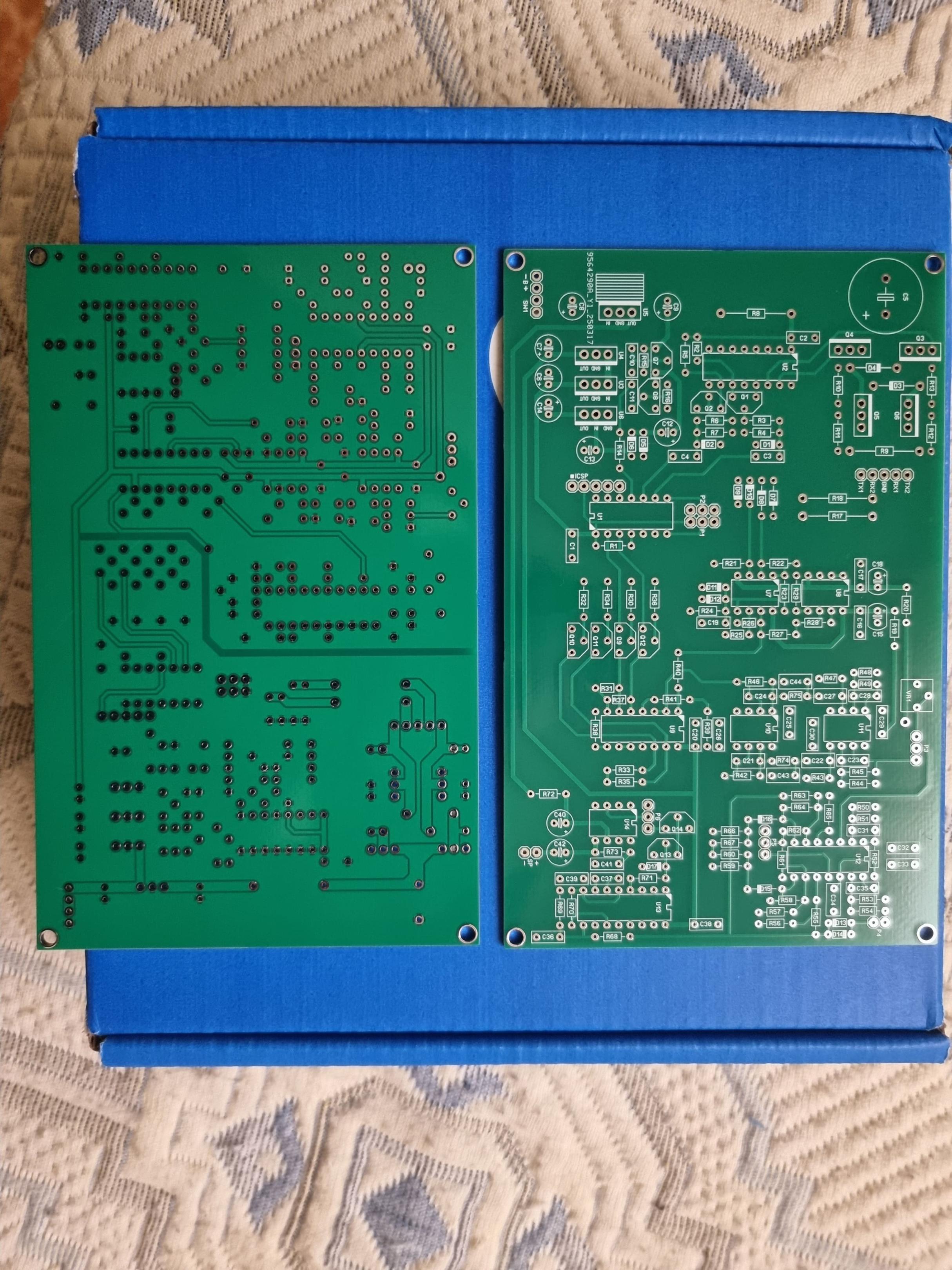

    • The PCBs have finally arrived!

      • Before I start soldering the components; Carl, do you have any corrections or suggestions in the meantime?

          Mine also arrived after 10 days.

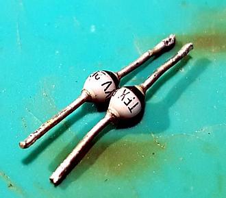

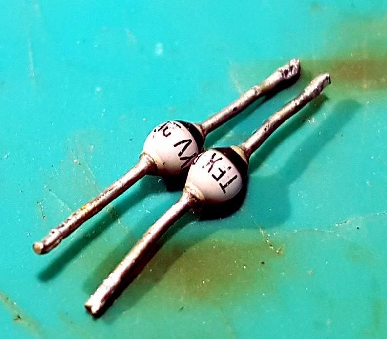

              I find it easier to find BYV26C instead of STTH1L06 in my inventory.
              Is that ok?​

              • .................................................. ......................BYV26C.......... STTH1L06
                Voltage (V_RRM)...................................... 600V............... 600V
                Current (I_F) .............................................1A... .................. 1A
                Forward Voltage (V_F @ 1A) ...............~1.7V...............~1.7V
                Reverse Recovery Time (t_rr) .............≤50ns.............. ≤30ns

                  • I find it easier to find BYV26C instead of STTH1L06 in my inventory.
                    Is that ok?​
                    • Use whatever you want, as long as it has the voltage & current rating. Different diodes can also give different flyback speeds, the STTH1L06 is decent but there are better.

                              Hi Eduardo, will you post the layout of your board? I would also order your version on my next order. I am currently waiting for Carl's original to arrive, but probably next week. Thanks.
                              • Hi Algan.
                                I don't mind sharing my PCB design, but please note that my design is still untested. My PCBs arrived yesterday, and I haven't had time to assemble any electronic components. I think it would be a good idea to wait a bit until I test a PCB and make sure everything is working correctly and that there are no design errors. Keep in mind that my design has many modifications compared to the original. I don't like posting something on the forum that I'm not sure will work or not.
