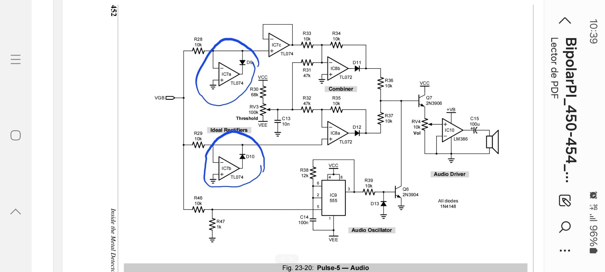

        Hello Carl.
        After looking at the schematic a bit, I realized that there may be a design error in the two rectifiers.
        I have marked them with blue circles in the schematic.
        This is my humble opinion, and I hope you don't get upset.
        Best regards,
        Eduardo.
        • #64
          They look correct. The upper one clamps positive swings, the lower one clamps negative swings.
          • #65
            Okay Carl. Thanks for the clarification. I thought I needed to add a 10k resistor in each rectifier between the anode of the diode and the inverting input of the operational amplifier.
            • #66
              There are ways to improve the ideal diodes, for example, preventing saturation when they are not clamping. I chose to let them saturate because this is not a very fast application. In general, the circuits throughout the book are for teaching concepts so I tried to keep them as simple as possible. They are starting points, not final destinations.

                  • #69
                    The voltages on negative inputs of IC7a and IC7b have to be zero and no chance to be amplified further.
