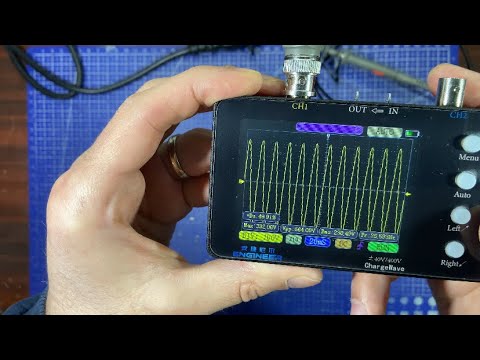

      New toy, arrived yesterday:
      What model of USB oscilloscope is it?
      • https://www.aliexpress.com/item/1005...Cquery_from%3A
