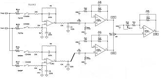

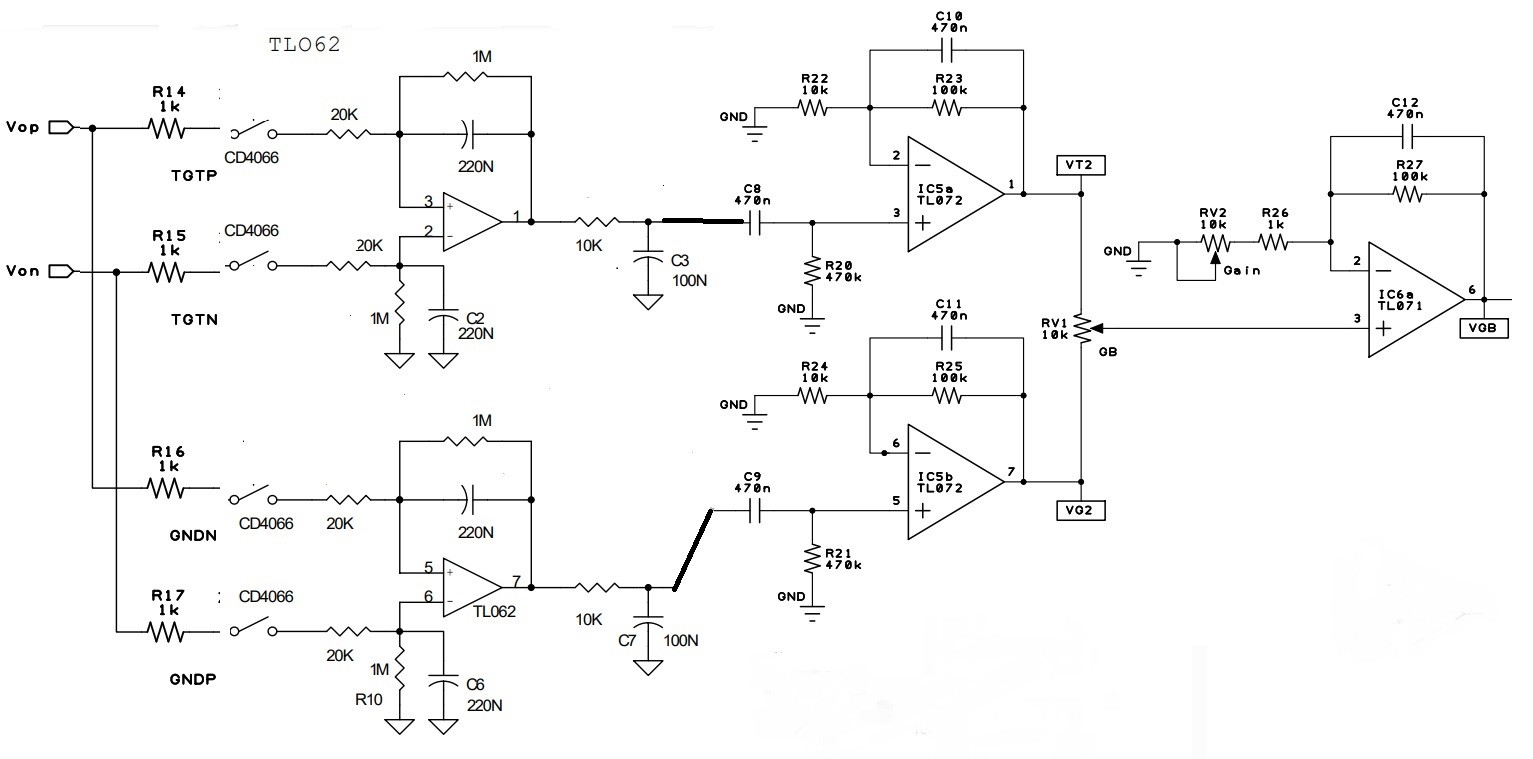

ID:	434934 Hello, Carl, I will also try correcting the circuit with the CD4066, after which I copied the TL062 integral from the TDI circuit, and continued with your circuit, and from there I will continue with the TDI sound. There is also a potentiometer for thrash, what is your advice? Thank you.
      • See Eduardo's schematic, I think his threshold method will work.

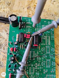

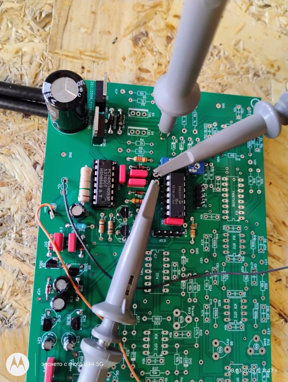

          I'm about to order pcbs from JLPcb.
          Click image for larger version  Name:	20250307_110917.jpg Views:	0 Size:	661.8 KB ID:	434947Click image for larger version  Name:	20250307_110946.jpg Views:	0 Size:	530.1 KB ID:	434948
          Click image for larger version  Name:	20250307_110950.jpg Views:	0 Size:	292.5 KB ID:	434949Click image for larger version  Name:	20250307_111124.jpg Views:	0 Size:	603.9 KB ID:	434950

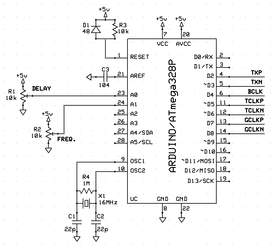

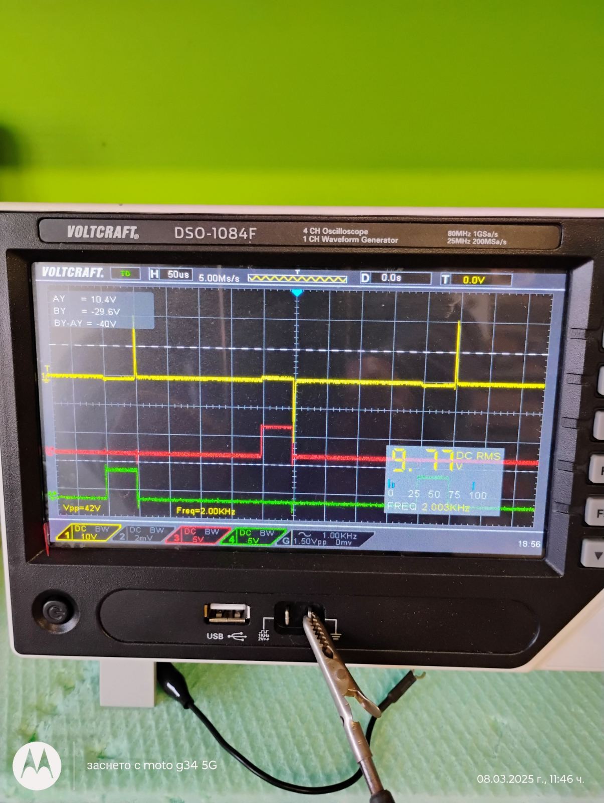

                    • Ok, until I get the pcbs from JLPCB, no reason not to try porting the code.
                      In the previous attempt, I did some things badly.
                      Now I already have a working version.
                      All that remains is to precisely set the time.
                      The matter is more complicated because a potentiometer was also introduced to adjust the frequency.
                      The code works. But it's still not tweaked to run the H-Bridge safely without risk.
                      The main problem I have is the lack of a multi-channel oscilloscope (the 10k and pulse merging trick doesn't work very well, due to overlapping critical times).
                      Currently, the frequency can be adjusted from 600Hz to 3kHz. But any change in frequency will affect the timing.
                      (Perhaps introducing frequency change was a bad idea but it is a tempting challenge)
                      It is recommended to test the code on the Arduino UNO platform without the rest of the hardware.
                      Colleagues who have multi-channel oscilloscopes; can help a lot here!

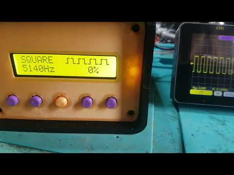

                        • New toy, arrived yesterday:
                          • I assume the "hiccup" on the oscillogram is due to the USB power supply.
                            I didn't feel like checking because it's good enough as it is.
                            • While I wait for the pcbs to arrive...
                              • Zero percent's of what? The software some times gives slightly strange massages at first view.
