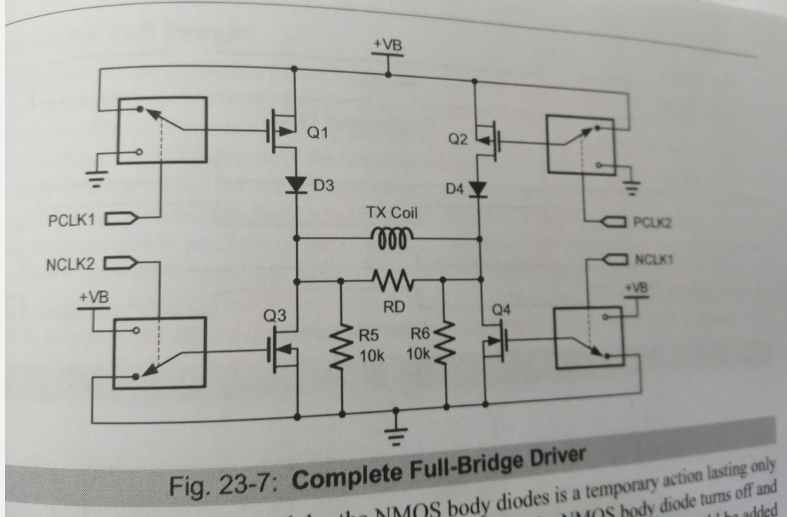

    Fig 23-11 only applies to the differential coil driver (Fig 23-10), not the H-bridge driver. The H-bridge driver produces flyback only in one direction.

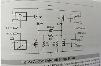

          Originally from the book Bipolar PI TX looks like this:
          Click image for larger version  Name:	BiPolar PI a.jpg Views:	553 Size:	228.9 KB ID:	432528​​

                          • between TXP turning off and TXN turning on.
                            The MOSFETs (IRF9640 and IRF740) specification shows that the P-channel MOSFET turns off a little slower (~100ns), while the N-channel turns off faster (~80ns).
                            Suggestion: We can increase the dead time to 1-2µs to make sure there is no overlap.
                            TXP and TXN switching order
                            We need to make sure that first TXP (the P-channel MOSFET) turns off, wait for the dead time, then TXN (the N-channel MOSFET) turns on.
                            The same applies when switching from TXN back to TXP.​
                            void generatePulse() {
                            PORTB |= (1 << PB1); // TXP HIGH (P-channel MOSFET on)
                            PORTB &= ~(1 << PB2); // TXN LOW (N-channel MOSFET off)
                            delayMicroseconds(TX_WIDTH); // TX pulse width
                            PORTB &= ~(1 << PB1); // TXP LOW (turn off P-channel first)
                            delayMicroseconds(2); // DEAD TIME (~2 µs) - increased for safety
                            PORTB |= (1 << PB2); // TXN HIGH (turn on N-channel MOSFET)
                            PORTB &= ~(1 << PB2); // TXN LOW (turn off N-channel MOSFET)
                            delayMicroseconds(2); // DEAD TIME (~2 µs) before next cycle

                              gpz7k run tx with irfi 4227, there's a reason for this right?
                                If we're talking about the circuit in Fig 22-18 (post 169) then the NMOS switches are self-driven. TXP & TXN refer to the positive and negative TX pulses, not the PMOS and NMOS switches.
