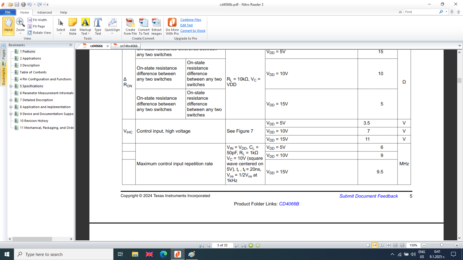

    If the micro is powered from ground to negative rail... and the negative rail is "generated" via charge pump controlled by micro....!???
    How about that!?!
    This is no longer valid.

      About 4066 I'm not sure...

            As I said before, I need a few days to thoroughly go through this. Apparently what happened is that I built a first PCB proto of the circuit (derived from the PI-GB circuit) and found some problems with it. I made corrections to the circuit but then forgot to transcribe those changes to the book schematic, and also never ordered a final PCB to double-check the design. It was an oversight, which I blame on the fact that the PI section was some of the earliest material I "completed" and just forgot about the state of this circuit.
            Anyway, here is a partial list of the issues:
            • The micro must be powered from VCC and GND, not GND and VEE.
            • The sampling switches should be 74HCT4316, not 4066 (HC might work, I don't have any to test).
            • If you use a 4053 for IC1, use the 74HCT variety.
            • I need to add an input limiter to the 555 VCO.
            I say partial because I'm not done yet. And, yes, Q1,Q2 can be any PMOS, I used the 9630 because it is common and cheap.
            Edit: the 74HCT4053 has a max supply of 10V so it won't work at 12V. And the CD4053 (max 20V) needs a 70% VIH drive, or 8.4V @ 12V. So this will likely need an additional translator.

                • The micro must be powered from VCC and GND, not GND and VEE. _______________________________________________cor rected in post #25
                • The sampling switches should be 74HCT4316, not 4066 (HC might work, I don't have any to test).____________________________corrected in post #25
                • If you use a 4053 for IC1, use the 74HCT variety.__________________________________________ ___________________ no comment
                • I need to add an input limiter to the 555 VCO.______________________________________________ ________________waiting to be done
                ... And, yes, Q1,Q2 can be any PMOS, I used the 9630 because it is common and cheap.________________________________Detectorist#1's post #27 is probably the better choice
