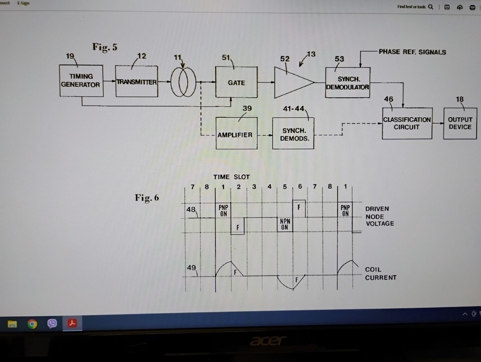

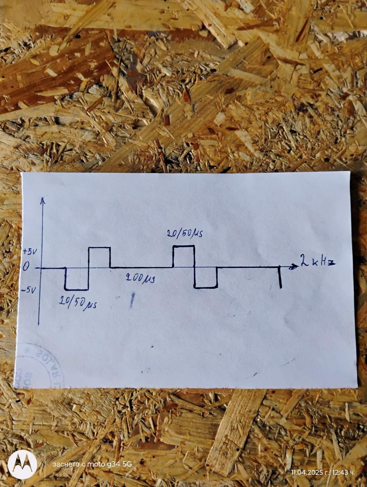

              • Hello Carl-NC
                How can we program a time slot?
                How can we build this type - time slot?
                I tried but I can't do it.

                • Are you wanting to create a half-sine TX, or the Fisher Impulse TX? They are done differently.
                    Hello Carl-NC
                    Yes, but I don't know how this happens.
                    I would be very happy if you could draw a schematic.

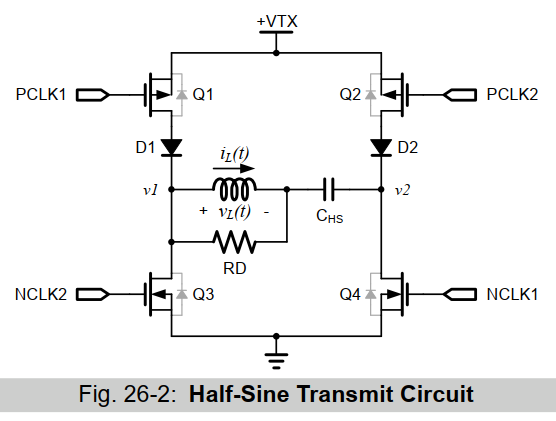

                    • The half-sine is shown in Ch 26, you literally just add a series cap to the coil:

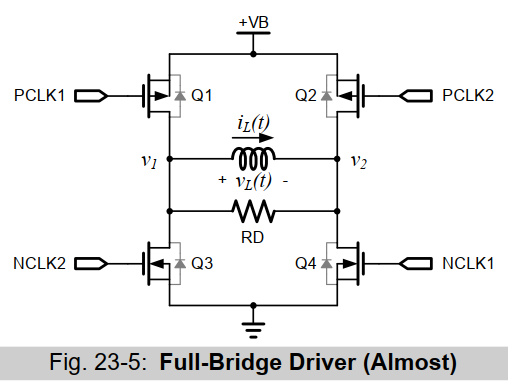

                      The Impulse TX requires shorting D1 & D2 so that flybacks are suppressed:
                      ​Click image for larger version

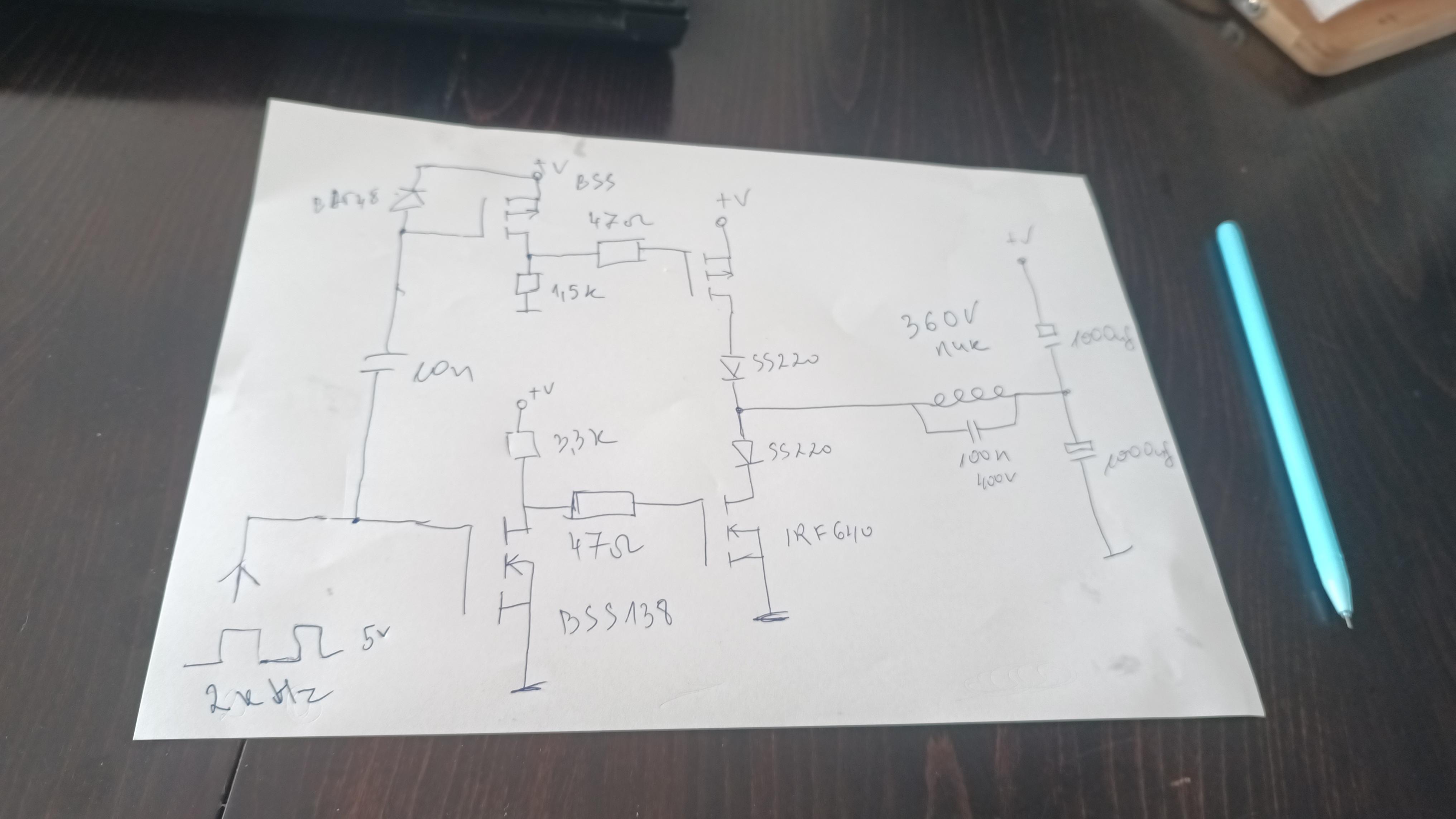

                      • Hello Carl-NC
                        Thanks for the clarification.
                        What do we feed to the points?
                        What kind of impulse?
                        NCLK1
                        PCLK1
                        NCLK2
                        PCLK2

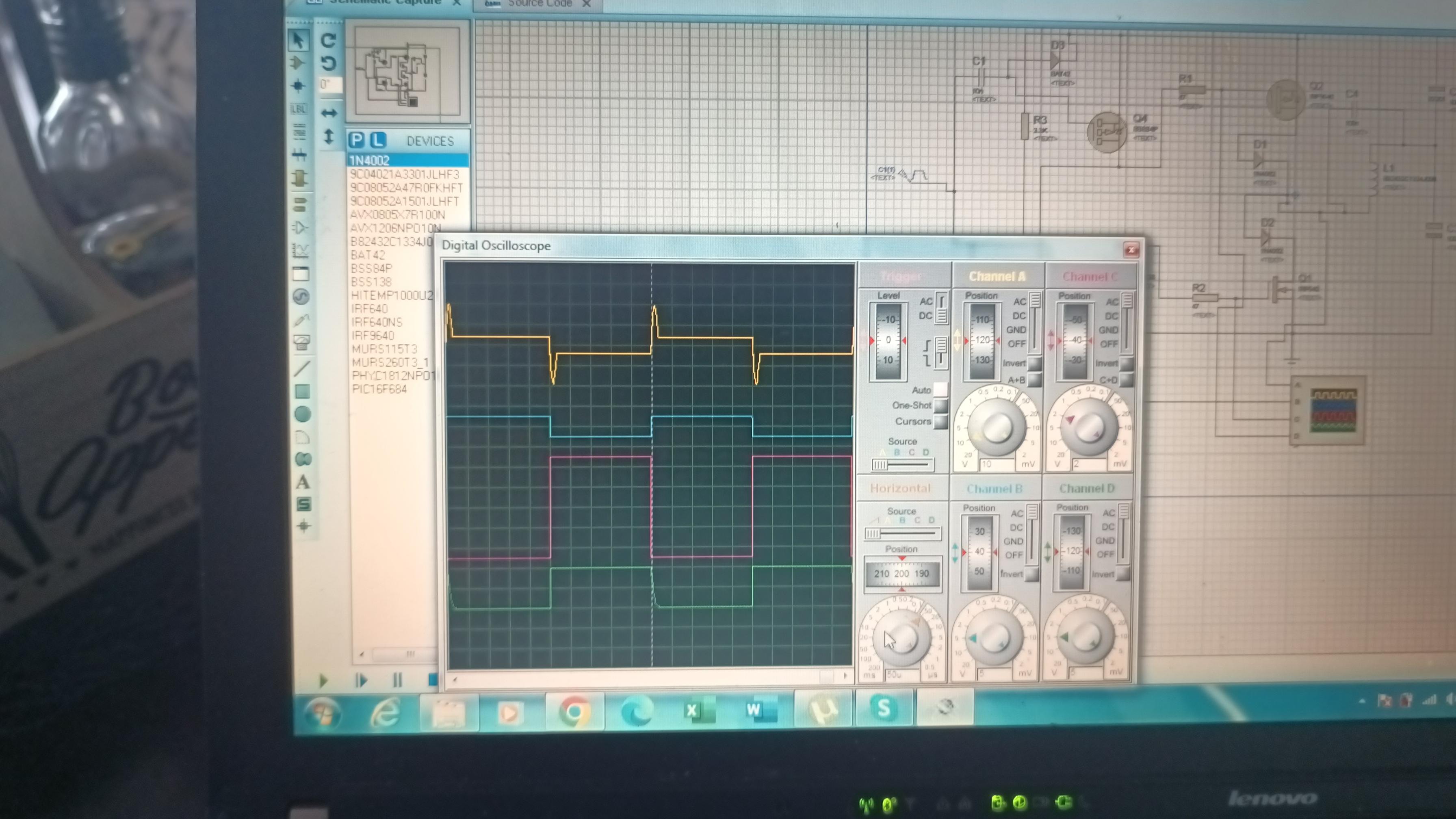

                        • Mikron hibryd generator
                          • Hello NASCO
                            Is this your stimulator?
                            • Yes ,I use Proteus
                              • Hello Nasko, wouldn't it be better to use a mosfet driver from the TC4426/TC4427/TC4428 series instead of bss138 and bss84r? In this case, the signal from the chip should be low and high.
