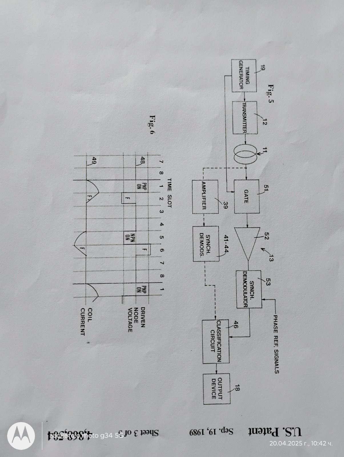

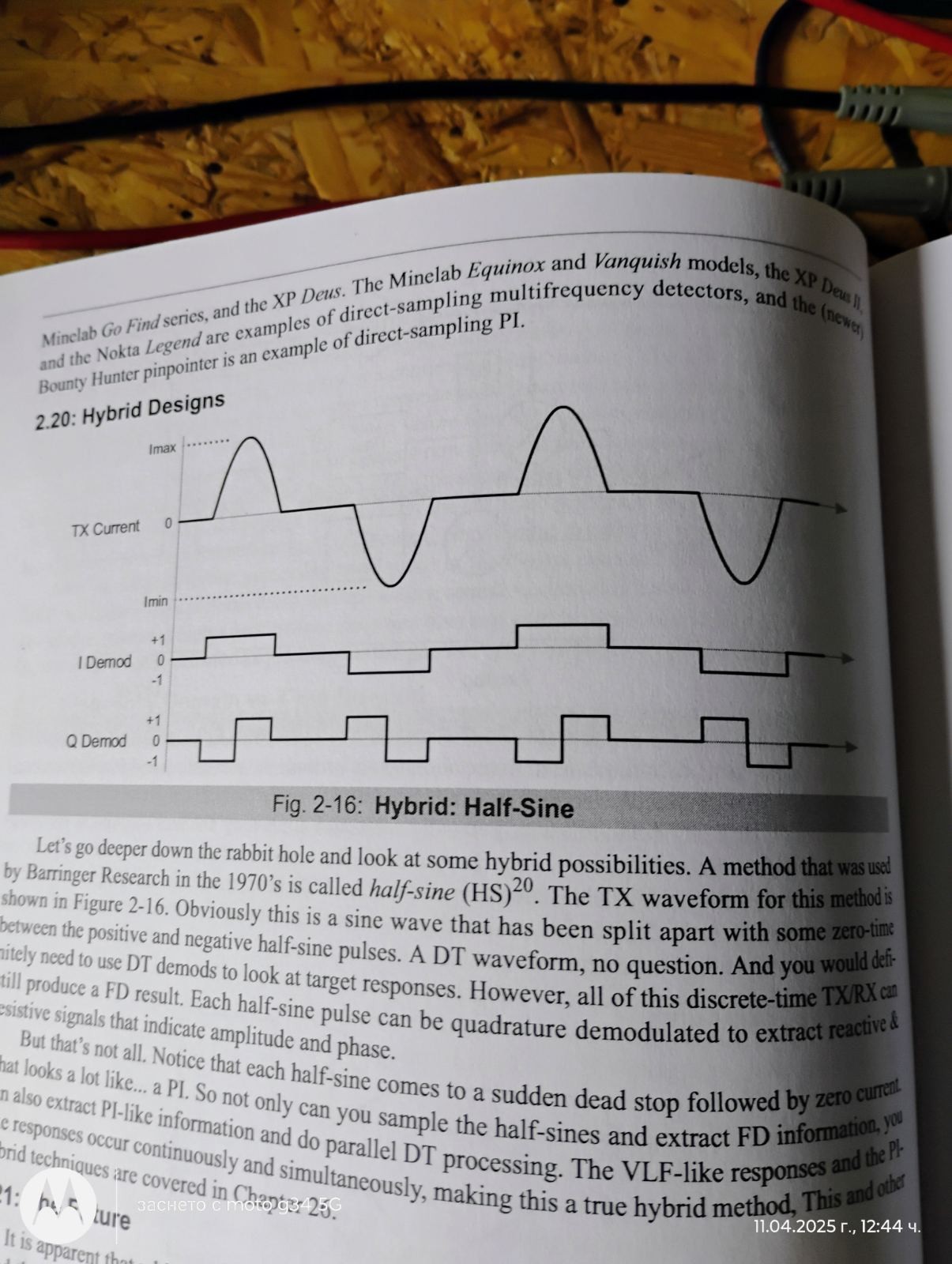

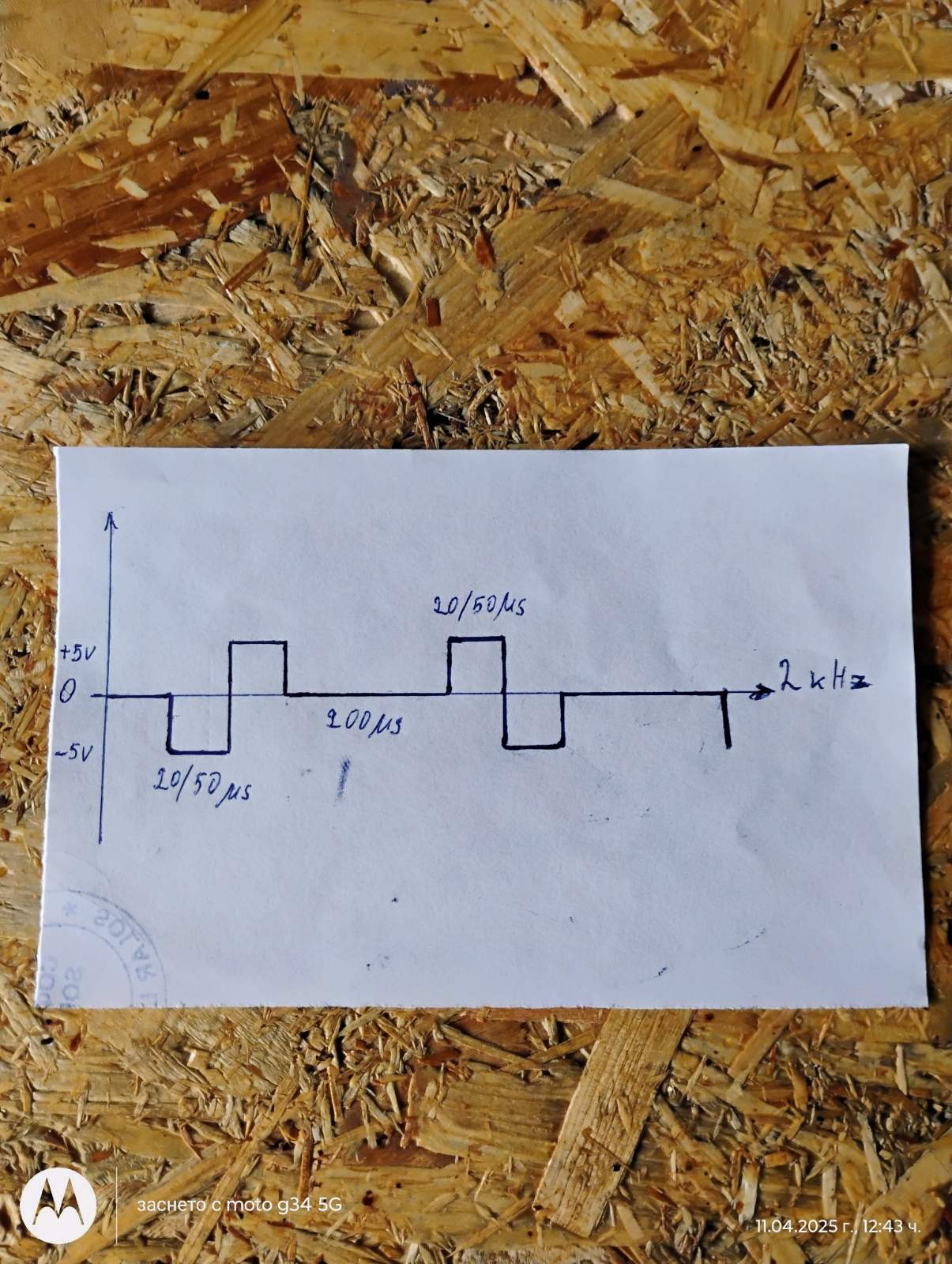

            • Hello Altra
              How can we program a time slot?
              How can we build this type - time slot?
              ​Is there any way to do this?

              • In your three photos. I think you are confusing the Tx and demodulation signals. Carl's drawing shows the demodulators sampling during the halfsine. The I sample is taken during the complete HS period and the Q sample is inverted for the first 90 deg of the HS and alternated between pulses. In the hand drawing and Johnson patent those are the Tx signals and not the demodulators. To make all this happen you need to concentrate on programming micro processors and learn how to generate the timing signals. Carl's book has all the info you need for the rest. I use the IRF640, IXTP26P20 and a TC4428 driver for the TX. The IXTP26P20 is expensive and the ones from China are fake
                  Hello Altra
                  Exactly about Johnson's patent - I want to build his Tx signals.
                  Not for demodulators.
                  Thanks for the encouragement.
                  Google doesn't translate correctly.

                    • Originally posted by pechkata View Post
                      Hello Carl-NC
                      Thanks for the clarification.
                      What do we feed to the points?
                      What kind of impulse?
                      NCLK1
                      PCLK1
                      NCLK2
                      PCLK2
                      For the half-sine the TX clocks are identical to the bipolar PI:
                      For the Impulse waveform the TX clocks are this:
