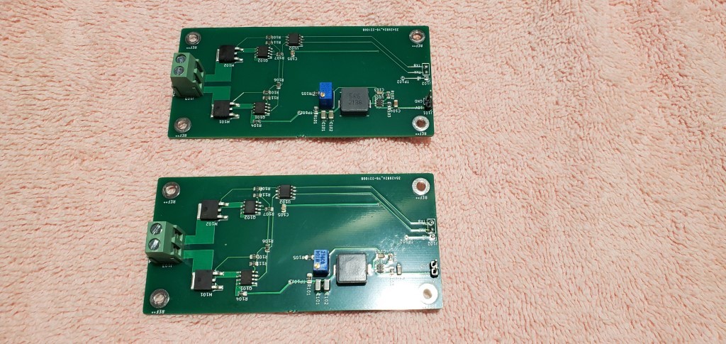

        Do you already have a PCB for that?
        Yes, I have an evaluation PCB that I have been using for a couple of months.
Name:	Moodz test brd (Custom).jpg

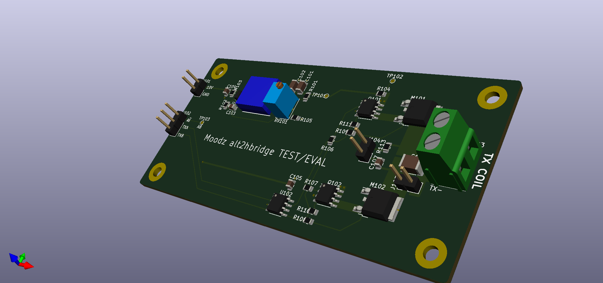

        I have an upgraded version that should arrive 30 Jan. The new version arriving on the 30th has onboard provisions to configure as CC or half sine using 2 jumpers.
        With both of these evaluation boards versions the TX voltage is adjusted by a trimpot. In a final design this would be replaced by a 100K digipot (I2C).

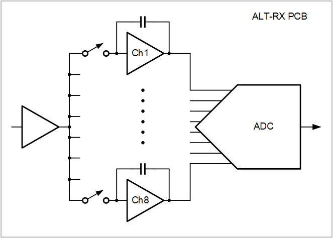

          I always look for ways to hedge my bets, so I would also consider a secondary analog sampling PCB:
          Click image for larger version  Name:	image.png Views:	71 Size:	15.2 KB ID:	409388​
          This could pick off the main board preamp signal and has 8 full-wave demod channels. Normally each demod requires 2 clock lines (16 total) but with glue logic you can get it down to 8 clocks + 1 control line (9 total). Two of these boards could be stacked if you need 16 channels.
          The ADC is simultaneous sampling 16-24 bits. My experience is with the ADS131E08 (8x24b) but its restrictive sample rate range makes it tough to synchronize. I would look for something easier.

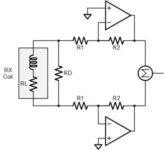

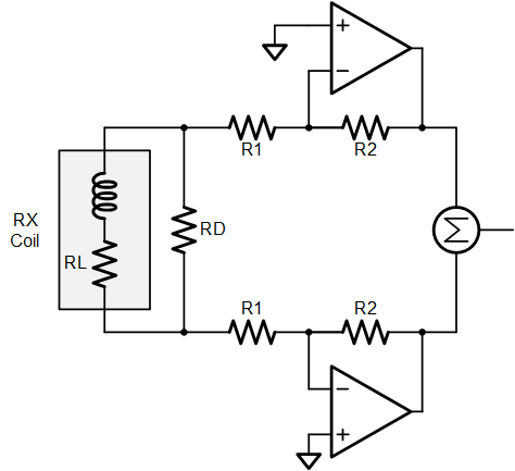

                            Here is a first-cut at noise analysis. I will use a simplified version of Tony's front-end schematic:
                            Click image for larger version  Name:	image.png Views:	0 Size:	17.2 KB ID:	409468​

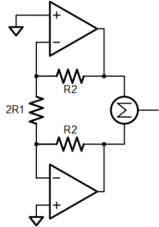

                            To makes things easier I will ignore RL and combine the R1's:
                            ​Click image for larger version  Name:	image.png Views:	0 Size:	9.5 KB ID:	409469​
                            Considering just one opamp, the noise due to the input resistance is
                            R1=2k and R2=10k so
                            The feedback resistor R2 (10k) has a noise that is
                            The opamp (ADA4807) has an input referred voltage noise of 3.1nV/rtHz and its noise gain is (5+1):
                            The opamp current noise is 10pA/rtHz but splits between R2 in one opamp and 2R1+R2 in the other opamp. This means that most of the current noise is common-moded at the outputs. The difference is
                            Now we take the squareroot-sum-of-squares to get the total noise. However, this is a differential amp so each vnx term shows up at each output. For an uncorrelated term we can just multiply by sqrt(2) but in the case of vn1 the noises are correlated between the two opamps so it needs to be doubled. So the total differential noise is
                            This is applied to a difference amp with a gain of 5 so its output noise is 284.2nV/rtHz.
                            Now we need the noise bandwidth. If we assume we want to respond to a 0.25us target then we need a bandwidth of
                            Assuming a 1-pole roll-off gives us a NBW multiplier of π/2, or NBW = 1MHz.
                            The total integrated noise is now
                            Peak-to-peak noise is ~6x this value, or 1.71mV.
                            At the ADC input this is 586.5 codes per volt, so a 5V full-scale input would need 2932 codes, or 12 bits. Or, to put another way, for a 16 bit converter @ 5V we have about 22 LSBs of noise. This is not good. I'll stop for now to review these numbers to see if I did something wrong.

                            • #44
                              I haven't seen any glaring problems with the last post so I'll continue using my current mode approach. Now the input resistance is RL instead of 2R1. For RL I will arbitrarily use 20Ω and to keep the gain the same as before R2 is now 100Ω
                              The feedback resistor R2 (100) has a noise that is
                              The opamp noise has not changed:
                              The opamp current noise still splits with the same ratio:
                              Same correlation as before so the total differential noise is
                              This is applied to a difference amp with a gain of 5 so its output noise is 135.0nV/rtHz.
                              NBW is the same as before so the total integrated noise is now 135uV rms or 809.7uvpp. This is 1235 codes per volt so a 5V full-scale input would need 6175 codes, or 13 bits. Or for a 16 bit converter @ 5V we have about 11 LSBs of noise. This is a little better than before.
                              By using a low input resistance all the noise terms have been reduced but the opamp noise now dominates. A 1nV/rtHz opamp will knock the vn3 term down to 6nV/rtHz and the overall noise down to 52.1nV/rtHz or 52.1uV rms or 312.6uvpp. This is 4.1 LSBs of noise @ 16 bits which is starting to look pretty decent.
                              It's looking like a 24b converter is massive overkill and a good 16b ADC will do the job. I may use 18b just to hedge my bets. This will reduce the ADC cost by $20-30.
