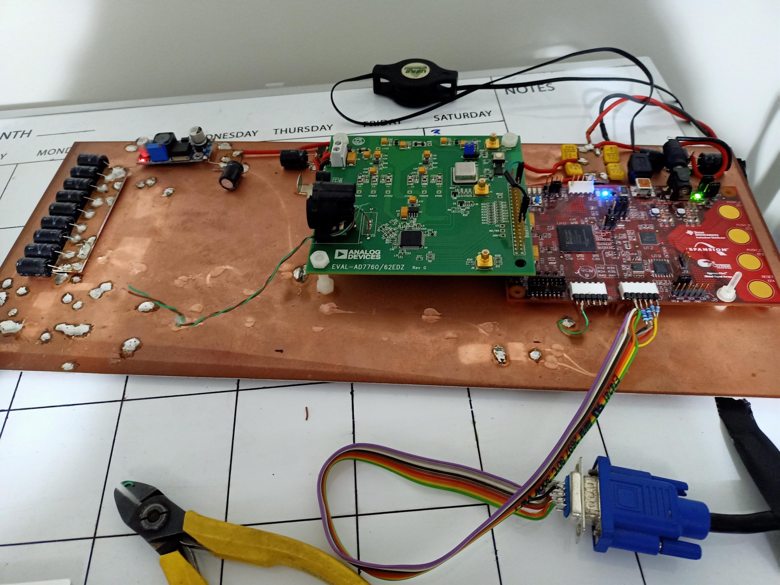

      yeh the boards I am using just plug together .. no soldering .. pure luck as they came from different sources and the FPGA pins are remappable as you know but the FPGA board is a bit dated now. The Artix or similiar would be the go nowadays.
      I am not doing much DSP ... the code is set up as a 24 bit oscilloscope .. vga output from the FPGA ... It was setup for a pulse induction detector so it samples the decay waveform ... averages it and displays on the VGA.

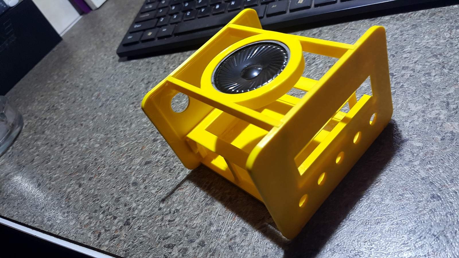

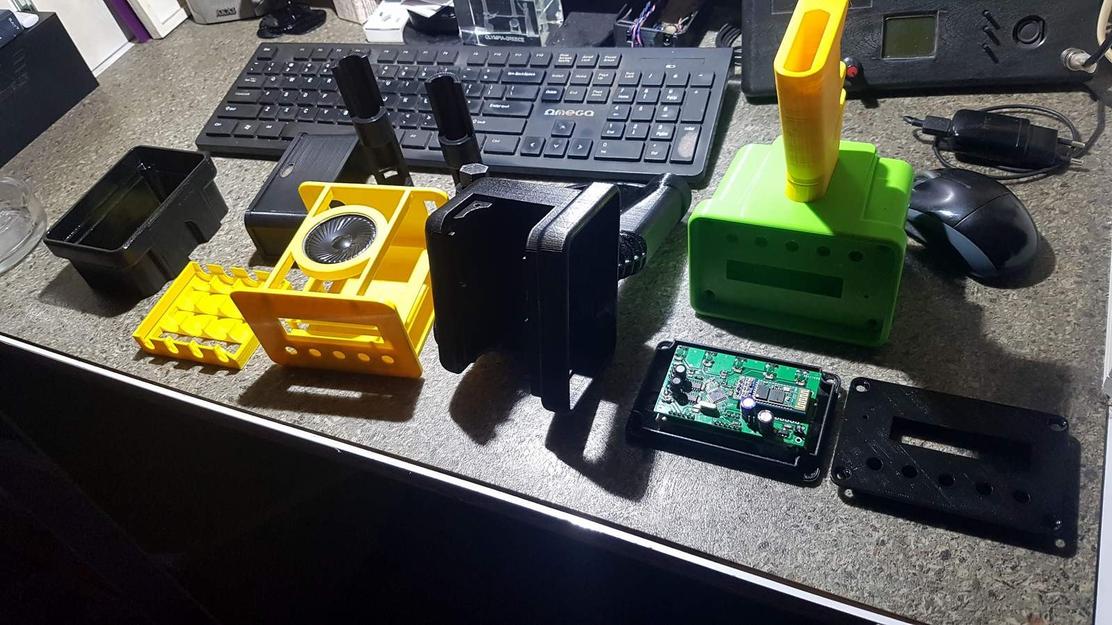

          The way I see a team working together, is that each one applies his knowledge to the part of the project where he has something to offer. Not everyone of the team members needs to be a programming expert. There are many parts of the detector that need to be designed.
          For example: the detector needs to be extremely rugged and yet ergonomic. Do you have any ideas on that?
          By adding the strength of every team member we can find the solutions, not by everybody trying to repeat what the others do.
          • Originally posted by Tinkerer View Post
            In order to follow the topic; I usually need correct and complete schematic, let me repeat again: drawn exclusively in any conventional schematic capture software, pick anyone that suits you.
            Rugger and ergonomic? Ok. First I have to see schematic, then we have to draw pcb(s) for it. And just then; when we know the volumes of pcb, positions of which goes where: I could anticipate the enclosure.
            I am talking this from ongoing experience, since 2018. till this very moment (just caught me doing it) in "putting the pieces together". One leads to antother. In order to get enclosure; first I draw pcb. While drawing pcb; all the time I keep in my mind all the next
            steps I 'll have to do; drawing 3D enclosure and parts (usually it is not one volumen but several parts later put together). While drawing 3D parts; all the time I have to keep in my mind all the peculiarities, features and specifics related to 3D printing.
            Looong story! Vicious circle, one leads to another, one depends on the other... I've been doing numerous devices like that since 2018. From the "ground zero" to finished product.
            But everything has its strict order.
            A house is not built starting from the roof, but starting from the foundation... if you understand what I mean.
            So let's go step by step.
            Schematic first.
            Later goes other steps...

              • Just caught me doing it... literally every day I spent several hours on drawing parts, 3D printing... adapting for some pcb and more often drawing pcb first but keeping in mind what comes later, trying to optimise both to match each other and not to make tradeoffs on eiter sides at all.
                One man band. Unfortunatelly not a team player.
                So I must have all from docs infront of me... or I will not start working on it at all.
                What you see on photos above is just 1/1000 of my works so far.
                Those are ones I am finishing these days.

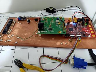

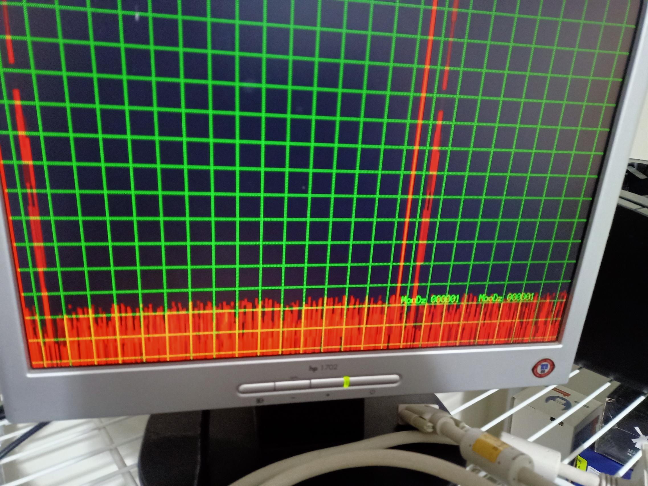

                          • ..so I dug my old HDL code for the AD7760 and combined with a FPGA based VGA waveform code block it compiled OK and loaded into the board is mostly working :-)
                            The FPGA can generate VGA signals with just a few resistors. So I basically have a 24 bit sampling programmable realtime CRO at 2.5 SMPS.
                            The ADC inputs are not connected to anything so waving my hand near them (5 cm ) lifts the noise floor considerably. This indicates that though there is no gain on the input ... 24 bits is very sensitive.
                            Happy to post the code if anyone wants it ( very alpha needs more work though it is getting 24 bit data from the AD7760 into the FPGA and that is the main thing ).
                            Obviously can sync the TX by generating output sigs from the FPGA.

                                Connecting modules, evaluation and development boards will be complicated, with many wires.
                                And it will look just like your photos!
                                TC of 1uS... with such "mesh" of wires and cables... well...
                                Will we even have a real insight into how the assembly behaves, in such conditions?
