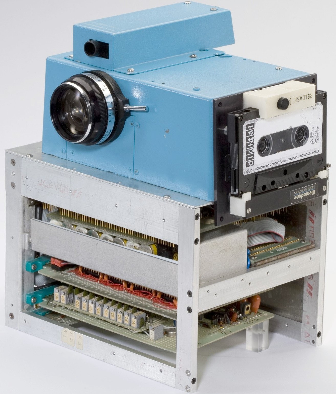

          • ..below is the first Kodak digital camera prototype. Nowadays you can buy a single chip camera.
            It does not matter what size or chips the first prototype uses ... so long as the POC ( proof of concept ) demonstrates the desired features then like natural selection in nature the fittest will survive ( and evolve ).
            For those who dont have 24/18/16 bit ADCs with powerful CPU attached ... it would / will be great to have a 24/18/16 bit board general purpose board that could sit at the heart of this project and maybe others.
            I am using FPGA and AD7760 because I have them to hand .... but the step of creating / selecting a 24 bit ADC/CPU is only a step its not the end goal .. so I am starting to move to the next step which is assembling an AFE and CC RX/TX .. which will ( probably ) not be on a nice PCB either.
            Not really worrried if the POC is the size of a shoebox I have made plenty of really small projects that didnt work properly in my career as well

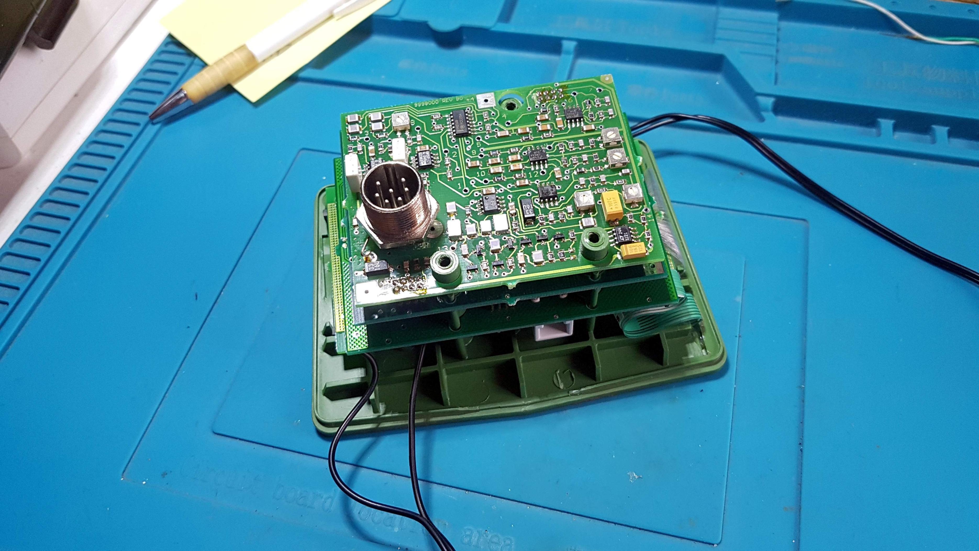

                  Please don't misunderstand, I had no objections to what is seen in your photos, on the contrary; I envy you because you have it and I don't.
                  I was just pointing out that the final "product" needs to be much more compact and will be desirable; on as fewer pcbs as possible.
                  I remembered the Garrett GTI 2500, it's a very nice and well packaged machine.
                  Same as GTI1500:
                  In that manner, we could also plan this detector.

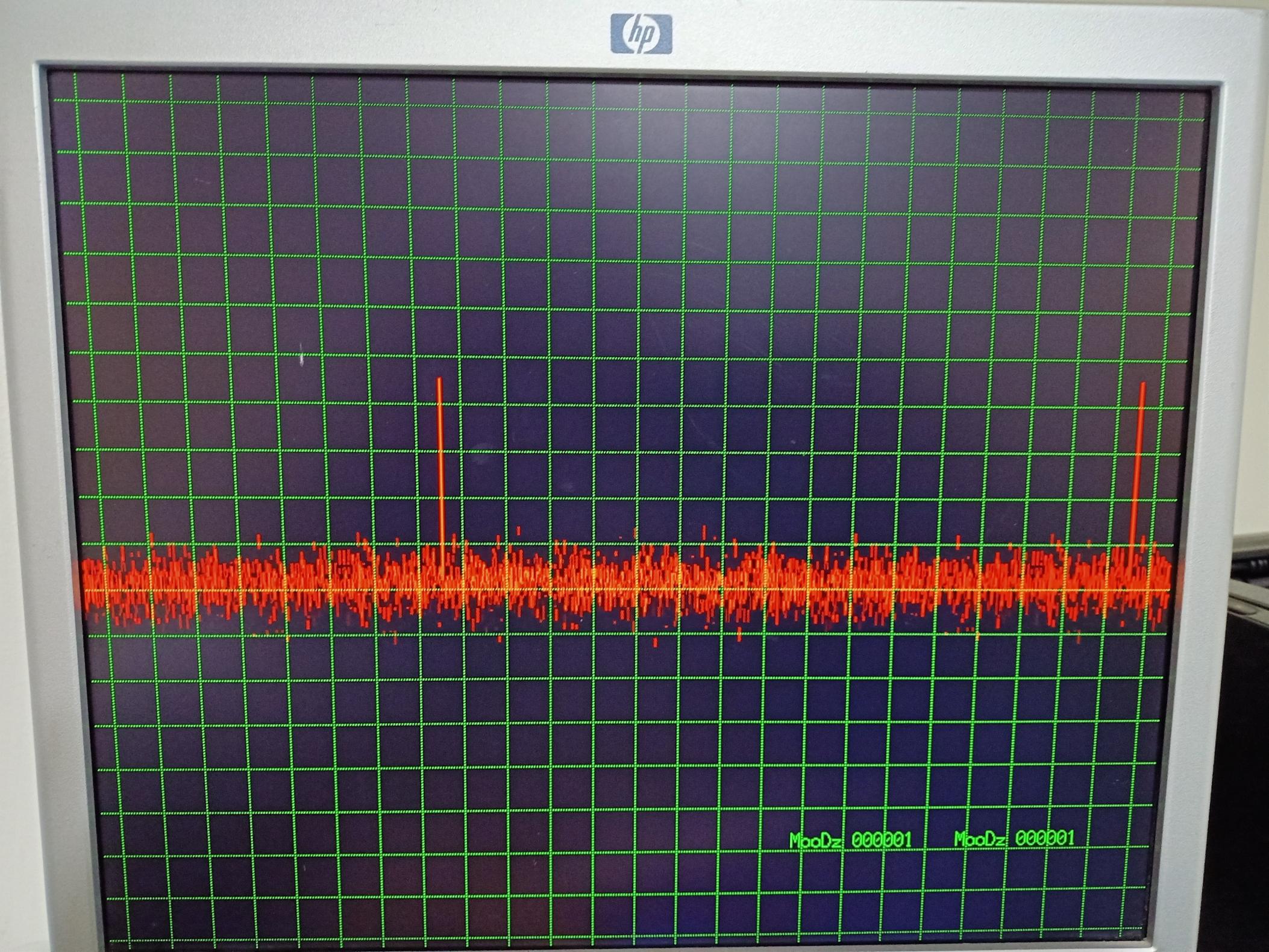

                      Adding to this ... forgot ... because the 4096 oversample is for EACH sample point the noise is further spread over the 512 integration / bin points ... so we get a processing gain ( think of spread spectrum ) of at least 3 bits so the total bit gain is 12 + 3 say to get 15 bit oversampling on 24 bits.
                      The effective sample rate of each integrator is 610 Hz so there is still headroom for more filtering and still have an adequate target response.
                      Here is the open circuit noise on the ADC at maximum resolution. Each pixel is a voltage unit well under a microvolt. It picks up my hand at just on 10 cm from the input connetor with a couple inches of wire ..open circuit.
                      The two red spikes are markers ( I set one of 512 integrators to a fixed value ) and thus the display "wraps around" with 511 integration points between each marker ... The period between the markers is 204.8 microseconds.

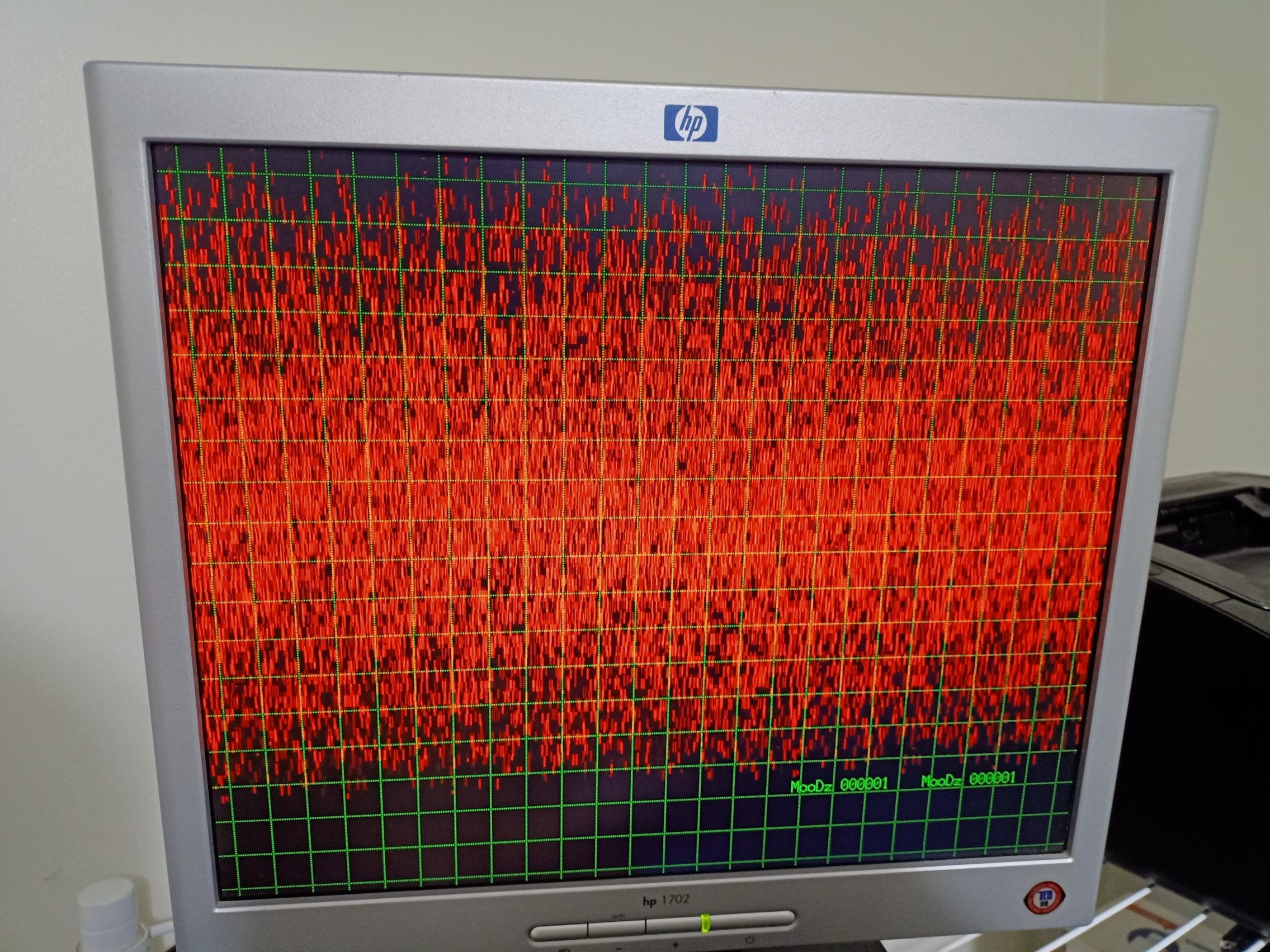

                      Full scale noise ...
                        .... my bad ... the oversampling gain is 6 + 3 = 9 bits not 15 bits. The ADC prob only gets 20 noise free bits on a good day so maybe were getting 20 + 9 = 29 bits of goodness ... still bloody excellent.
