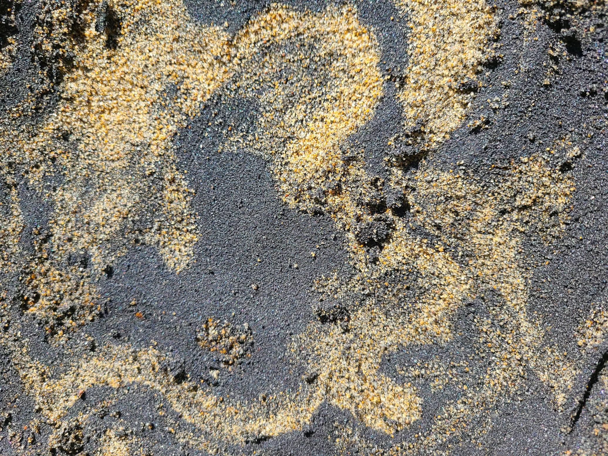

                      I recently found a area where ground balance was almost unusable while testing the vallon detector. The vallon coil could barley cope a smaller coil was able to hunt in Gb mode at way reduced depth.

                      Testing the sand fallen off targets in my pouch with magnet there was 25 % magnetite by weight.
                      Point is Gb didn't work here and I was able to hunt in regular mode.
                      I think anything under 5 us is not going to be usable in the field and 5 would be only in super mild soils not the gold fields around here. Maybe if the gb is super dialed in.
                      but having the ability to sample that low could be a valuable tool looking for small jewelry on a clean milder beach type sand.

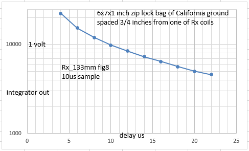

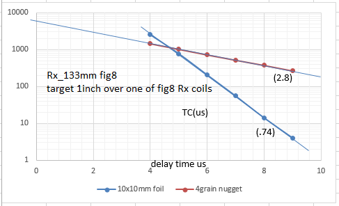

                            I use all four. target sample(N) ground sample(I) then target sample(I) ground sample(N)for EFE
                            Including a decay chart for 10x10mm foil and the 4grain nugget I have tested at 1inch. integrator out vs delay time
                            The 6x7x1 inch zip lock bag of dirt from California saturates the integrator(>2.5V)when positioned over one of the fig8 Rx coils with a 6us delay. 10 on the chart is 1mV

                                Charted ground decay(change in integrator out)vs target delay time, 10us target sample. Can detect a 1 to 2mV change at integrator out on the bench.
