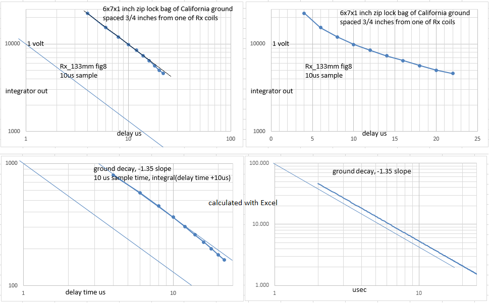

    Charted ground decay(change in integrator out)vs target delay time, 10us target sample. Can detect a 1 to 2mV change at integrator out on the bench.
    Looked at chart log-log this morning. Different slope than I expected. Charted ground decay with Excel, amplifier out and integrator out(delay+10us). Looks similar to what I measured this morning. My math skills are lacking, maybe someone could explain why integrator out decay is a lot slower than amplifier out.
                  Does this represent a "viscous ground"? An initial faster, linear decay and then a slower exponential decay? Or in other words, a short TC and a long TC?

                      • Originally posted by Tinkerer View Post

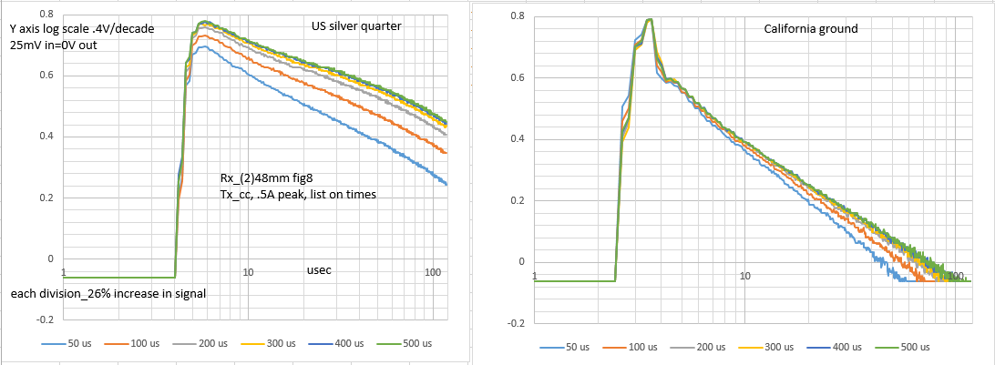

                        I think the ground decay is straight line log-log. Including a recording of the California ground I made with my Target Response Tester, amplifier out. Not perfectly straight, probably do to my tester. The quarter starts out straight line log-log and then finally decays straight line linear log. Can't record enough decades at amplifier out to see if ground finally decays straight line linear log. Recording integrator out for targets<10us TC seems to be close to the same as amplifier out(straight line linear log)Thicker targets and ground don't chart the same at amplifier out and integrator out.

                            https://www.geotech1.com/forums/show...814#post199814 I can adjust target sample time to cancel ground signal from my back yard with GB switched on and the see target as long as it doesn't fall in the hole with my PI. Figure8 Rx coil reduces ground signal and signal from a zip lock bag from back yard is about 1/5 the signal. Figure8 coil can cancel the California bag if positioned between the figure8 Rx coils. Don't know how difficult it would be to keep the signal low enough swinging the coil over the California ground, no problem in the yard with GB on(not usable with GB off). I think 1/5 the signal is still fairly high? Dirt from back yard, almost nothing sticks to magnet.
                            I see the decay chart reply #46 from above thread states Calif ground 80 times Al ground but chart shows over 3 times. Two many stupid pills? I measured 5 times this morning at integrator out.
