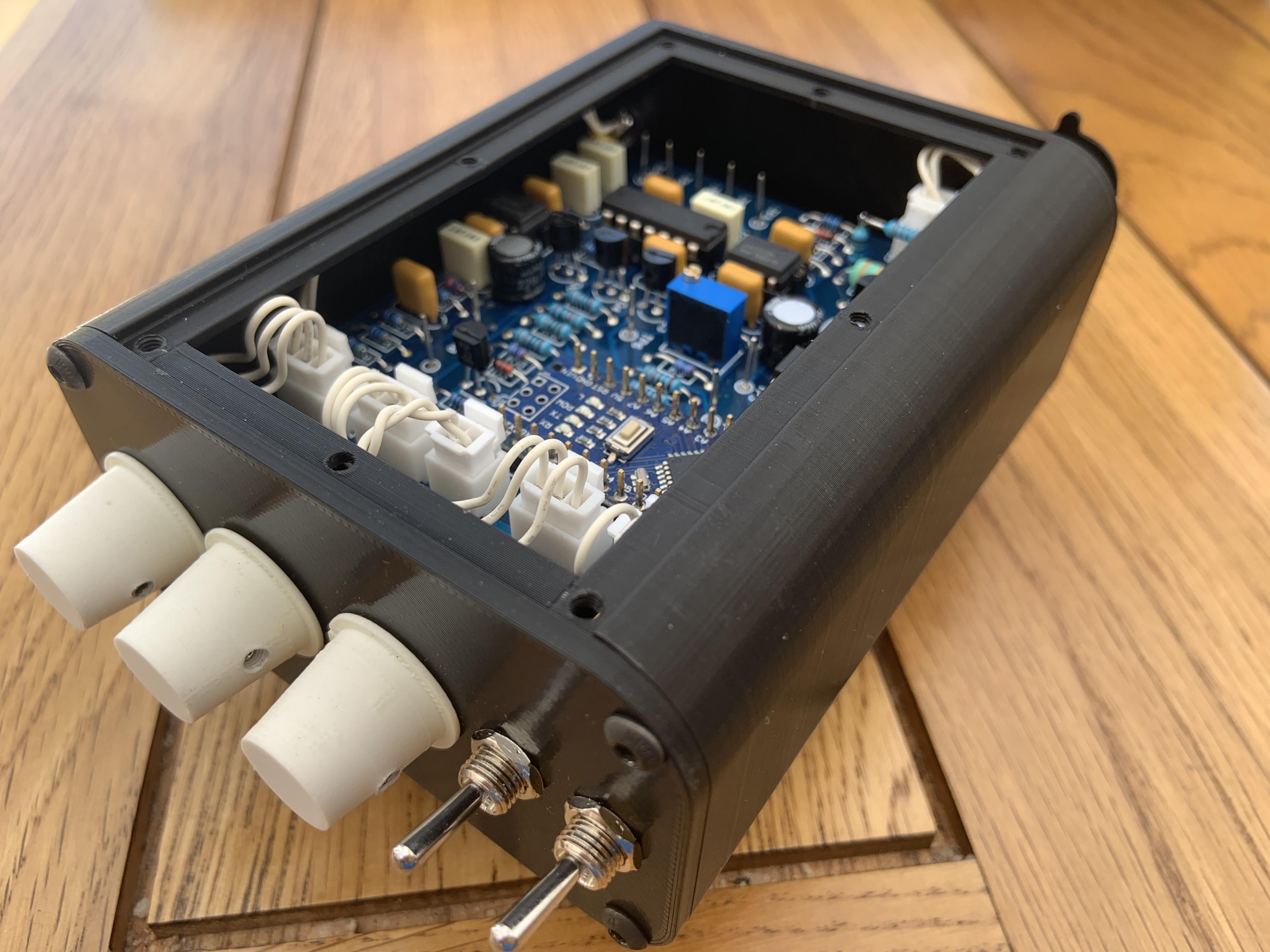

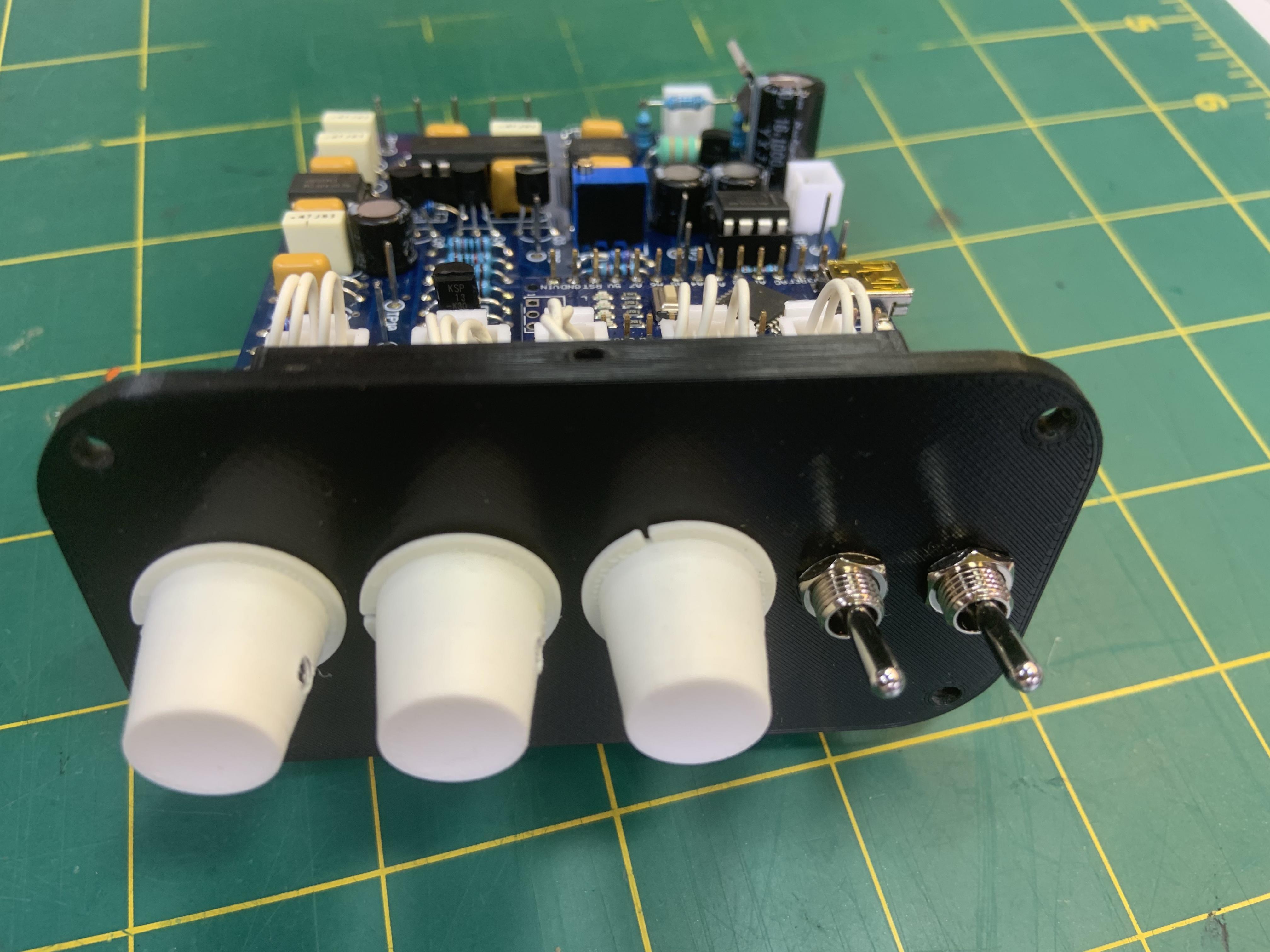

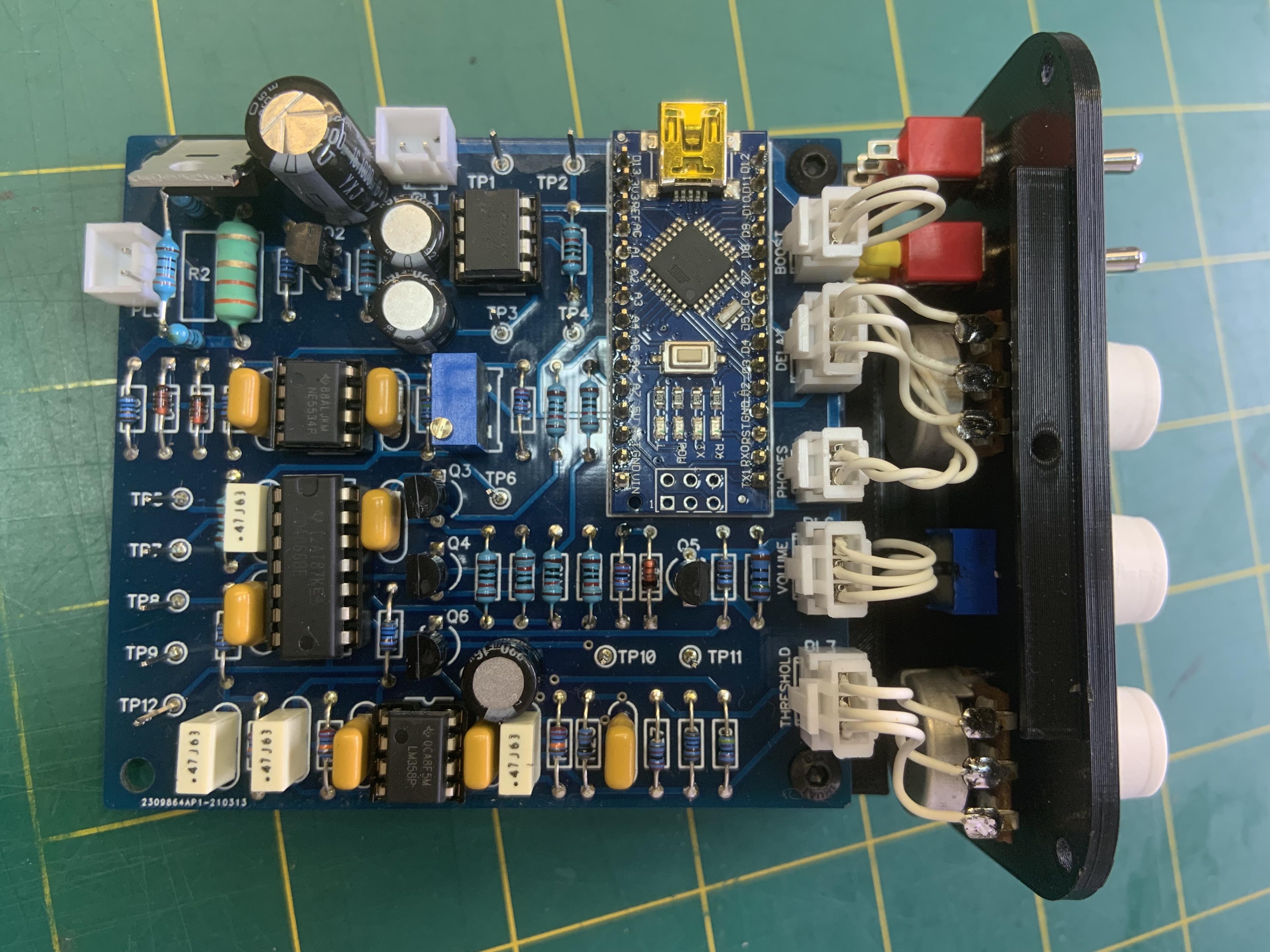

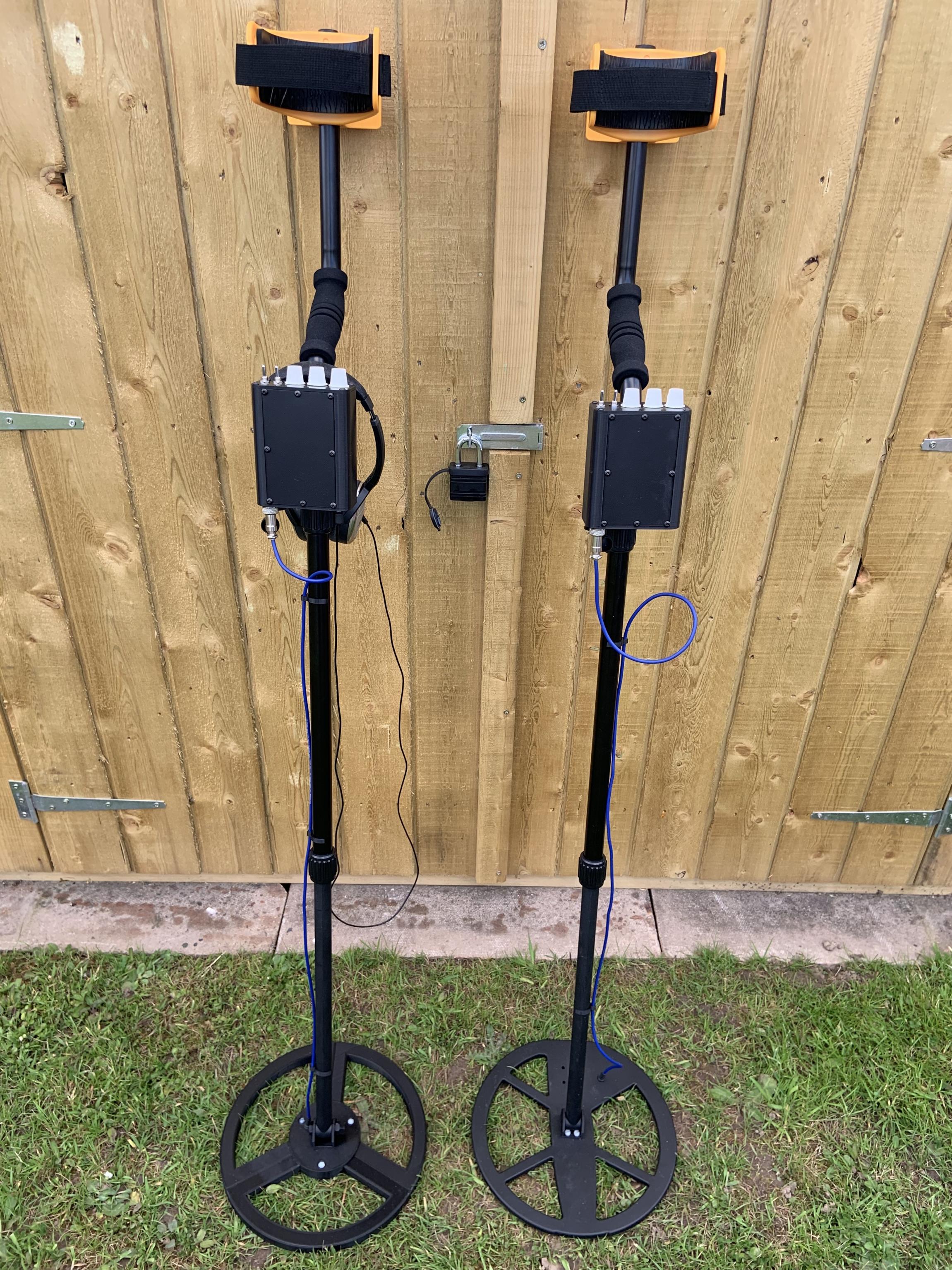

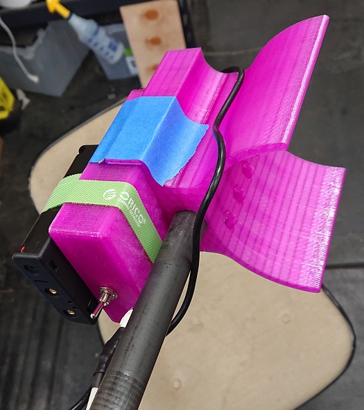

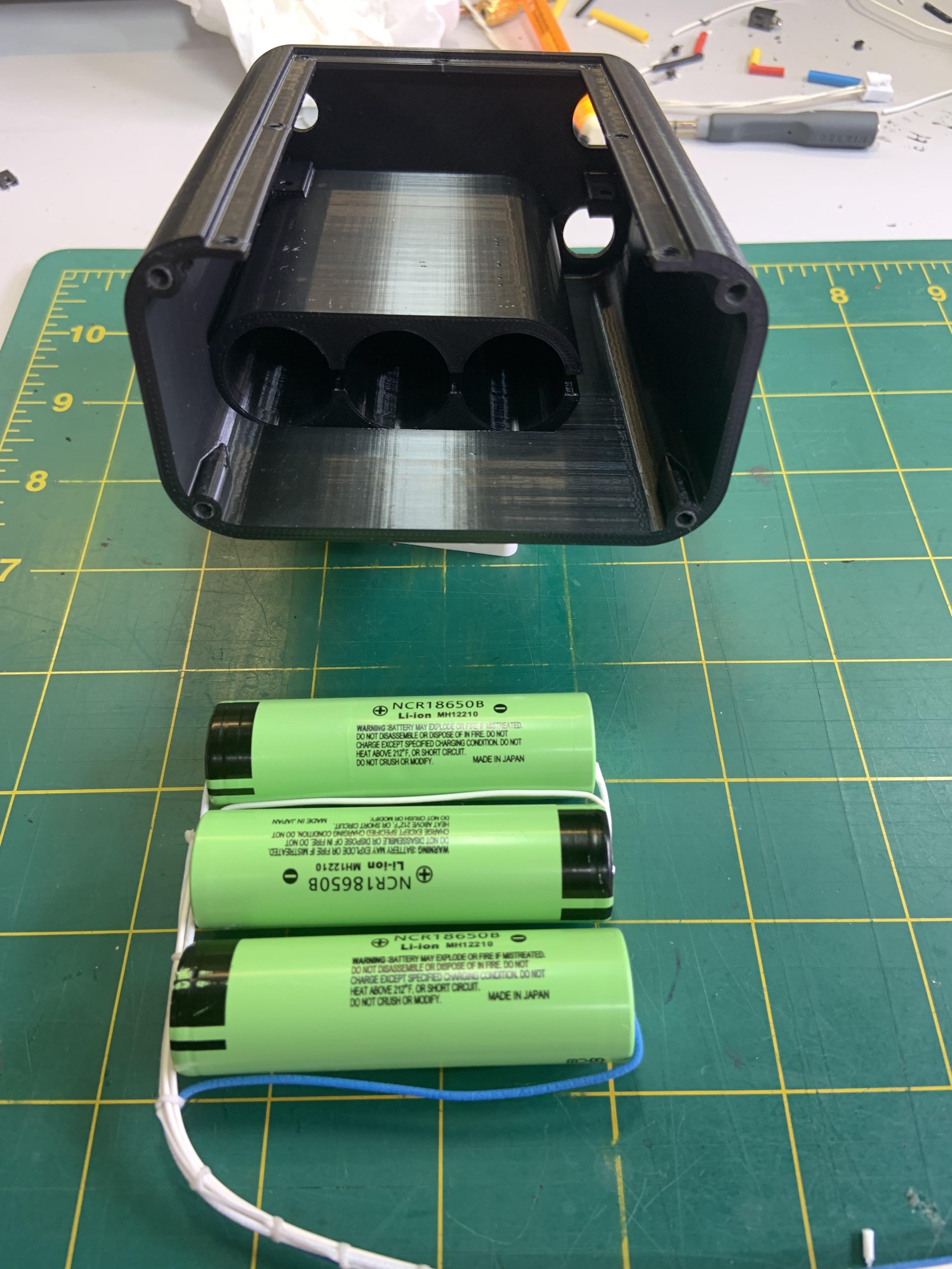

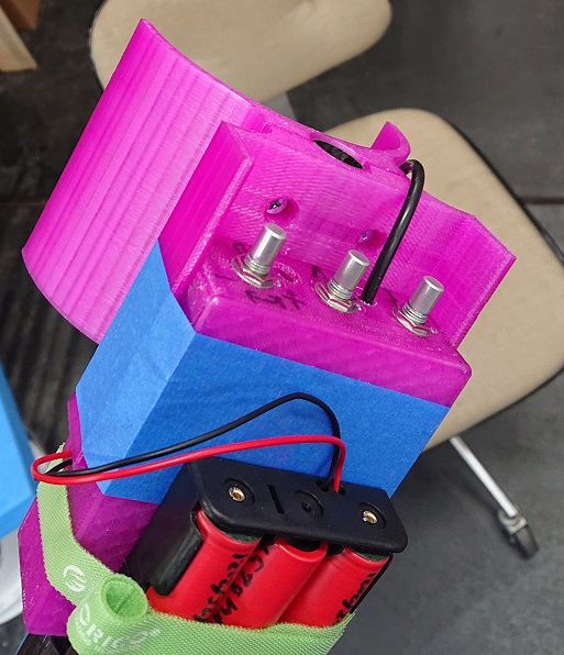

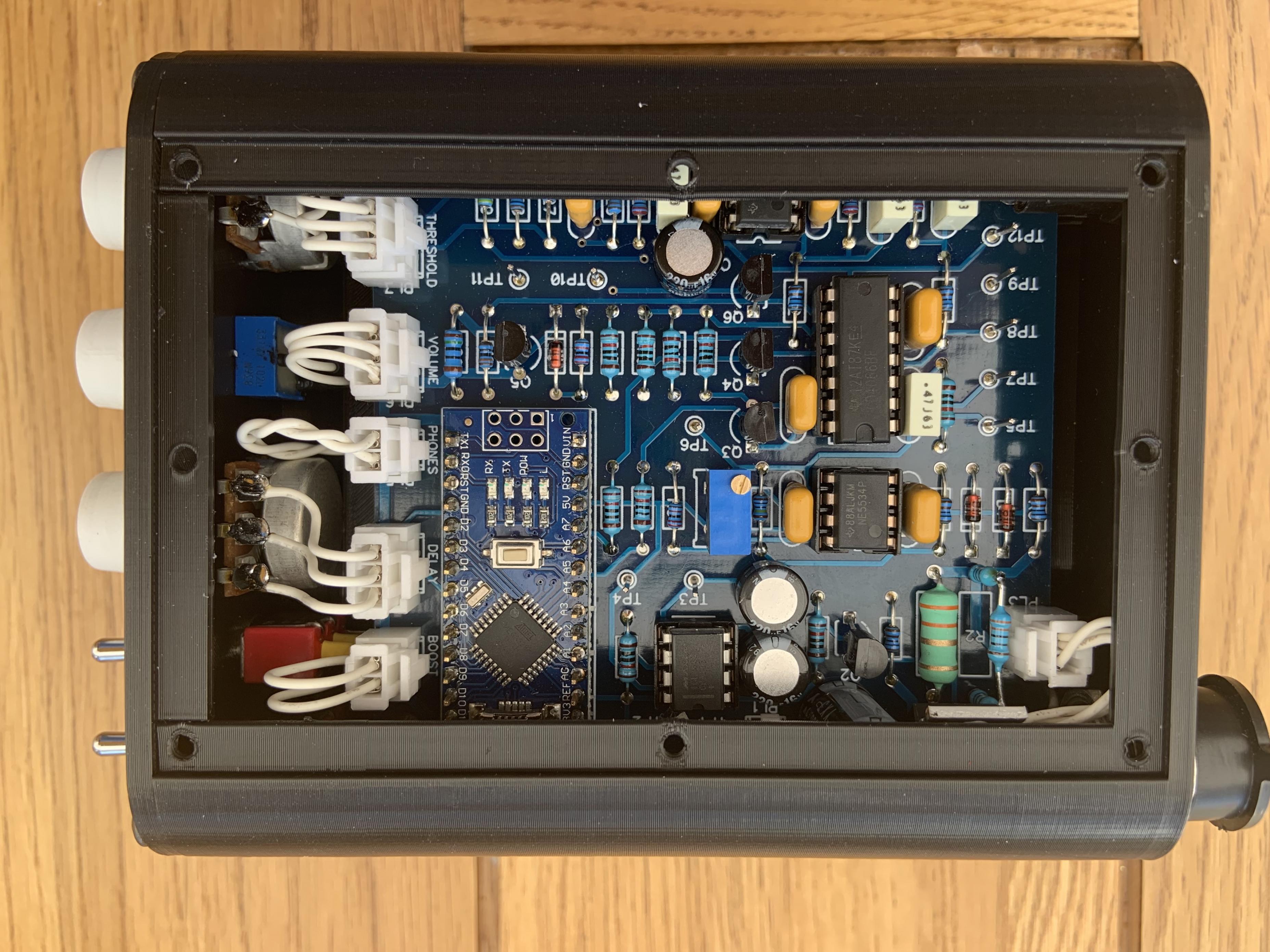

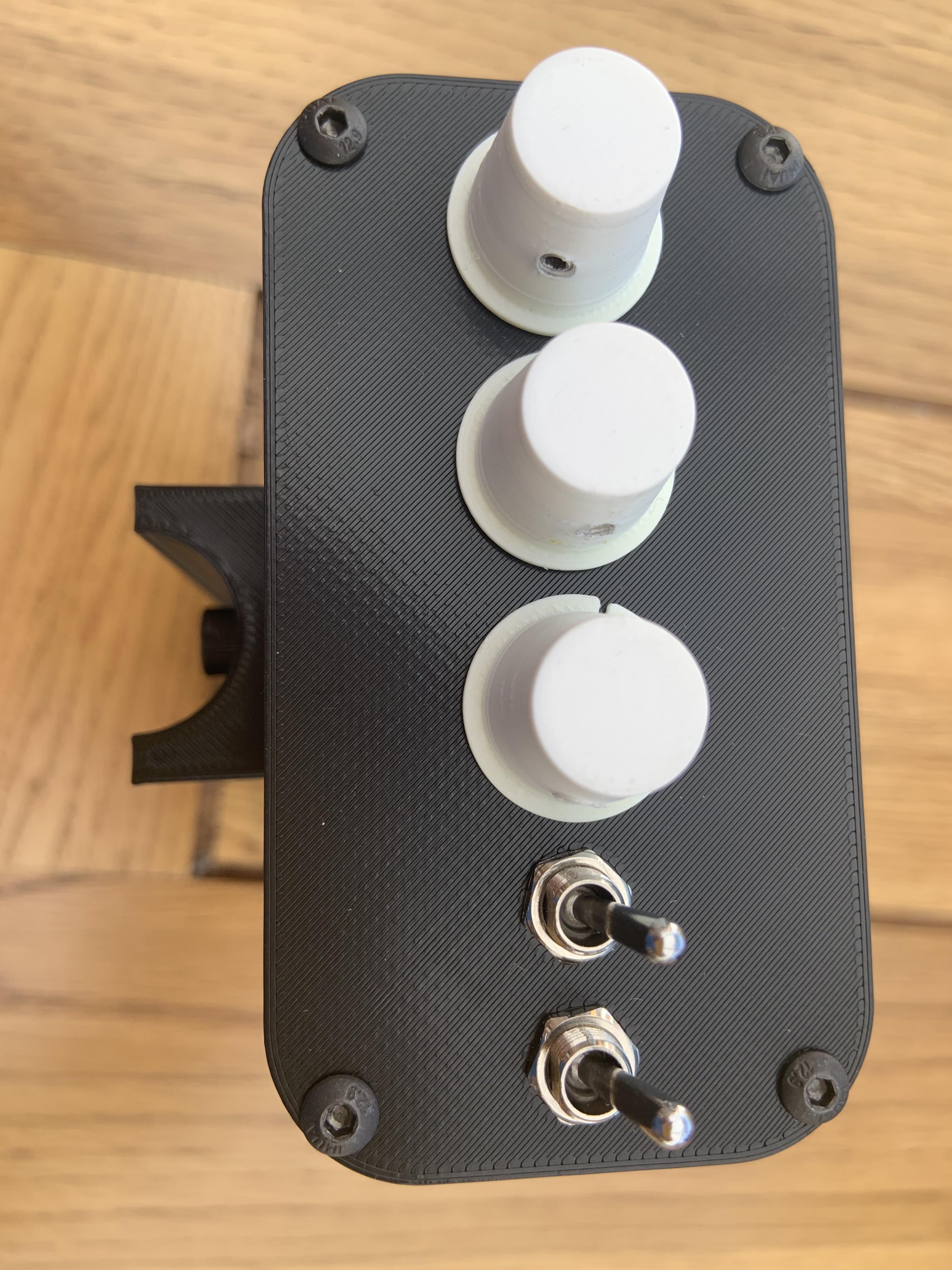

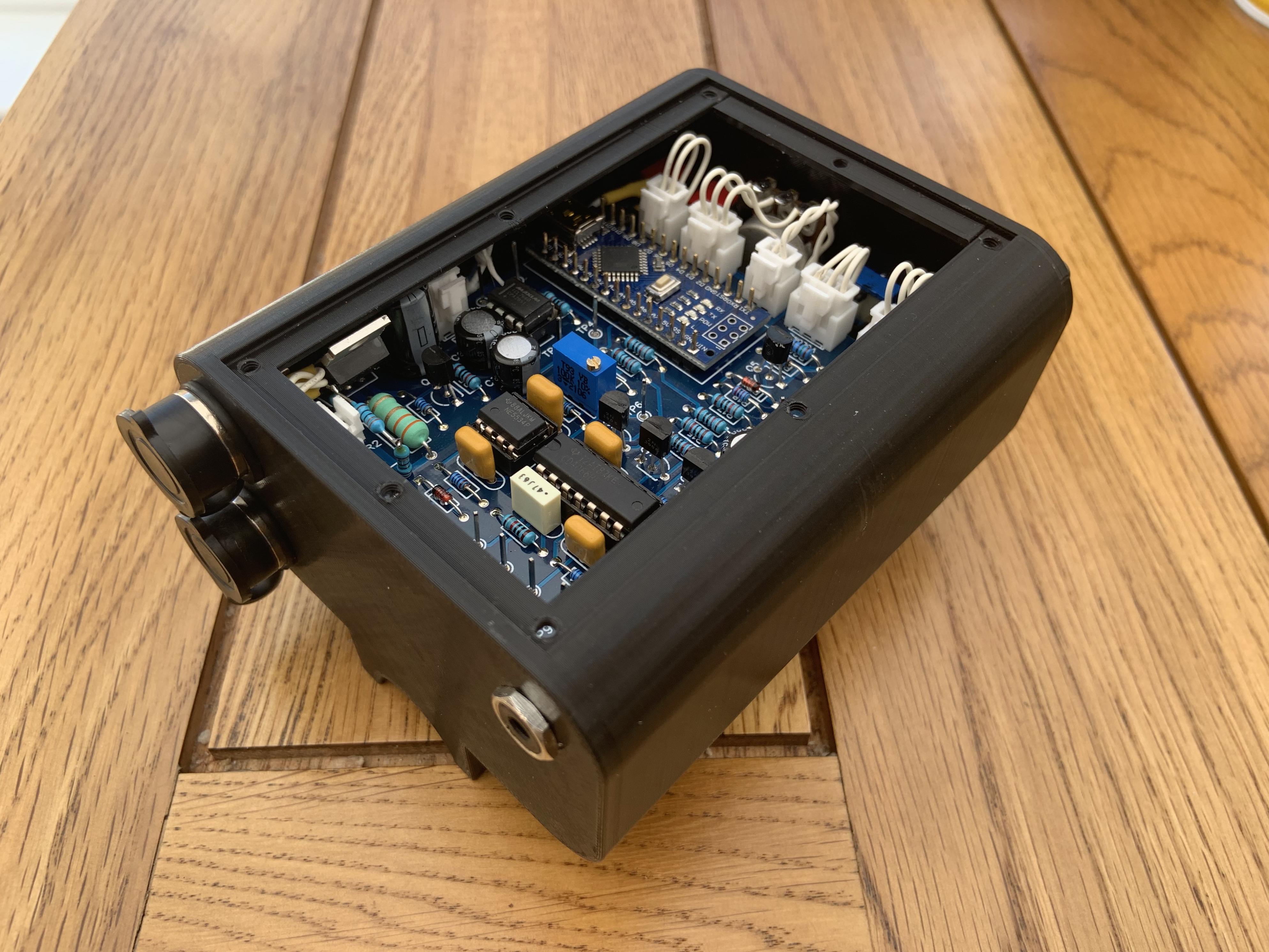

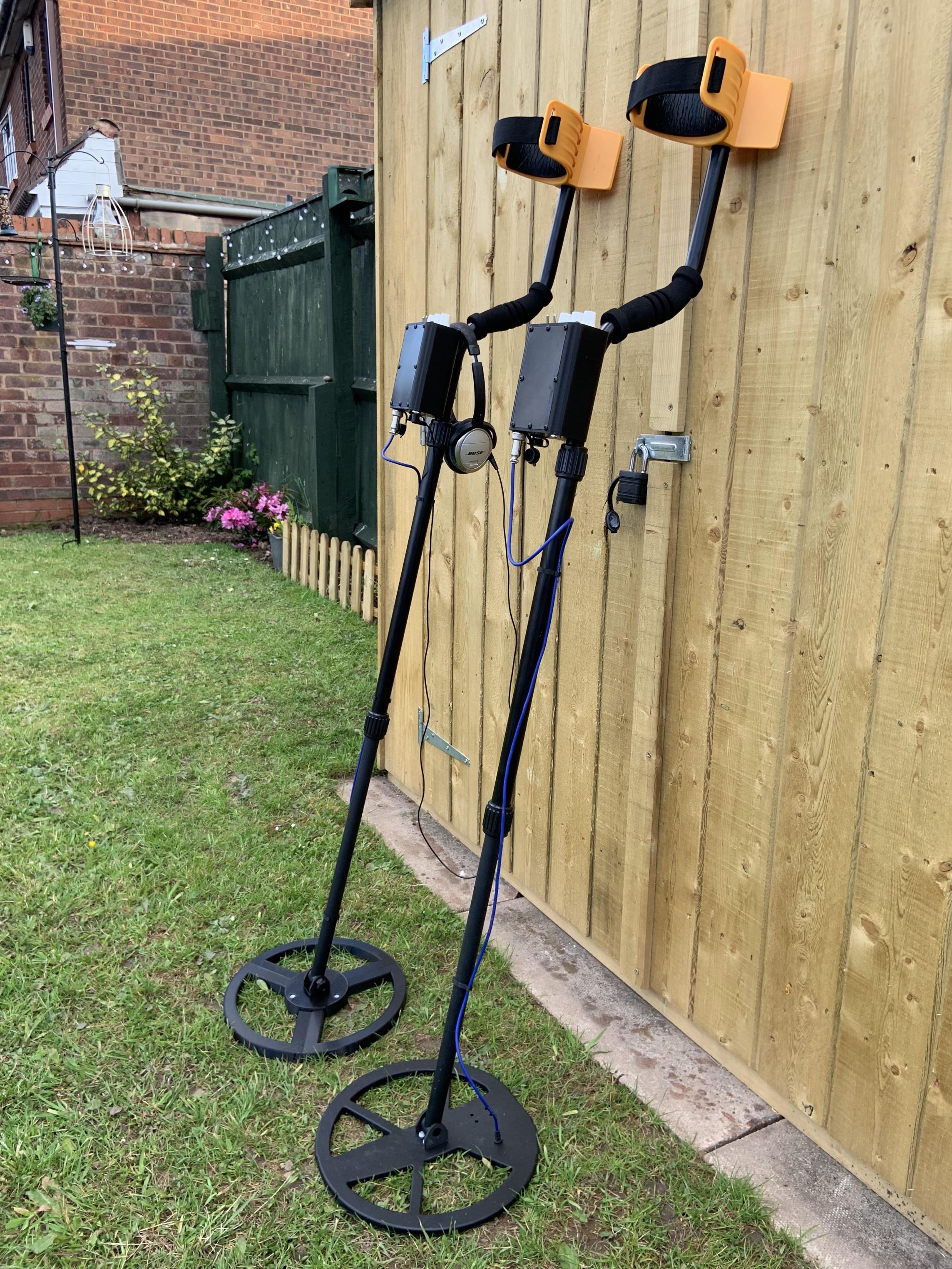

Completed Arduino Nano PI
My wife also wanted one, so had to make two.
Stems from China via Amazon at around ?20 each (4 weeks wait though)
Batteries are 3x LiIon cells which slide into the bottom section of the case.
The case, panels and knobs are all 3D printed, as is the coil former on the LH detector.
Off for a beach holiday in Jersey in a few weeks time to put them to the test.
Many thanks all for the help.
Great job!Originally posted by Olly View PostMy wife also wanted one, so had to make two.
[ATTACH=CONFIG]55433[/ATTACH] [ATTACH=CONFIG]55434[/ATTACH]
[ATTACH=CONFIG]55430[/ATTACH] [ATTACH=CONFIG]55431[/ATTACH] [ATTACH=CONFIG]55437[/ATTACH]
[ATTACH=CONFIG]55435[/ATTACH] [ATTACH=CONFIG]55436[/ATTACH] [ATTACH=CONFIG]55429[/ATTACH]
[ATTACH=CONFIG]55432[/ATTACH]
Hope you have a wonderful holiday, and show us your finds!

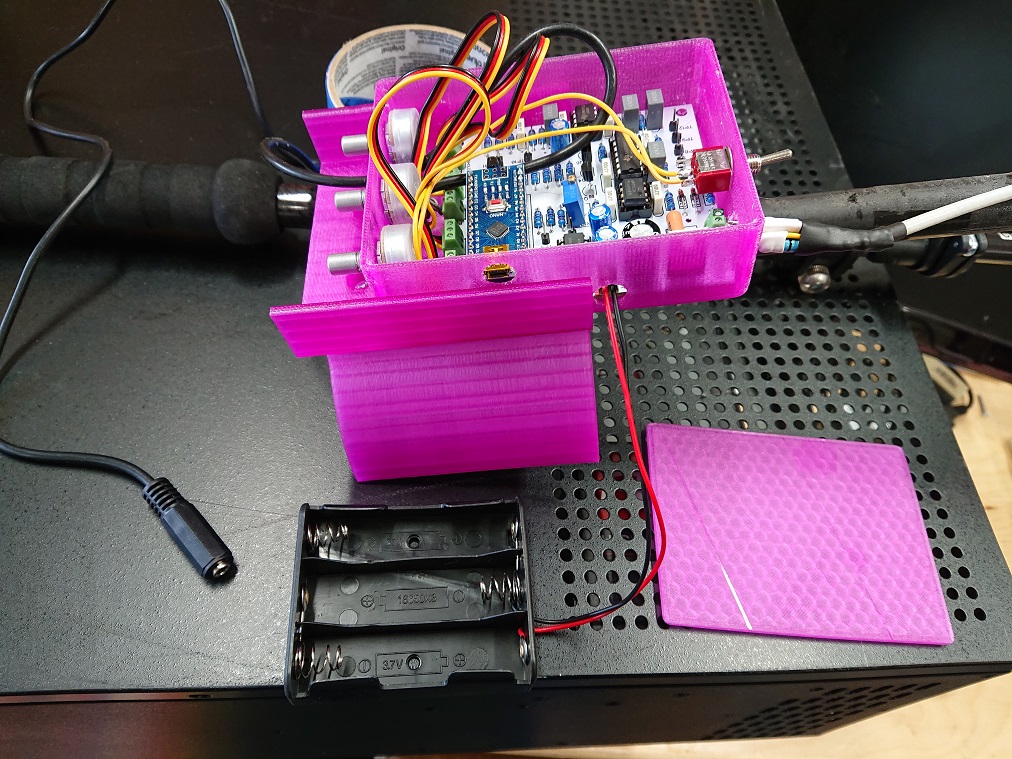

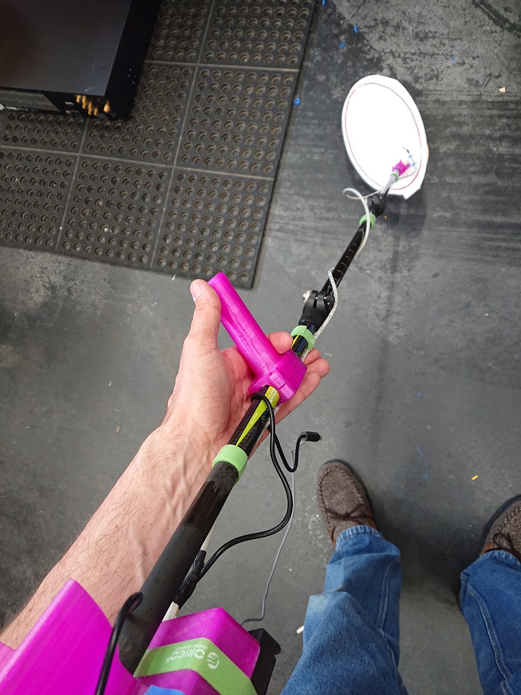

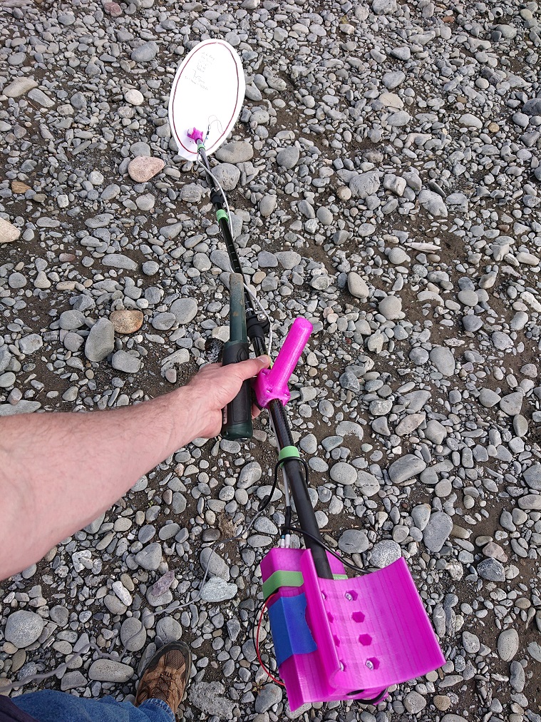

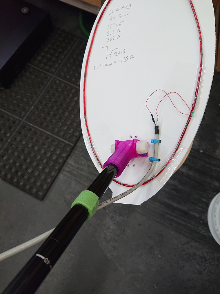

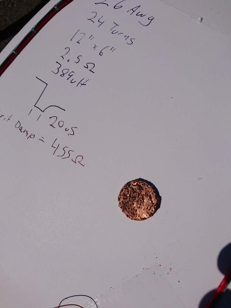

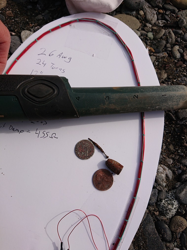

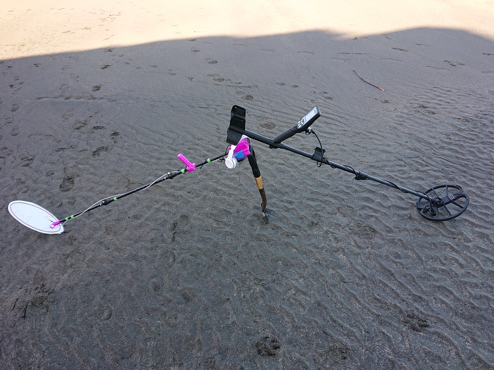

Just figured I would post up some fun pictures of my first field tested NanoPI. Worked well at the local river (Finds1). Managed to give my Nokta Simplex+ a challenge in wet sand beach condition. This is FAR from my final, polished version. Just proving out the mechanical stuff. I must admit my foam backed coil is rather light weight! ;-)Attached Files- NanoPI - Coil.jpg (231.6 KB, 229 views)

Great to see that some builds actually make it off the bench and into the real world.Originally posted by dingbatca View PostJust figured I would post up some fun pictures of my first field tested NanoPI. Worked well at the local river (Finds1). Managed to give my Nokta Simplex+ a challenge in wet sand beach condition. This is FAR from my final, polished version. Just proving out the mechanical stuff. I must admit my foam backed coil is rather light weight! ;-)
