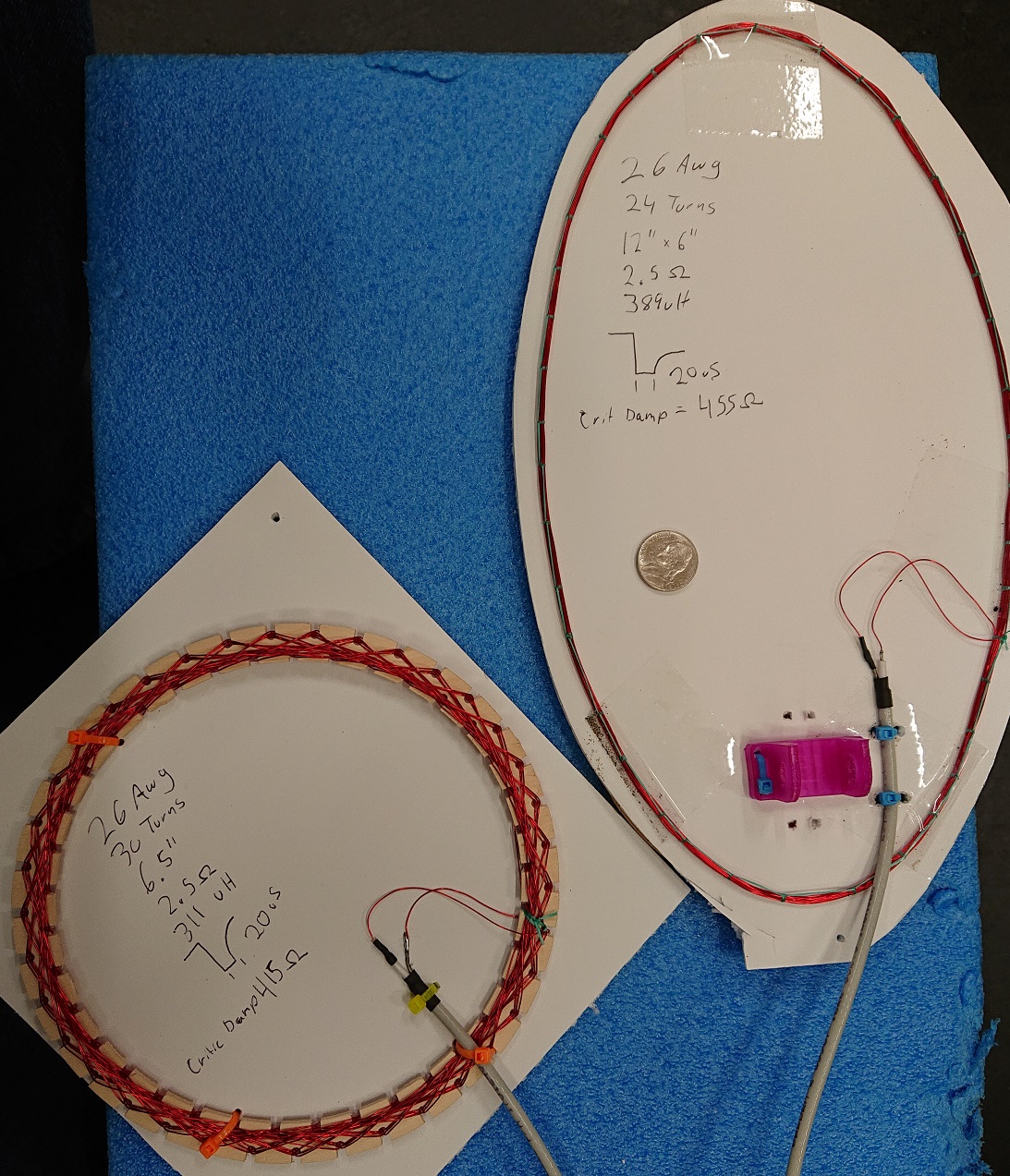

  • I like the 12x6", but I have a 14x7" elliptical basket in the works.
    Take these measurements all with a grain of salt.
    Field tested 12x6" elliptical coil I can reliably pick up a US Nickel at 7 inches (18CM).
    6.5" Basket coil I can reliably pick up a US Nickel at 9 inches (23CM).
    • Originally posted by dingbatca View Post
      Thanks always good to know.

                  • As I am genuinely curious; what would it take to tune the Nano Pi to search for gold? I have a little 0.35 gram gold nugget that my Simplex+ can see at 4 inches. But my Nano Pi cant seem to see it at all.
                      Probably a rework of the RX preamp design and adjusting sample timing and sample delay.
                      A small piece of natural gold has a very short TC. Therefore one must sample early to detect the very short decay.

                        • I know of a basket coil. What is a 3DSS coil? Build instructions?
                            Search the forum, there are threads about it here.
                            • @Dingbatca, The link you posted of the 'Basket' coil' is the same as the 3DSS coil that it is commonly now called on Geotech. The '3D' refers to the 3-Dimensional finished shape of the coil. I can't remember what the 'SS' stands for now but you can find a really in depth building method on the Chance PI Thread. Regards, Marty.
                              • "SS" is for self shielding as the 'outer' turns effectively shield the main bulk of the coil.
