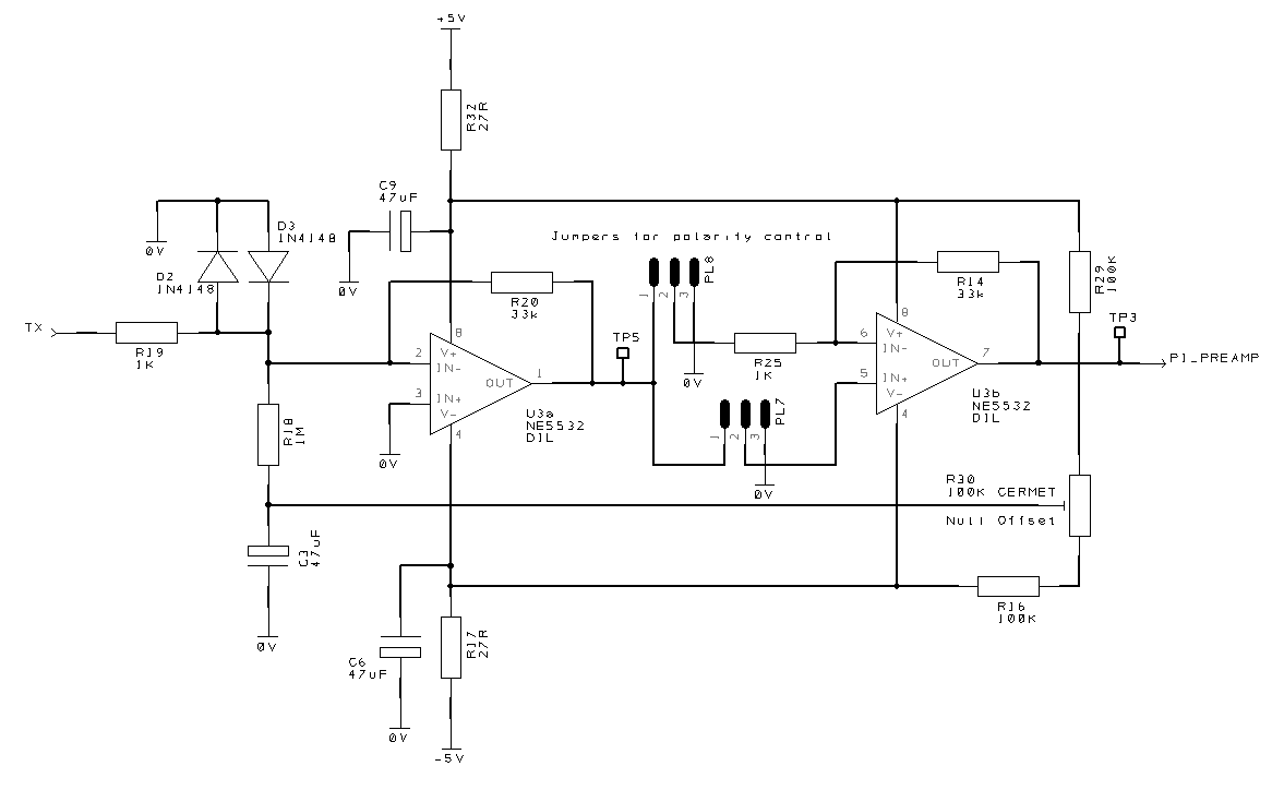

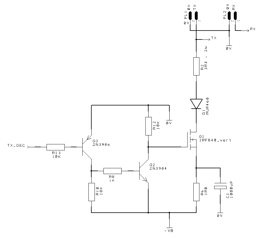

          • Originally posted by dingbatca View Post
            Perhaps I should be asking what the best TX and pre-amp circuit's are? Wow, that's a loaded question! This rabbit trail might be worthy of a different thread.
            In terms of existing [and known working] projects, I would suggest using the Voodoo transmit circuit and PI preamp, as this can be driven from a micro.
              Hi,Qiaozhi
              I'm also concerned the issue that what the best preamp.
              What is "Voodoo transmit circuit and PI preamp"? Can you show schematic of it?
              • Originally posted by lc516 View Post
                Hi,Qiaozhi
                See attached files.

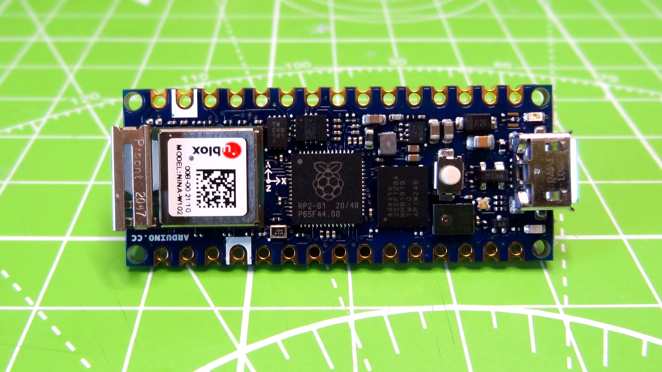

                • Arduino nano RP2040 same form factor as the nano but a whole lot more. Maybe this can open more possibilities for development.
                    Looks good, this write up points out a few issues
                    https://www.tomshardware.com/reviews...rp2040-connect
                    • You could utter the words "beach mode" through a Bluetooth headset and presto!
                      Our friends in eastern Europe might say " bittch mod" , which might cause a different effect, now all targets become rejected!
                        Too many issues to be resolved, and expensive!
