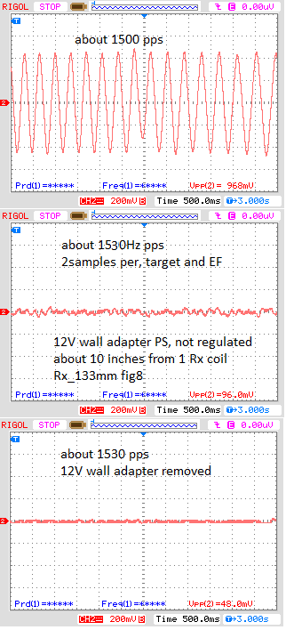

          Just guessing. Adjustment control is for power line harmonics or maybe some other continuous frequency. Don't know if crackling noise is aliasing.
          Some scope pictures of differentiator out, about 1500 pps(25 harmonic). Amplitude not the same at each harmonic, maybe do to EF sample not centered?
          12V PS orientation makes a difference with amplitude

            Tried some other harmonics. Odd seemed to be higher amplitude. Is there some reason odd is higher or just what it happened to be today?
                Short answer: Yes, typically the Odd Harmonics are higher due to half-wave symmetry in power systems.
                The long answer is very long and requires much study and math.

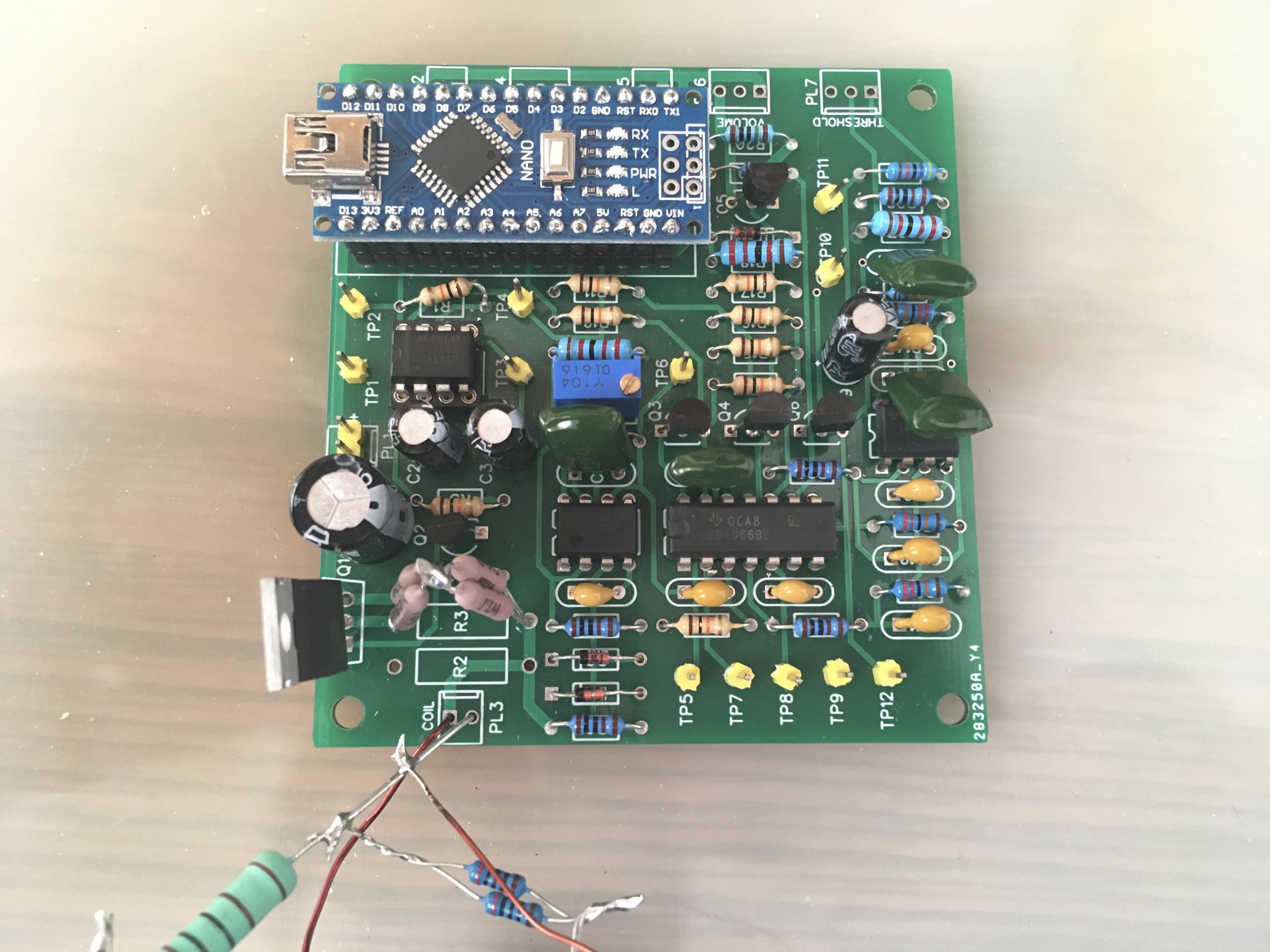

                  Have you programmed the Nano?
                  You must do that before you can measure -5V at TP3, as the Nano generates the external clock for the 7660.

                        I use a icl7662cpa replace the abnormal MC7660. But it have same problem, I can't get -5V on TP3 if use 1k external clock.
                        If use internal clock(disconnect R1) I can get TP6 output, just a lot of noise on there.
                        Do I should check C3 and C2, or elsewhere?
                        Any information you can provide, Thank you guys!

                              • Originally posted by lc516 View Post
                                [ATTACH]54938[/ATTACH]
                                I think the problem is that you're using an ICL7662 instead of an ICL7660.
                                Although looking at the ICL7662 datasheet, I cannot see anything which explicitly states that it won't run at 1kHz.
