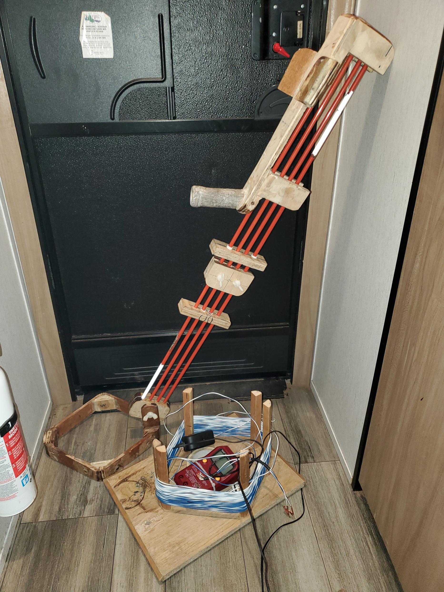

    Tried taking my round coil off the former and made it an oval shape but now getting ripple from preamp, didnt readjust the dampening resistor, so decided to build new coil.

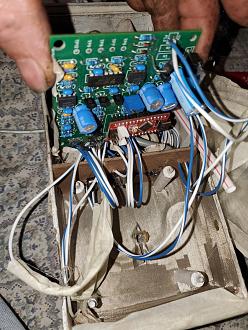

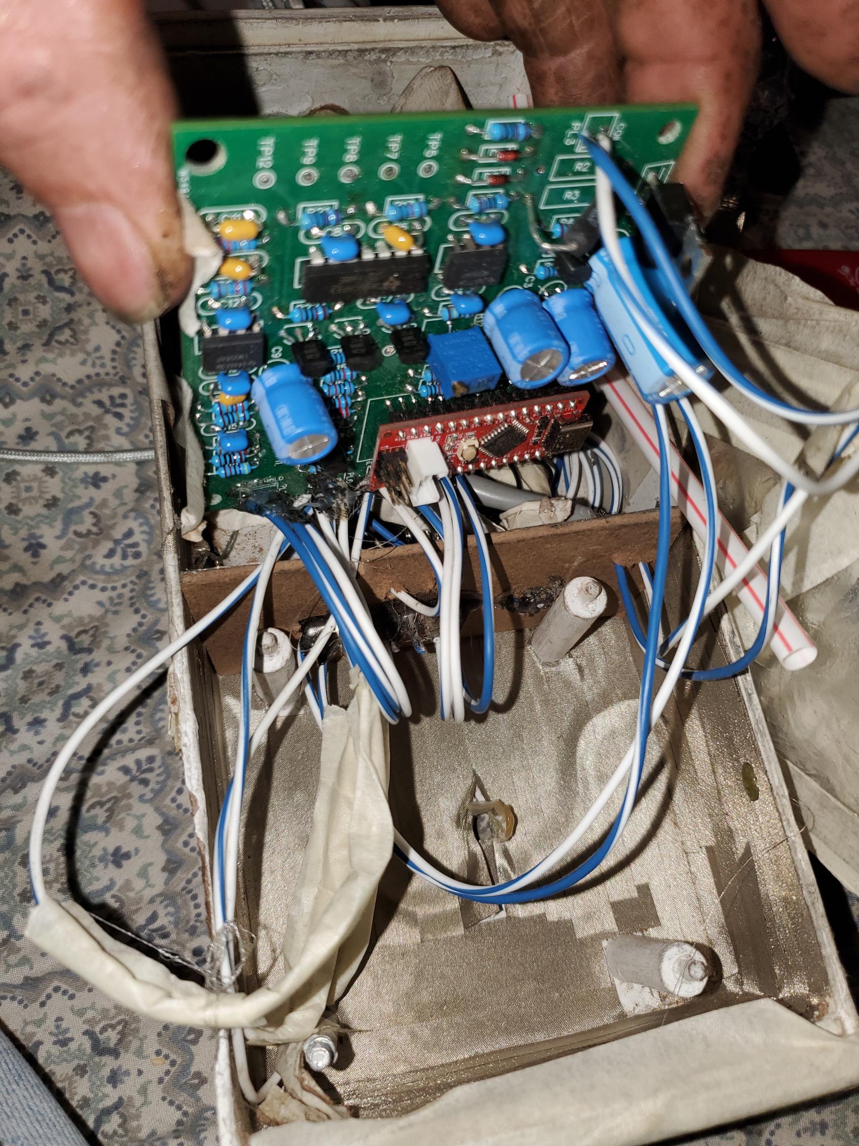

    Almost done with the physical contruction of the shaft,pole,armrest and grip. Started with electronic under armrest, too heavy, going to sling pack electronics/batt/knobs or fanny pack Click image for larger version

    There were some silkscreening errors that needed fixing.

    Hope to finish shaft,coil holder ,armrest and take pics today.

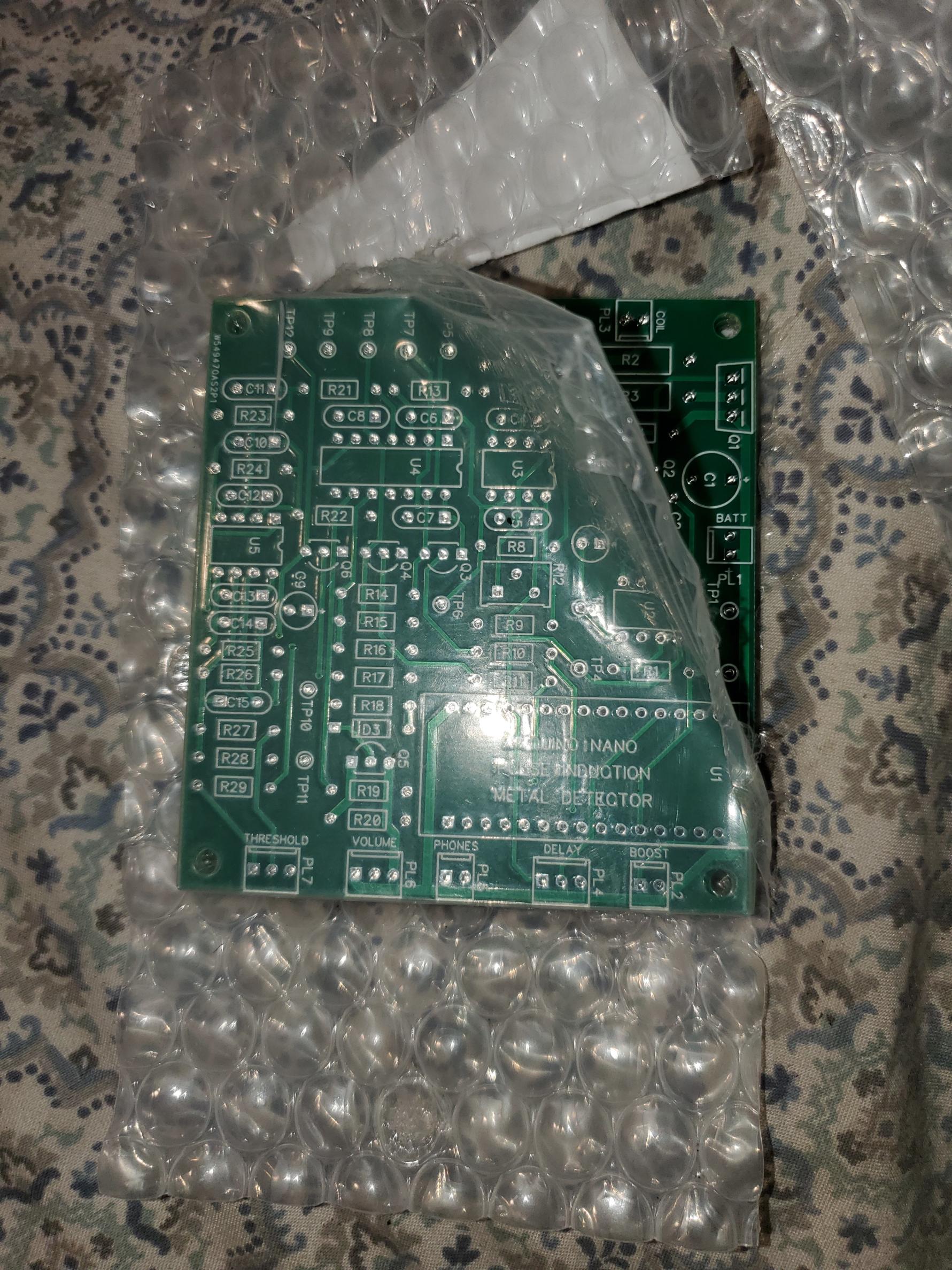

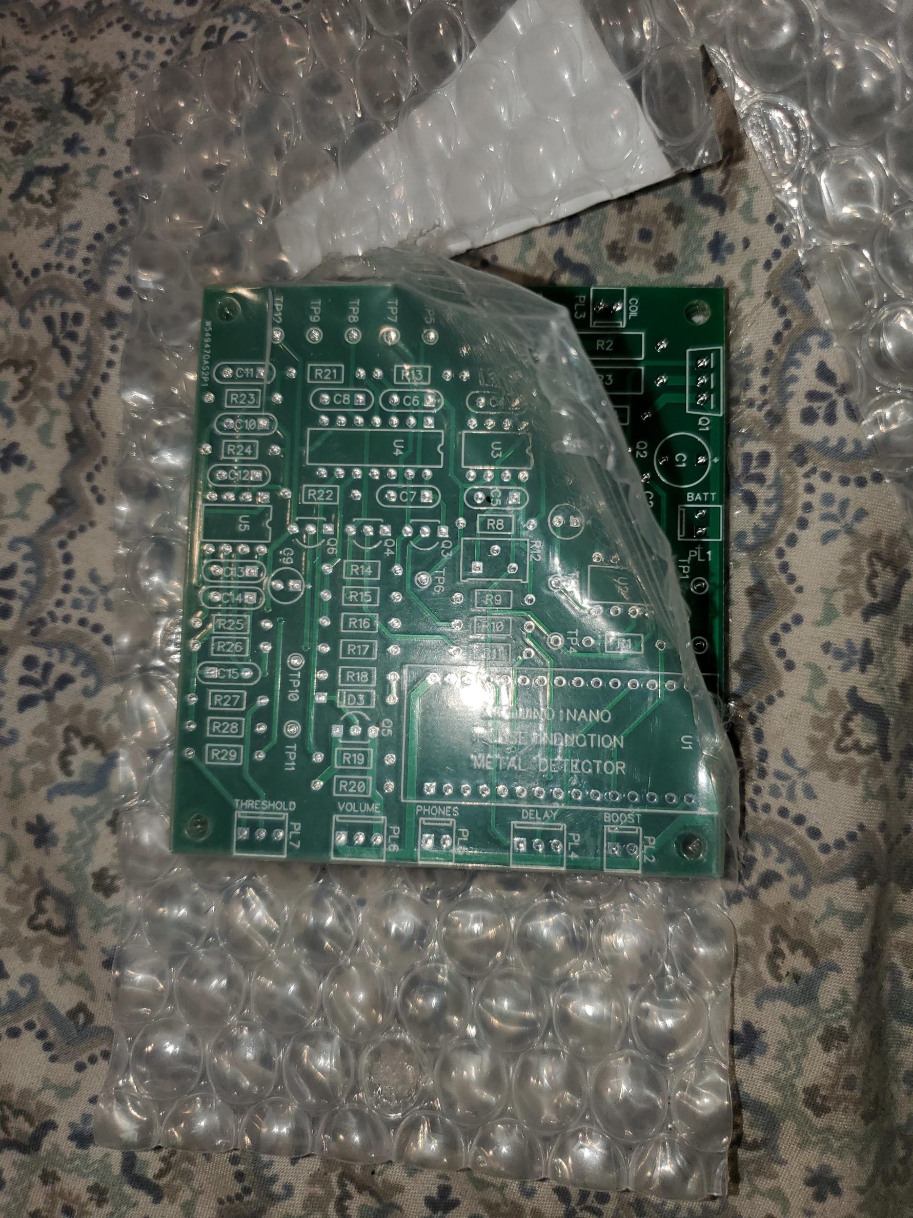

      • Does anyone have a link to the project pcb on JLCPCB?
        I would like to order a few boards.
        UPDATE> I just ordered them! for $2 for 5.

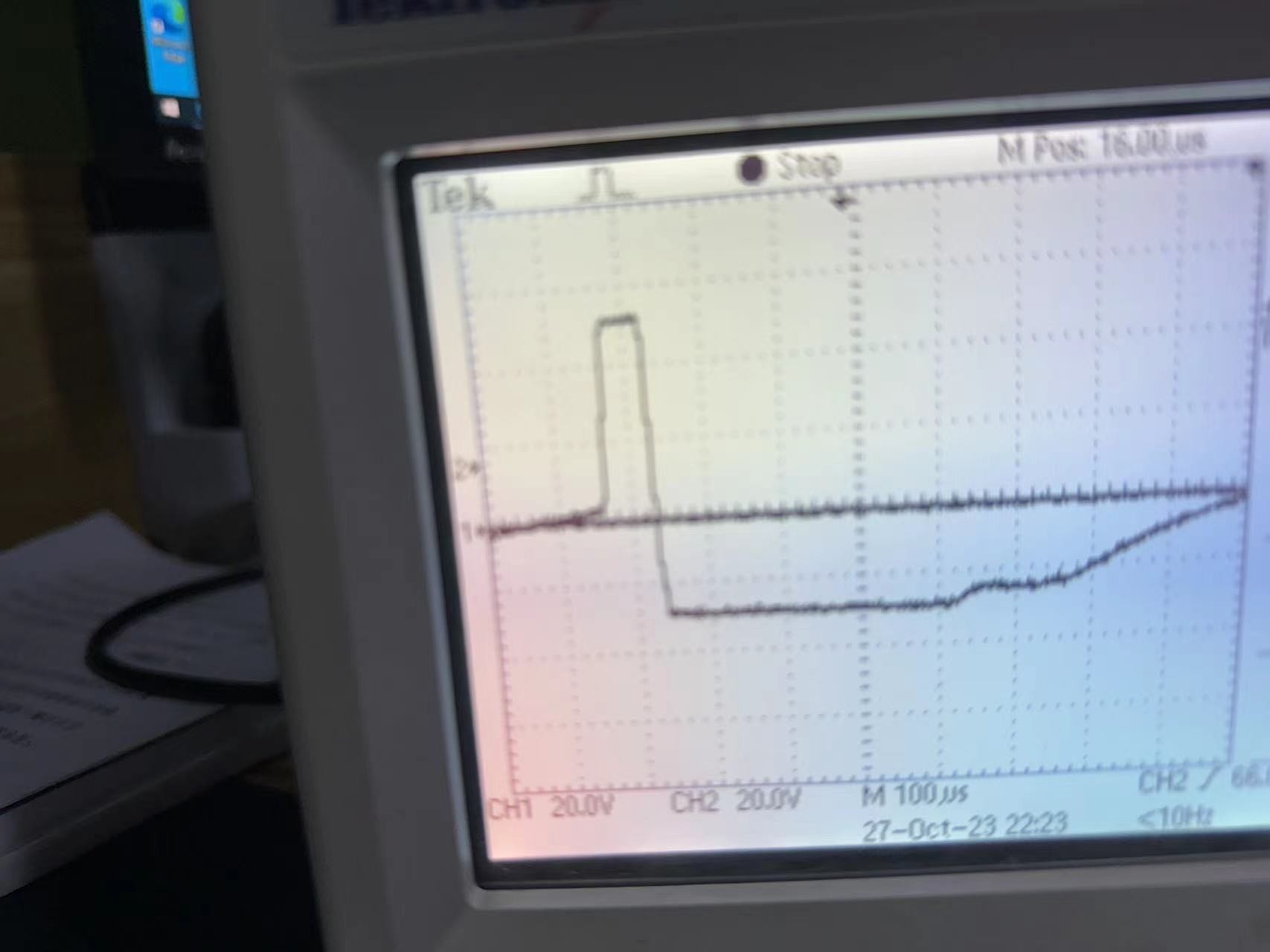

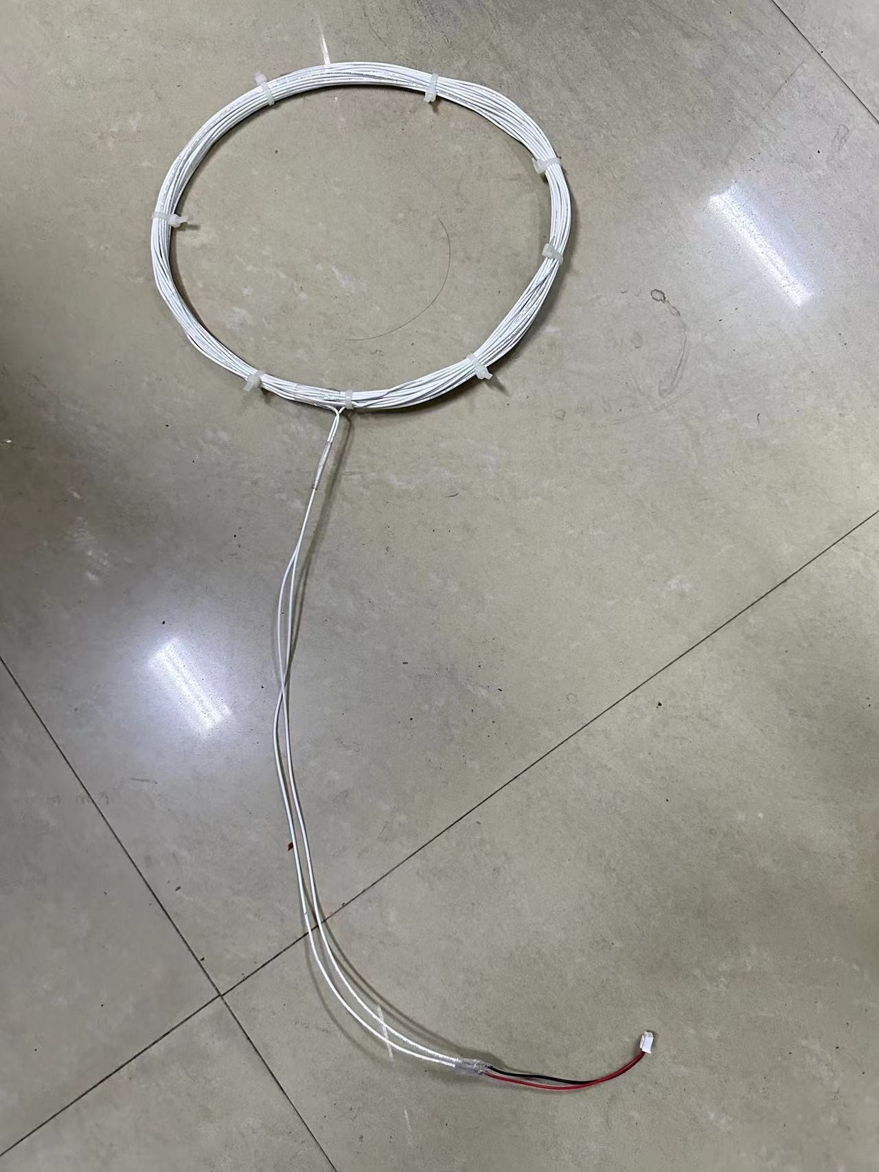

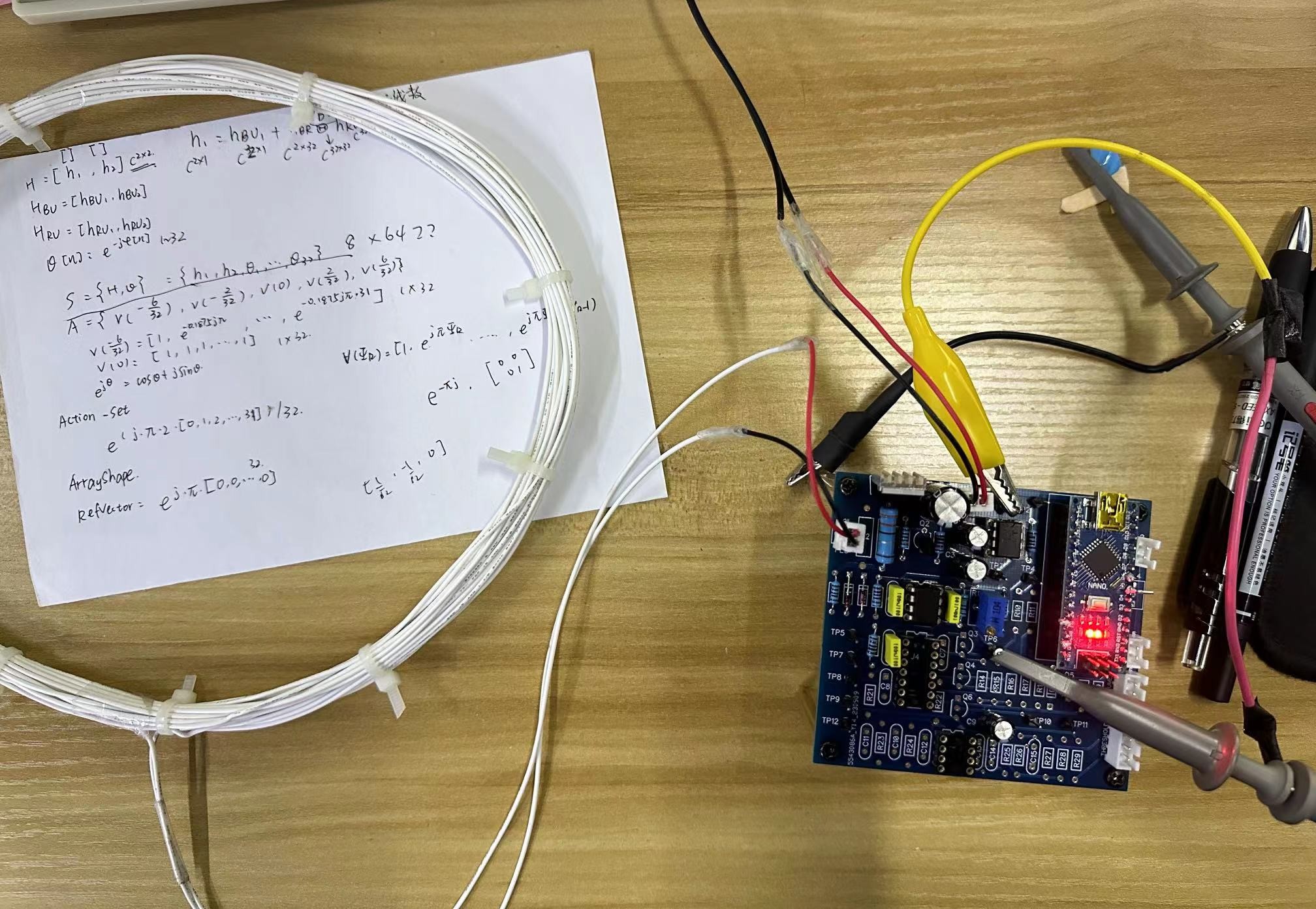

        • I'm a metal detector amateurs and my electronic knowledge is not very good, I'm reproducing this project, but I'm having difficulties, when I measure the TP6 waveform,I found that it's not good, and there is almost no induction for coins.​​Is it because the inductance of my coil is too small.

          I'm using a coil calculator to figure it out. It's 26AWG,210mm diameter, 25 turnsClick image for larger version

          • According to the values given, your coil should be about 403uH, so that's not the problem.
            Is the single pulse shown on your scope the main sample pulse?
            If so, you appear to be sampling before the preamp output has settled.
            What is your timebase setting?
            Also, you have made the rookie mistake of building the whole detector and not testing each stage as you go along.

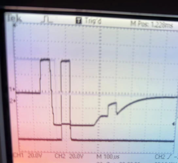

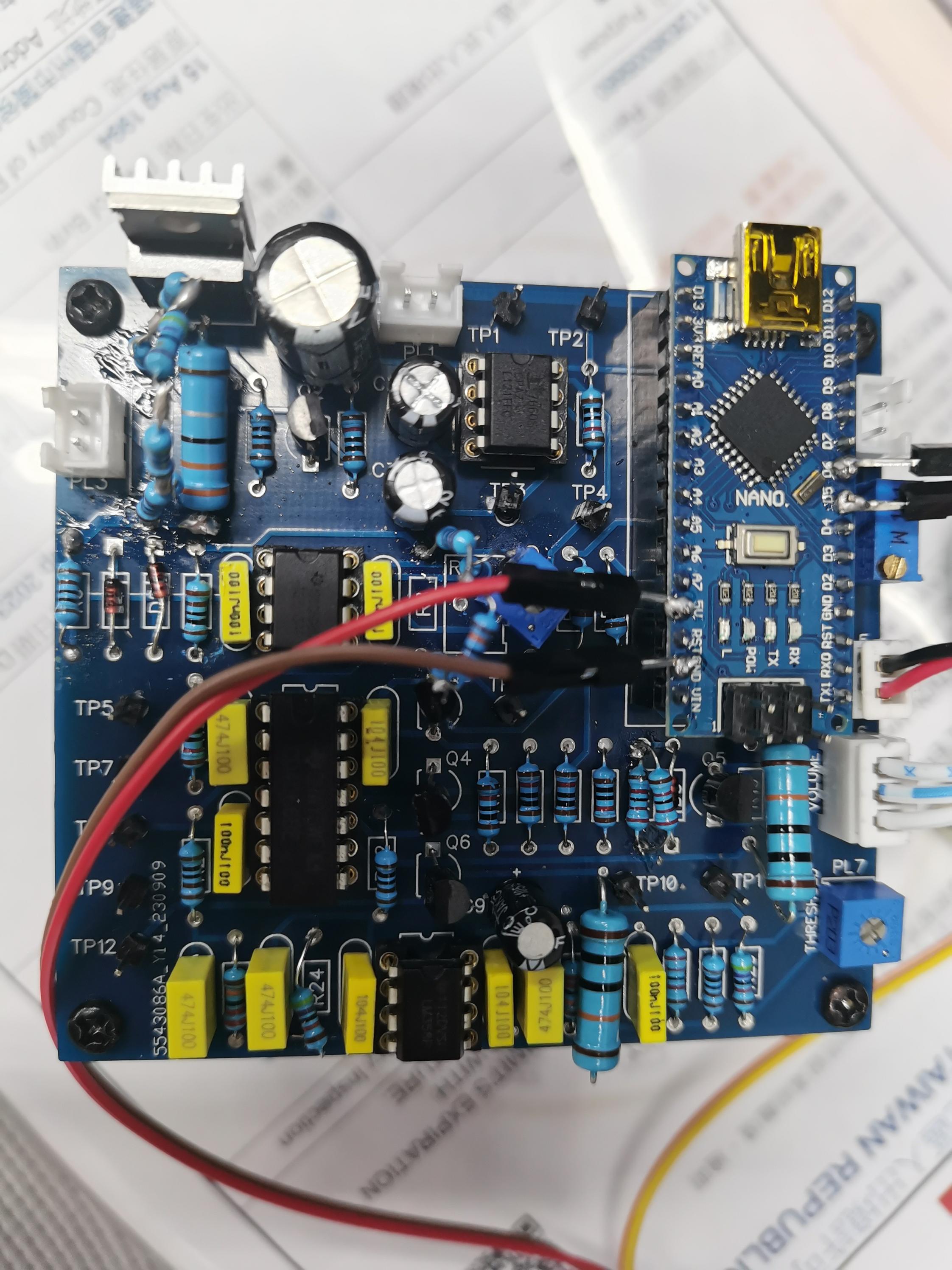

            • George, thanks for the advice you gave me.
              The single pulse is the output of the TP5, the time base setting in my diagram is 100us.
              To correct my mistake I went to watch the surfdetector's videos and rebuild the board.
              When testing the TP6 output I did not add the damping resistor, comparing it to the results in his video, I found that the expansion of my waveforms was too long (timebase setting is still 100us).
              So I think my homemade coils might not be good enough, I'll make a new one and check that again.
