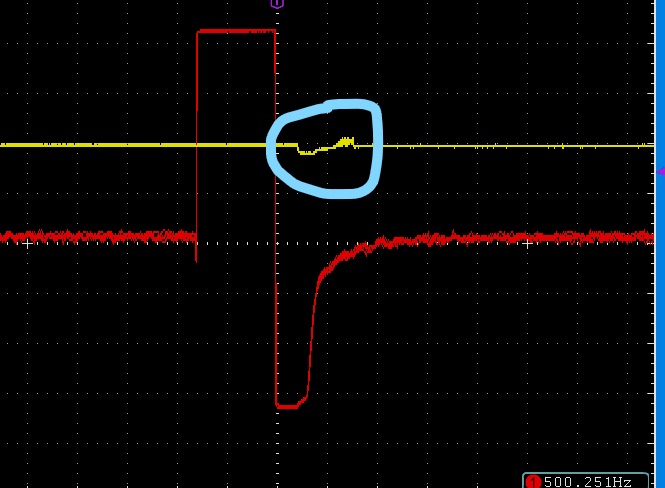

                    • When I set mainSample to be less than 30us(sampleing starts when the slop of preamp is high), I got this waveform on TP11
Name:	20210427_193138 (2)_LI.jpg
                      This makes the audio output abnormal.
                      Is that because the capacitance on OPA?
                      • Originally posted by lc516 View Post
                        [ATTACH]55039[/ATTACH]
                        Fig. 4-14 shows the correct position for the main sample pulse relative to the preamp output. If you set the sample delay to start before this point, then the preamp output will either be in saturation or close to it. This causes the audio to sound "abnormal". In fact, this is one method of finding the correct sample position. Start with the sample delay pot set to minimum, and then increase the delay until the audio sounds stable. The minimum sample point is dependent on coil you have connected.

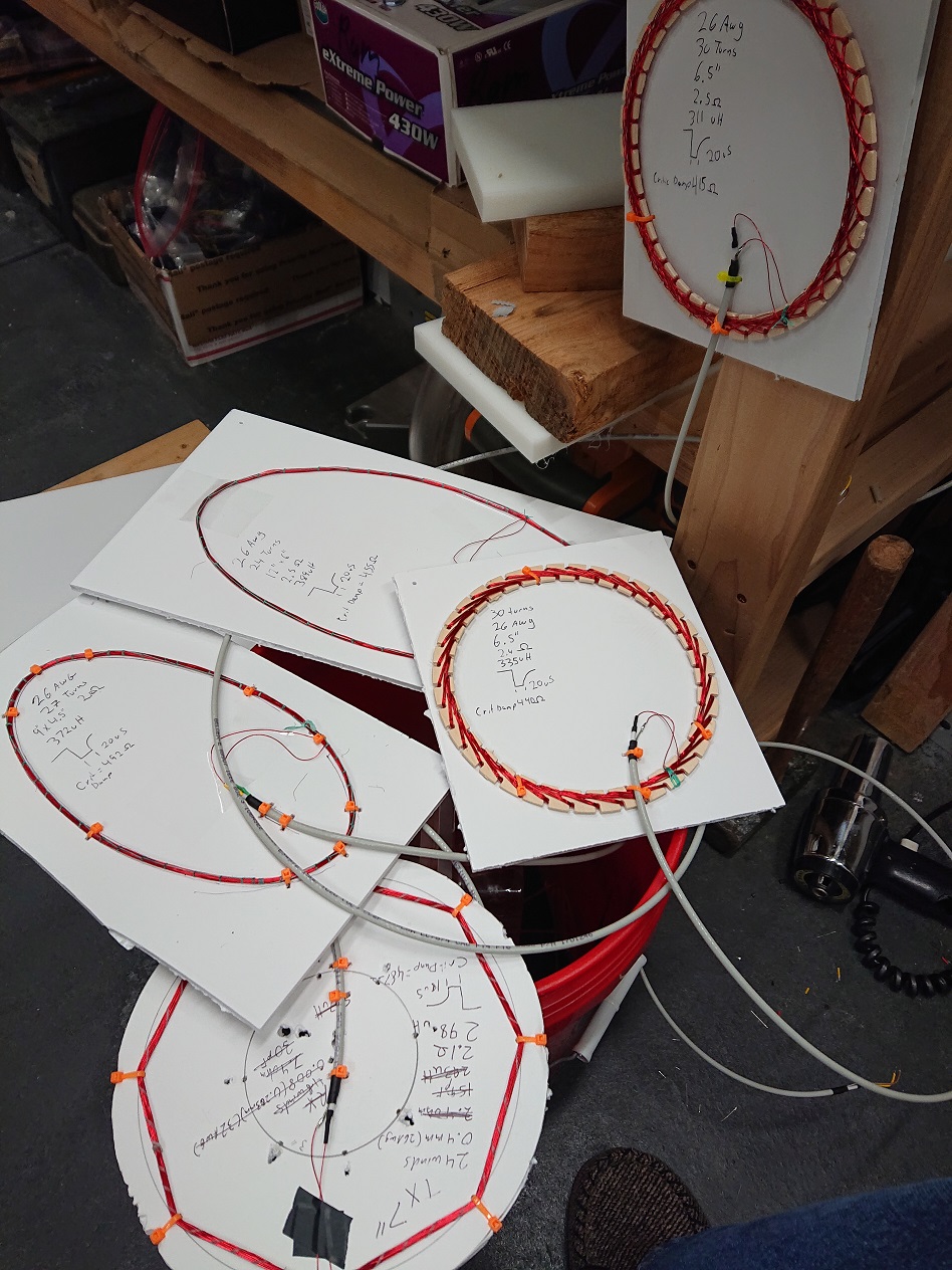

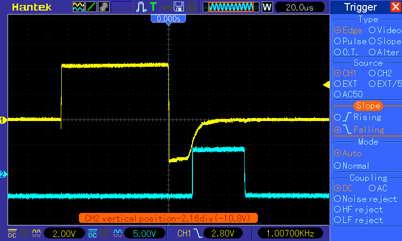

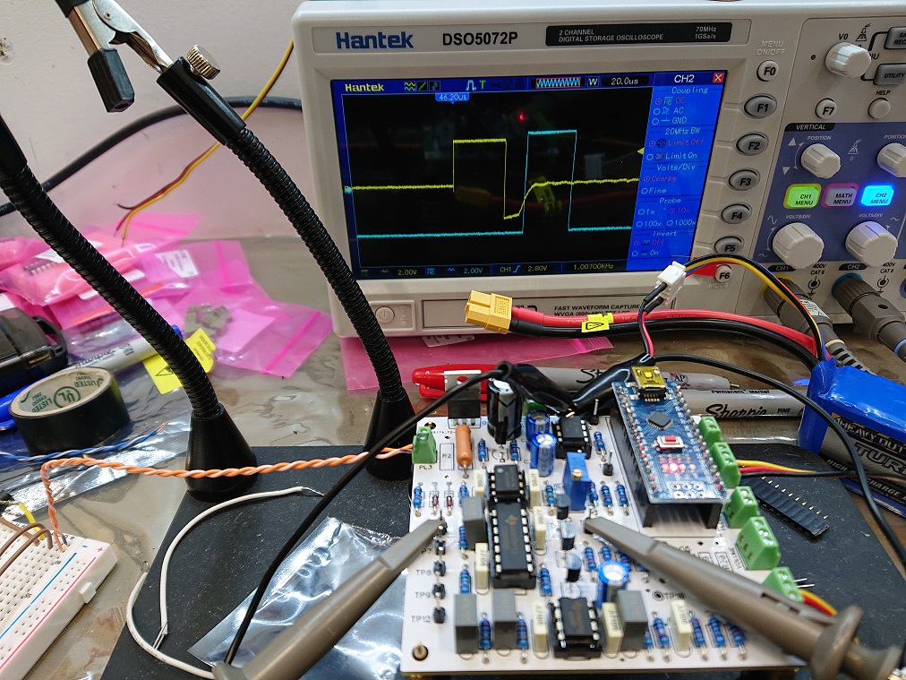

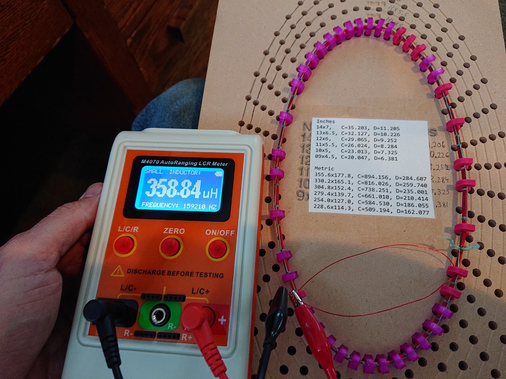

                              • I am happy to report I got my Nano PI running!
                                Now I am off trying to build a higher performance coil. I have the fast coil article that I have read through multiple time. I started off with a basic round coil, per the book. Then built two elliptical coils, and lastly I tried my hand at making a basic basket coil. Got the basket correct on the secound try. But none of these seem to respond all that much faster. All my coils are right around 18~20uS response time. I have always aimed for the same specs 300~400uH, and I have hit that range every time. Using a spool of 26awg magnet/speaker wire. I know Teflon insulation should help, but I am currently working with what I have. Happy to invest in the better wire, once I have the basic coil building technique hammered out.
                                Any advice to improve response time?
                                Pics attached.
