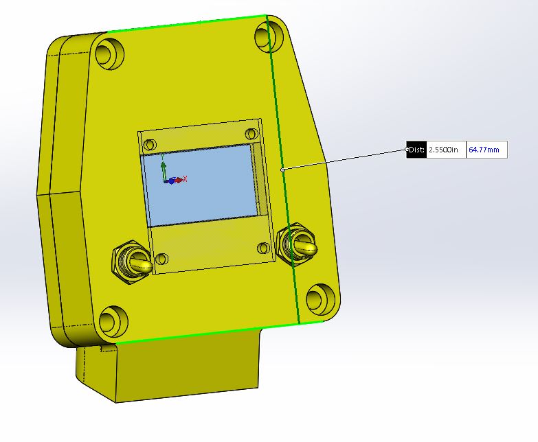

        • Itsy Bitsy display for ANPI
          I think I'm about done with this little OLED Display. I Just need to put it on at perf board and print the case.
          Discover the magic of the internet at Imgur, a community powered entertainment destination. Lift your spirits with funny jokes, trending memes, entertaining gifs, inspiring stories, viral videos, and so much more from users.
          I decided to give up on trying to make it small enough to go on the ANPI and just used a spare nano to run it. I set up the on board Nano to transmit the delay status and boost status over I2C when requested. Technically you could change the ANPI values through the display, but the knobs are already there.. Maybe next time.
          Connections:
          ANPI (A5) - Display Nano (A5) - OLED (SCL)
          ANPI (A4) - Display Nano (A4) - OLED (SDA)
          ANPI (VIN) - Display Nano (VIN) Thru Display power Switch - Voltage Divider
          ANPI (GND) - Display Nano (GND) - Voltage Divider - OLED (GND)
          ANPI (TP10) - Display Nano (A0)
          Voltage Divider (220K/100K) - Display Nano (A1) 5V=16V
          Display Switch (1) - Display Nano (D3)
          Display Switch (2) - GND
          OLED (VCC) - Display Nano (5V)
          I am not certain if I need pull-up resistors on the SCL/SDA lines. I think the display already has them so I didn't add them.
          Sorry I an lazy and don't want to draw a schematic. I can if someone really wants me too.
          I dont really like the case drew.. I will provide models when I'm done with it.
          Also I'm not sure how it will work in real world test... I will let you know when I get it mobile.
          Revised Code for ANPI and Display Nano attached. I just used the Adafruit OLED Library.. it works for me and I was tired of trying to make the other libraries work on the display that I have.
          OLED Test.zip
