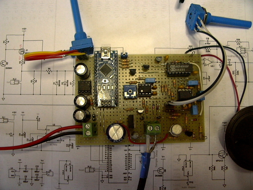

        • I'm starting to assemble a metal detector Arduino Nano...

          • Originally posted by Myntmaster View Post
            [ATTACH]56925[/ATTACH]
            [ATTACH]56926[/ATTACH]
            I do not recall using an an axe when I built mine.
            • Originally posted by MartinB View Post
              Or the finest aged resistors?

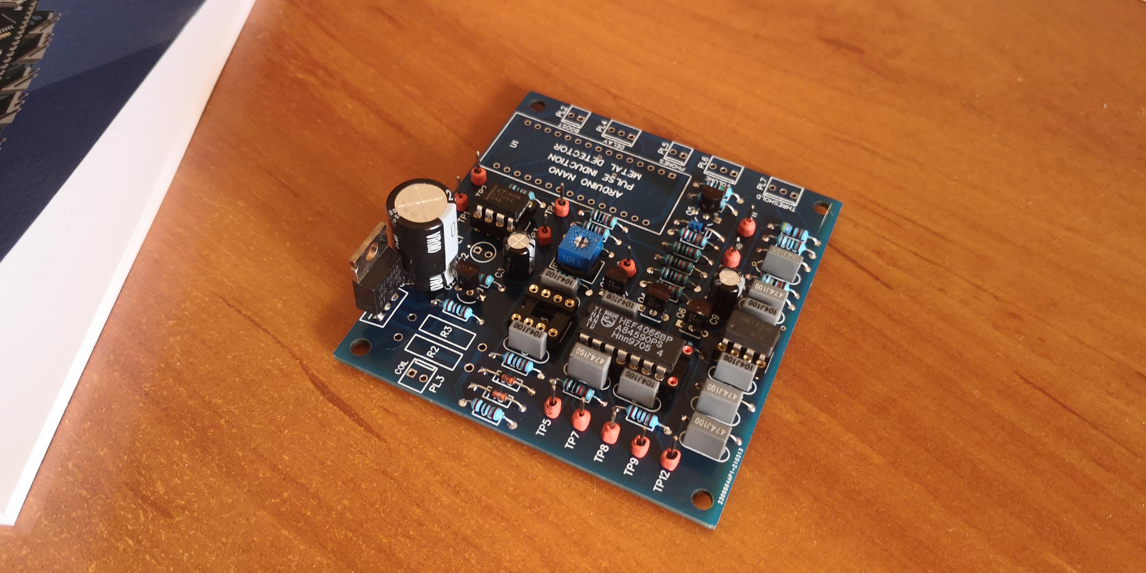

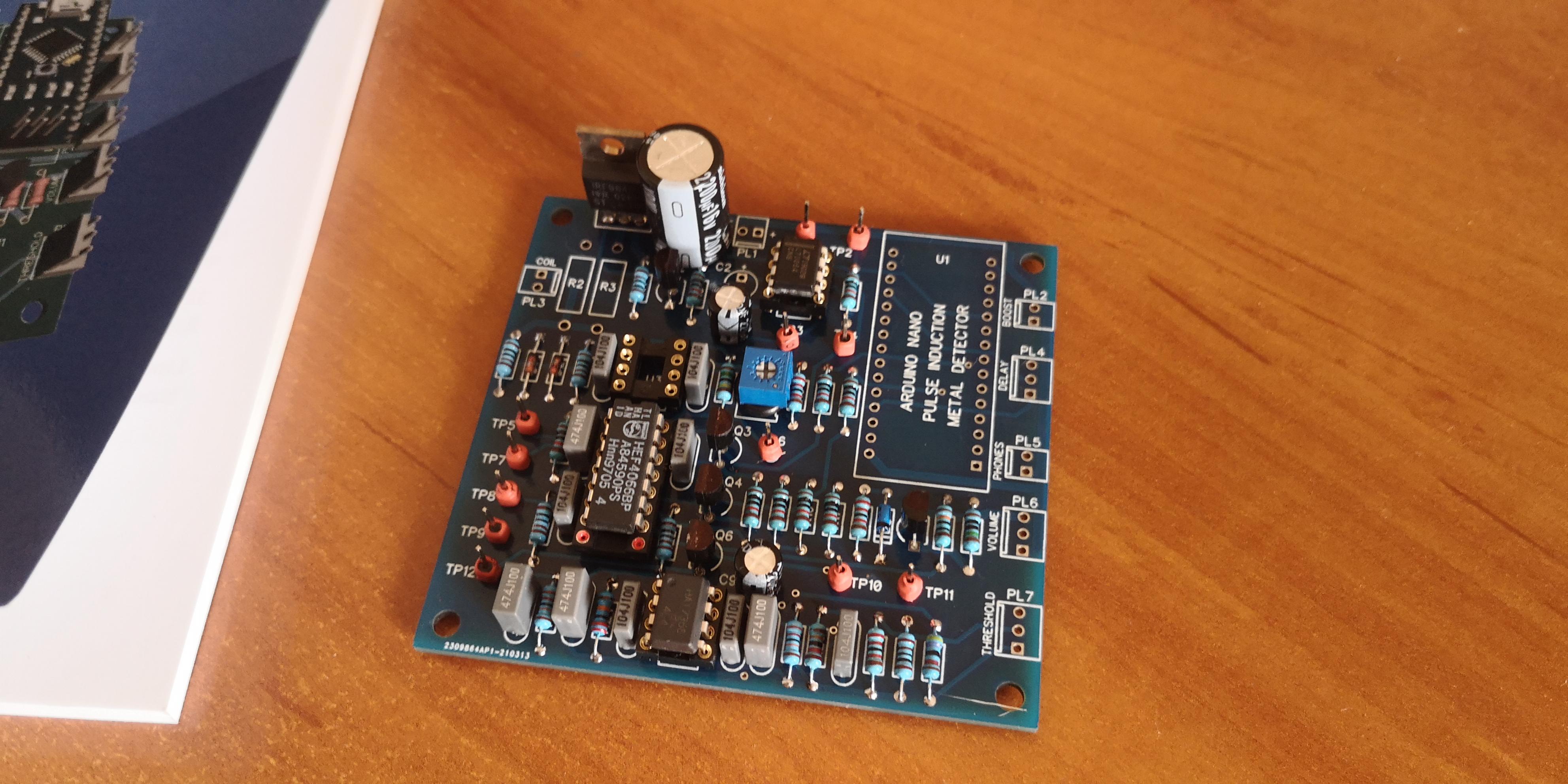

              • The ax is the most important thing in assembly. Well, I soldered the details to the board. The connectors and the Arduinos themselves have not yet arrived. All parts are checked for compliance with ratings. Estimated time was approximately 1.5 hours...
                  [ATTACH]56975[/ATTACH]
                  [ATTACH]56976[/ATTACH]
                  [ATTACH]56977[/ATTACH]
                  [ATTACH]56978[/ATTACH]
                  Looking good.

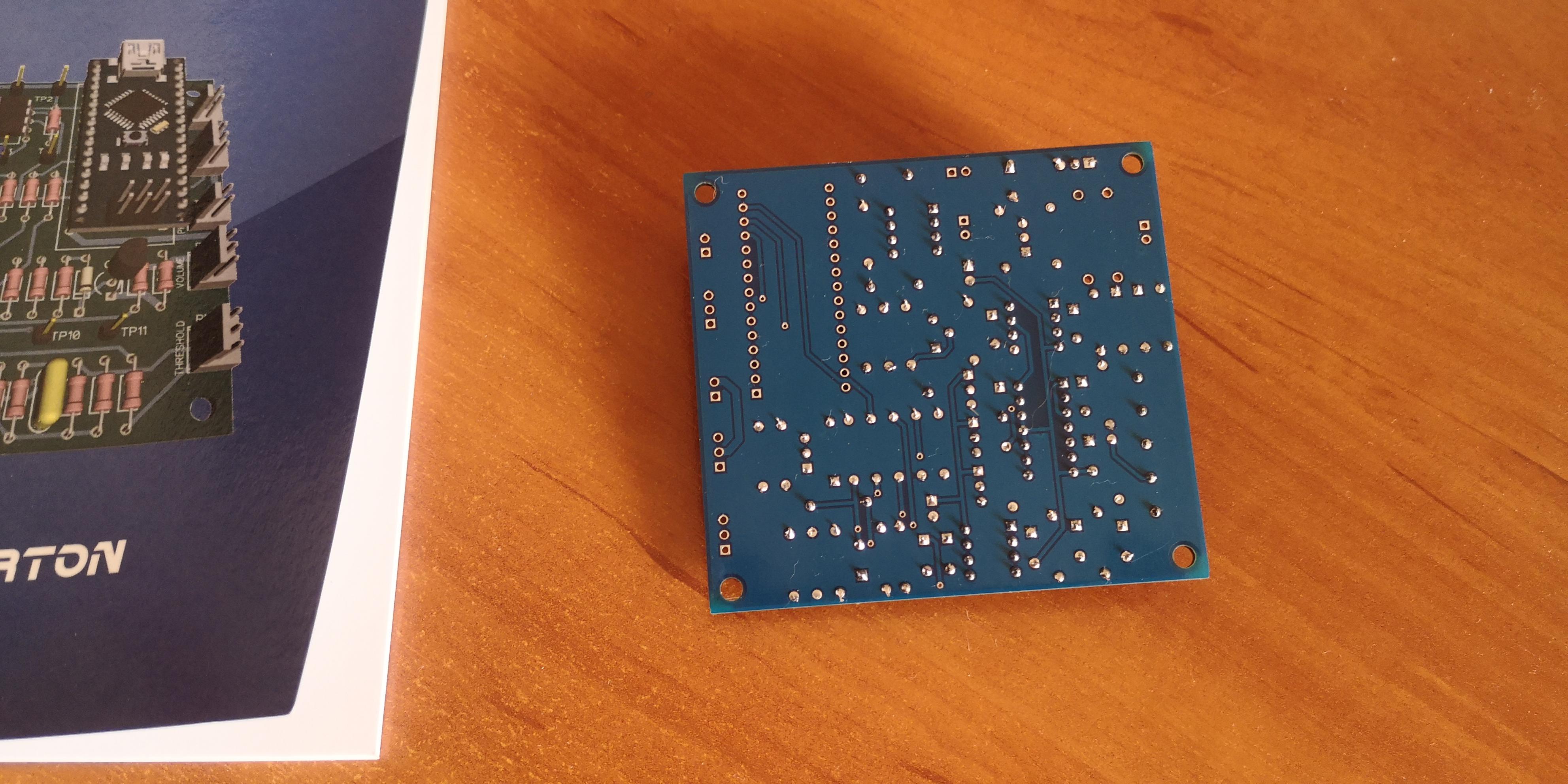

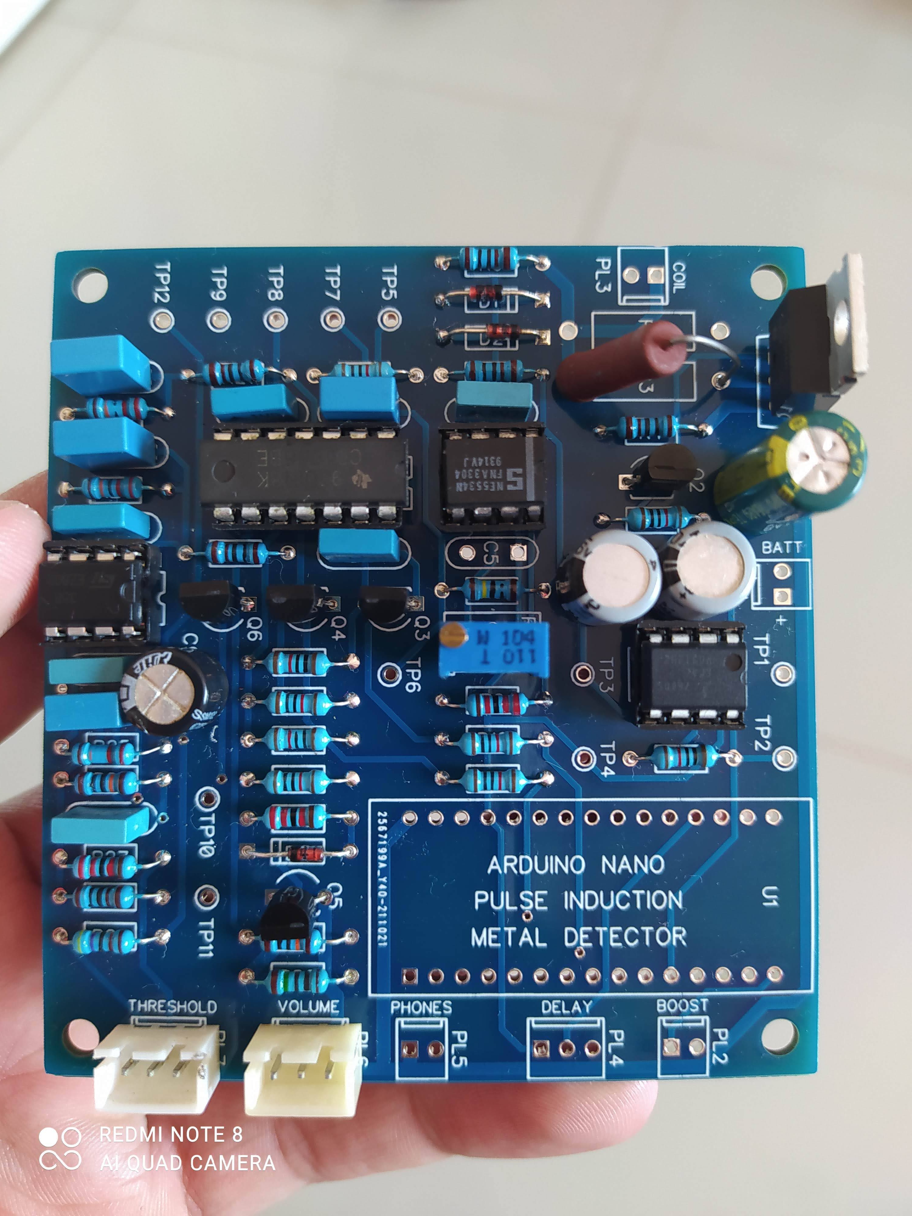

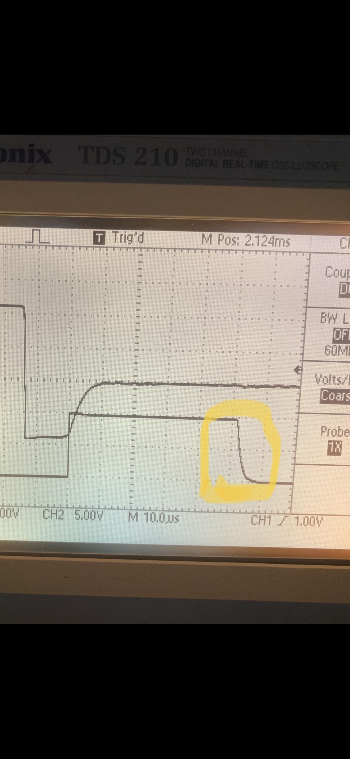

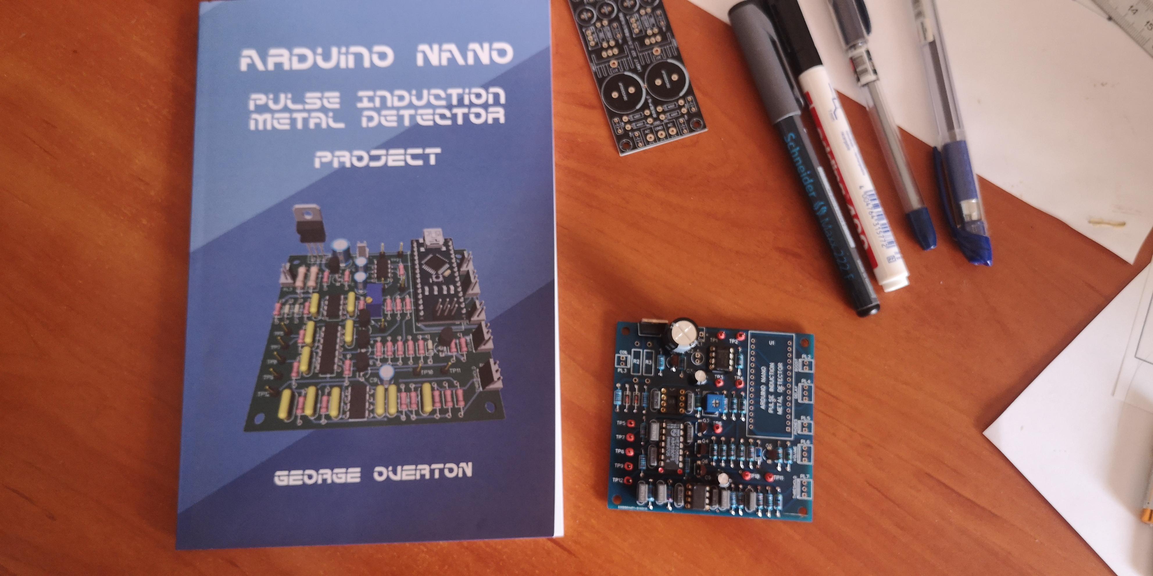

                  • I'm also assembling waiting for the arduino nano to arriveClick image for larger version
Name:	Arduino Nano Pi.jpg
ID:	362700 this have something to do with integrator caps? I use wima red ones. It can affect efe?

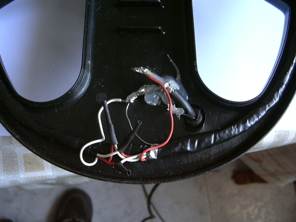

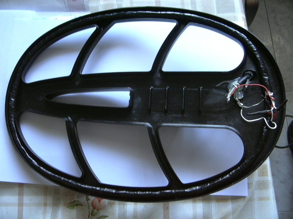

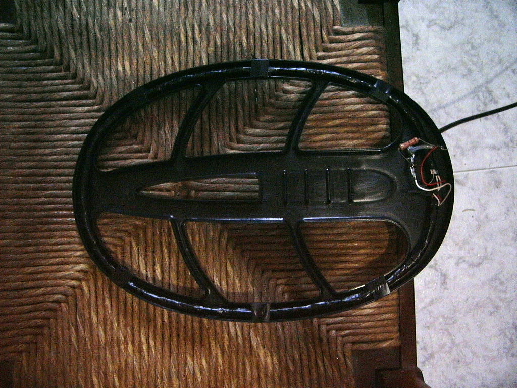

                              • telefonic 2x twisted pair twisted pair rolls between them, makes 3 full trips, then welds the start end to get a resistance of about 250 uH and 1.7 ohms.
                                the damping resistor in my case is 330 ohms.
                                elliptical coil size 30 cm x 21 cm
                                shielding with aluminum foil.
                                sorry google bad english
                                nice project Thanks George
                                Ciao Giovanni
