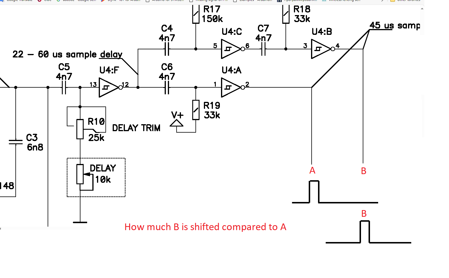

    The schematic you have posted is nothing to do with the Arduino Nano PI.
    It looks like the sample pulse generator for the old Baracuda PI (not the Geotech version).
    • Suggest an improved MOSFET FQA9P25 that has half the output capacitance Coss (170pF) of the IRF9640, that together with a fast coil will improve the device for small gold. The above is similar in all other respects.
