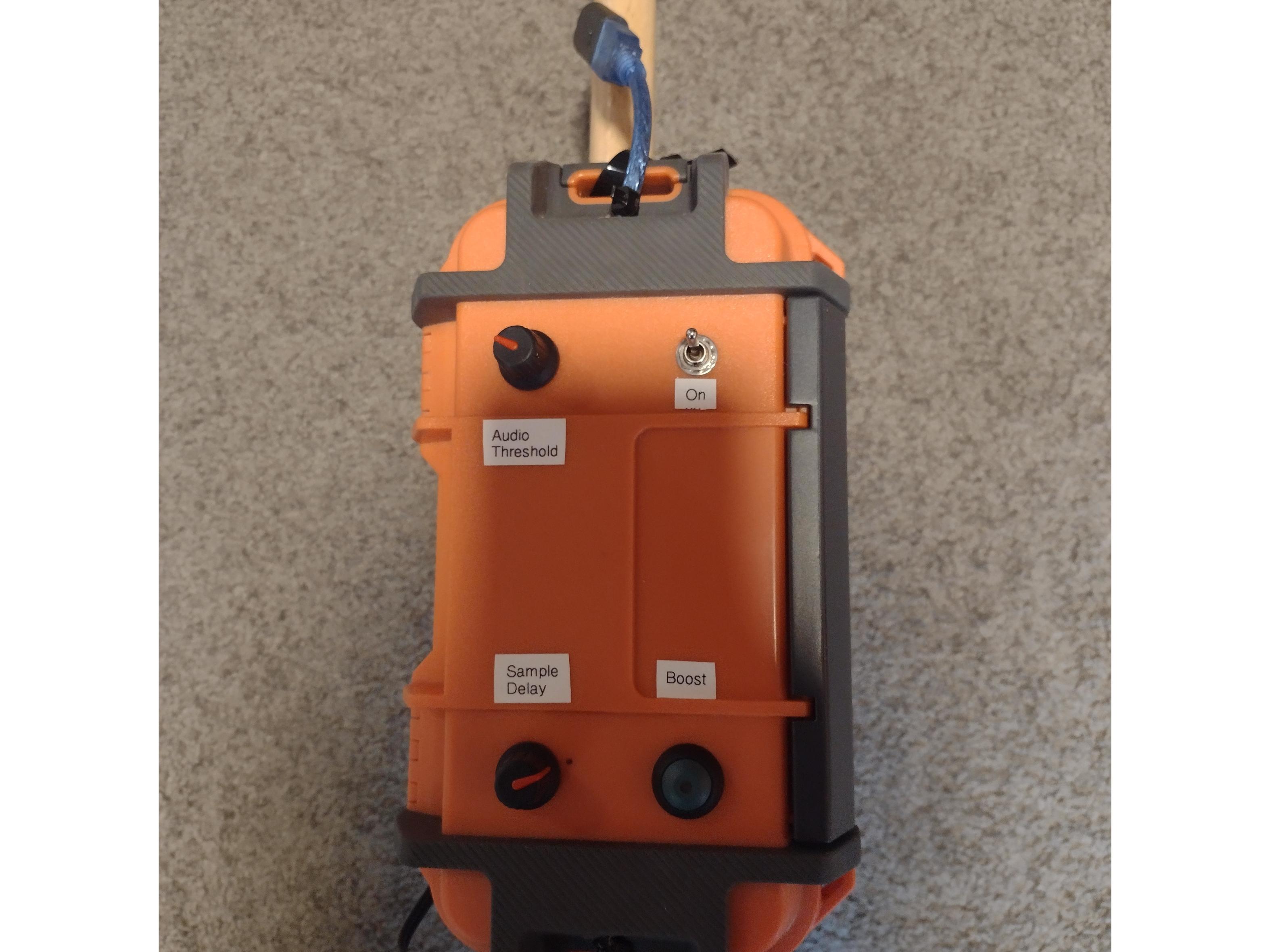

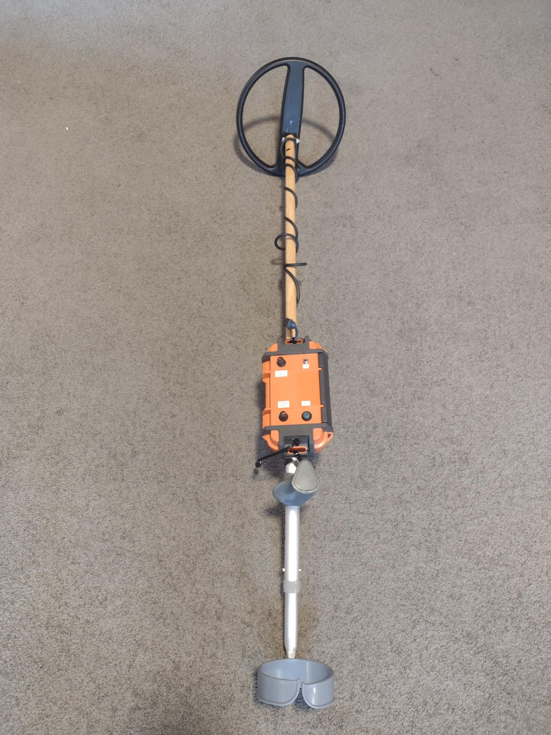

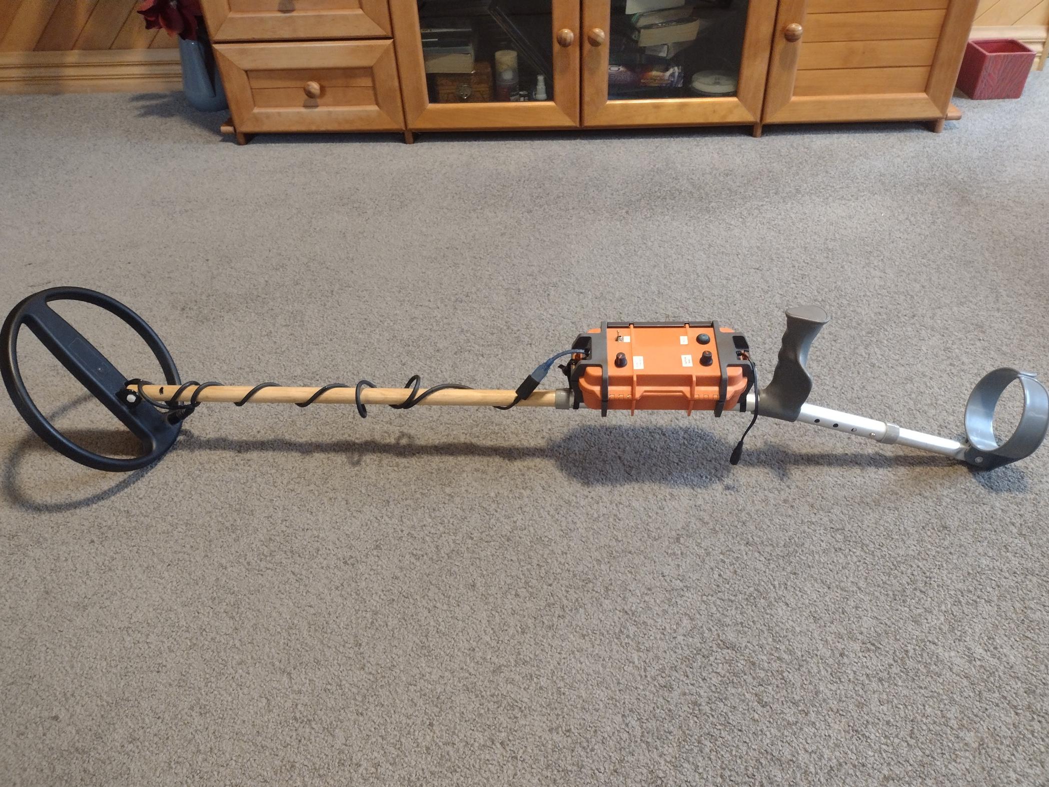

  • Click image for larger version  Name:	IMG_20240208_185627937.jpg Views:	0 Size:	545.2 KB ID:	420001Here is what my unit looks like. Also, I managed 40cm with my gold ring.
    The case is a waterproof clam-shell with an over-center clamp, and an o-ring seal.
    The handle is a cutdown walking stick ... just perfect ..
