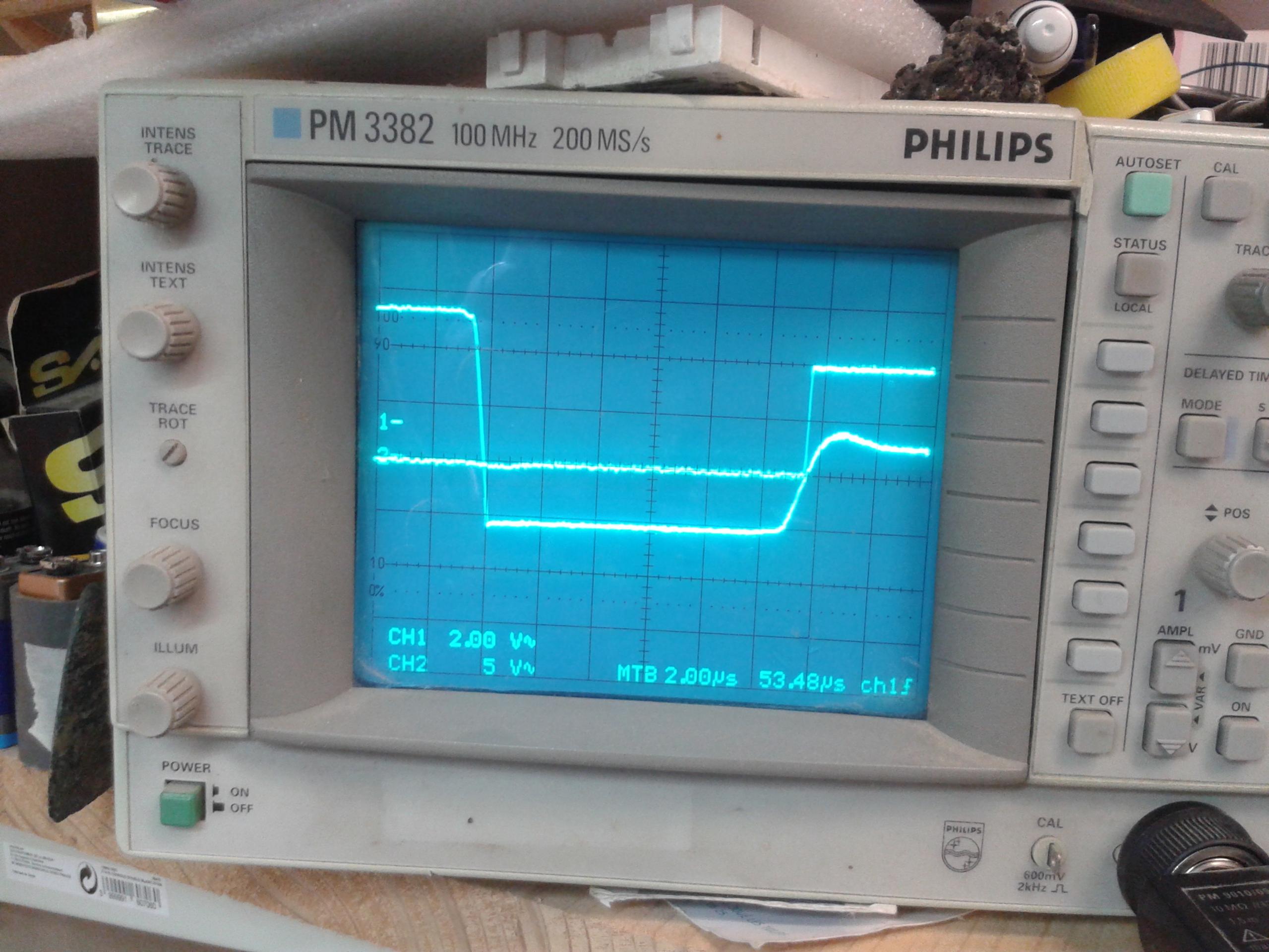

    no sorry, I don't make a demonstration video of my coils.. no you tube account or other..Click image for larger version
    damping oscillogram..

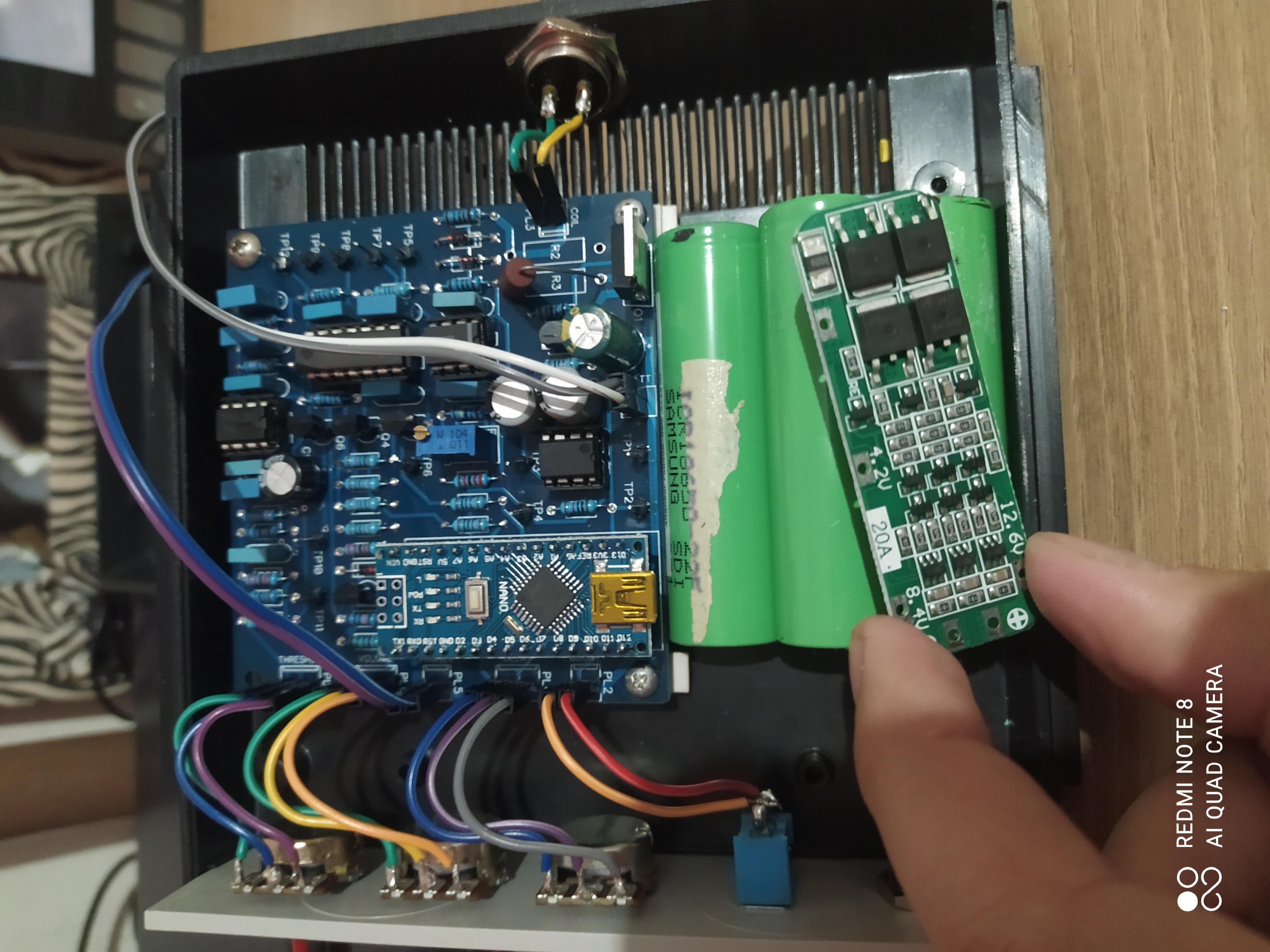

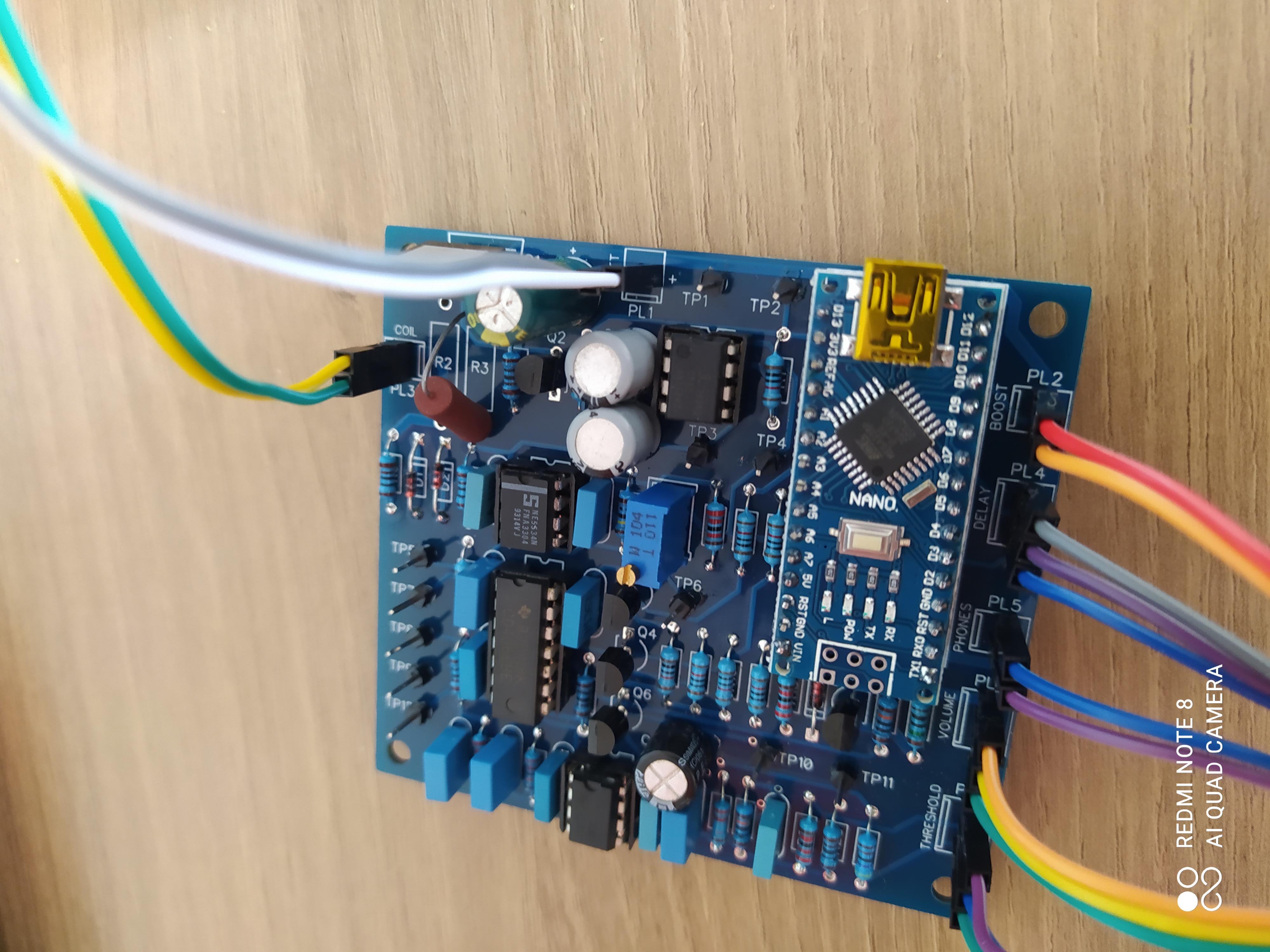

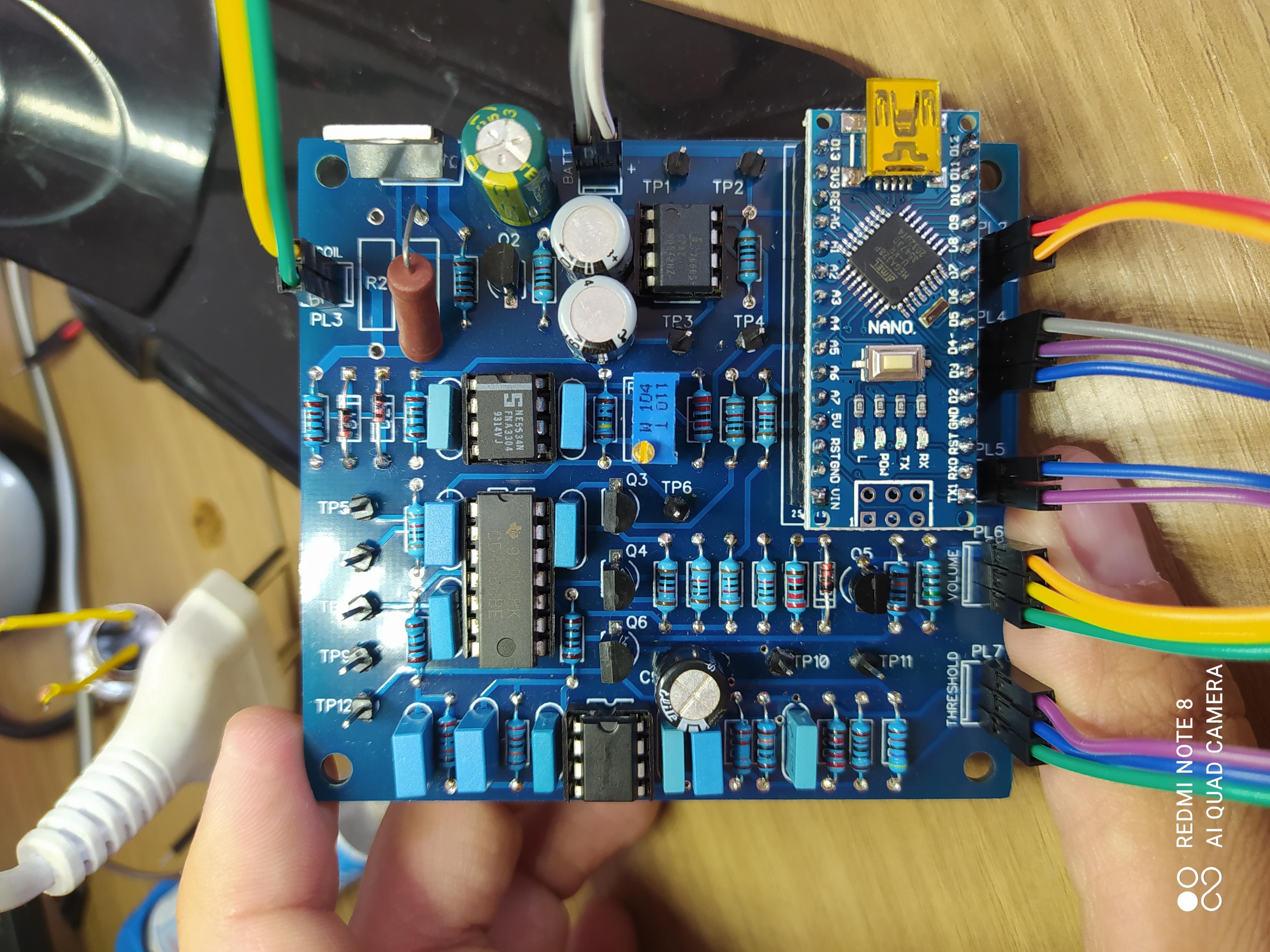

        • Originally posted by Emersonpaz View Post
          some pictures of my Arduino nano pi
          Wow those pictures are supper clear

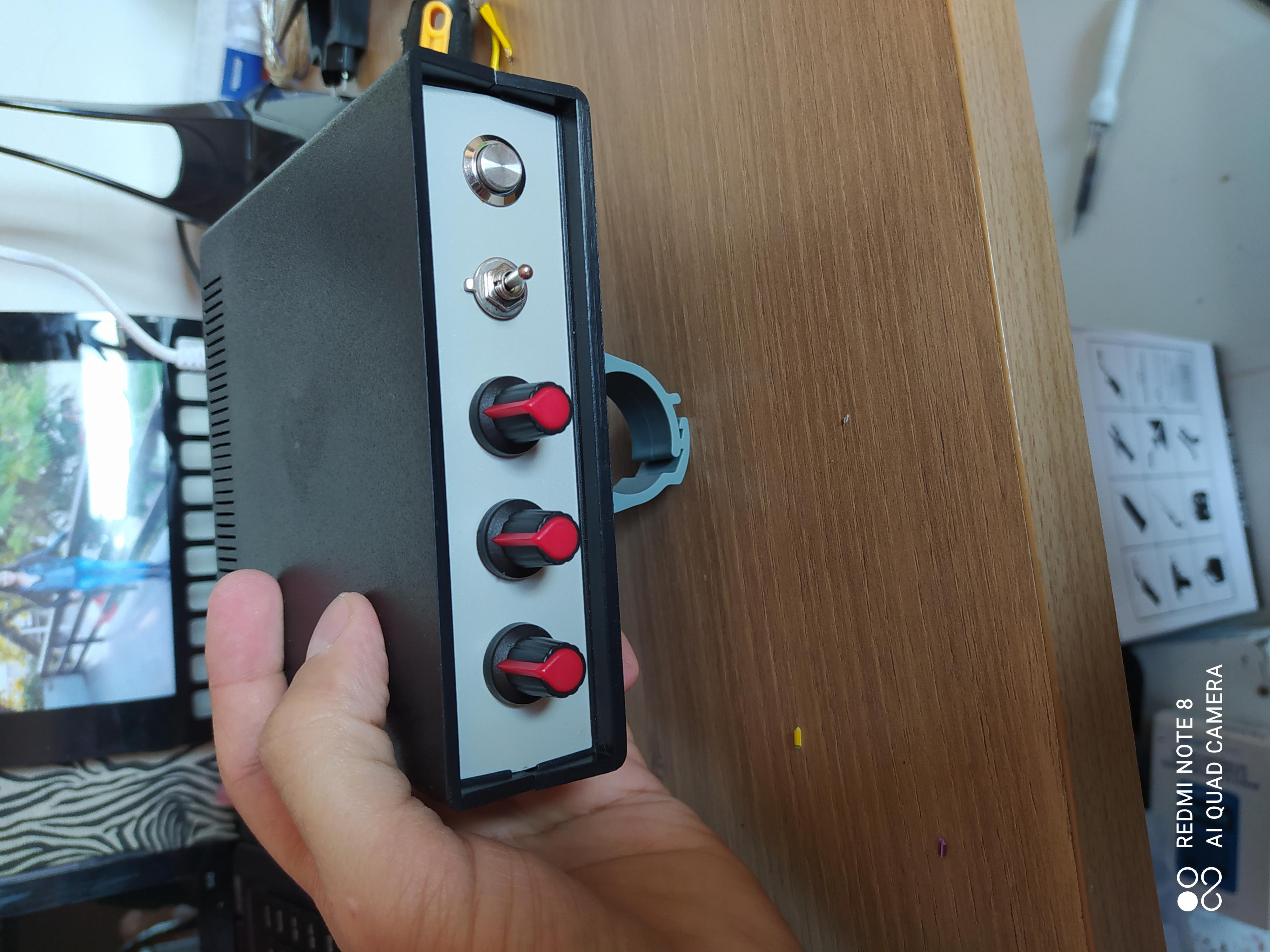

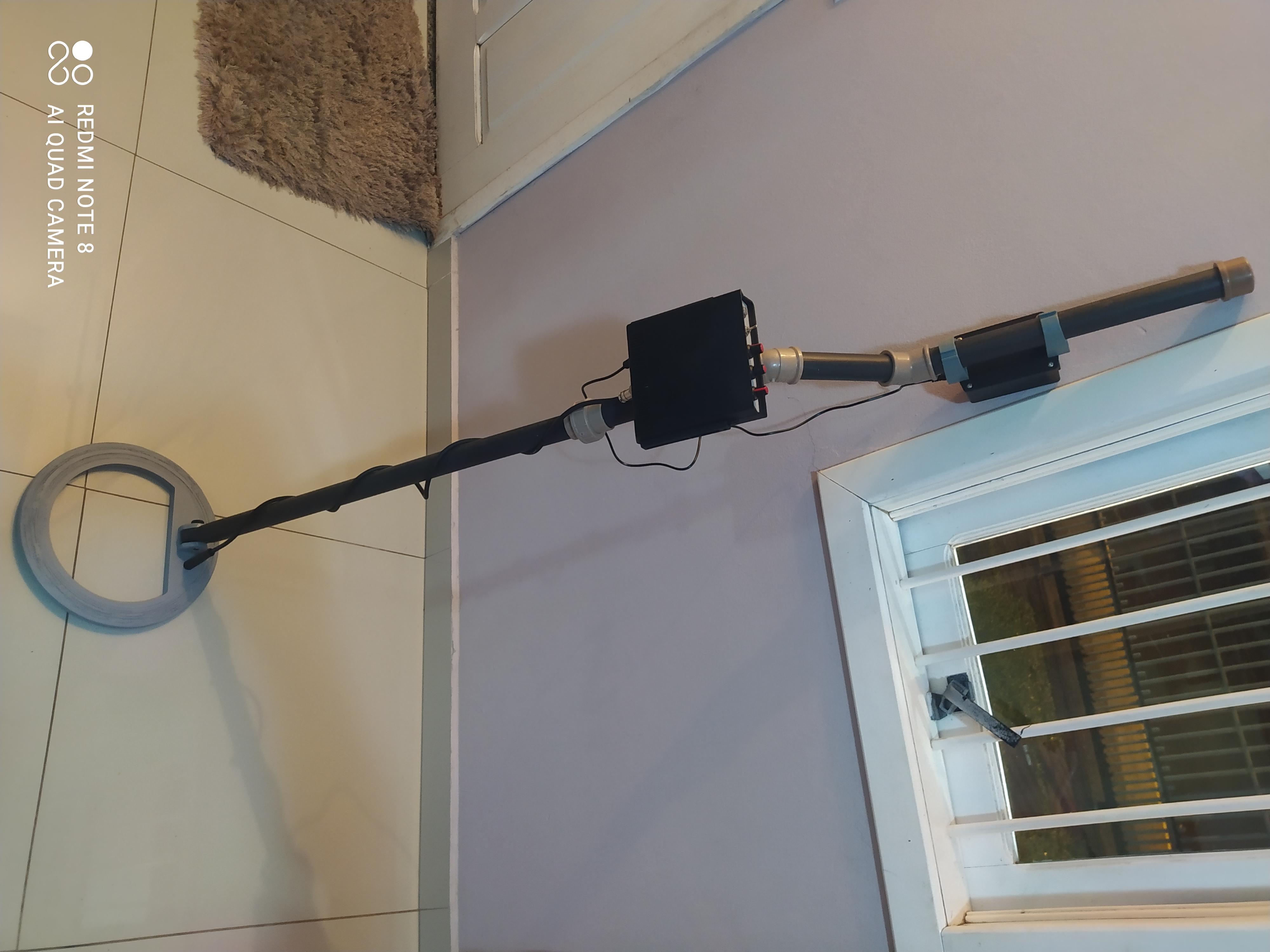

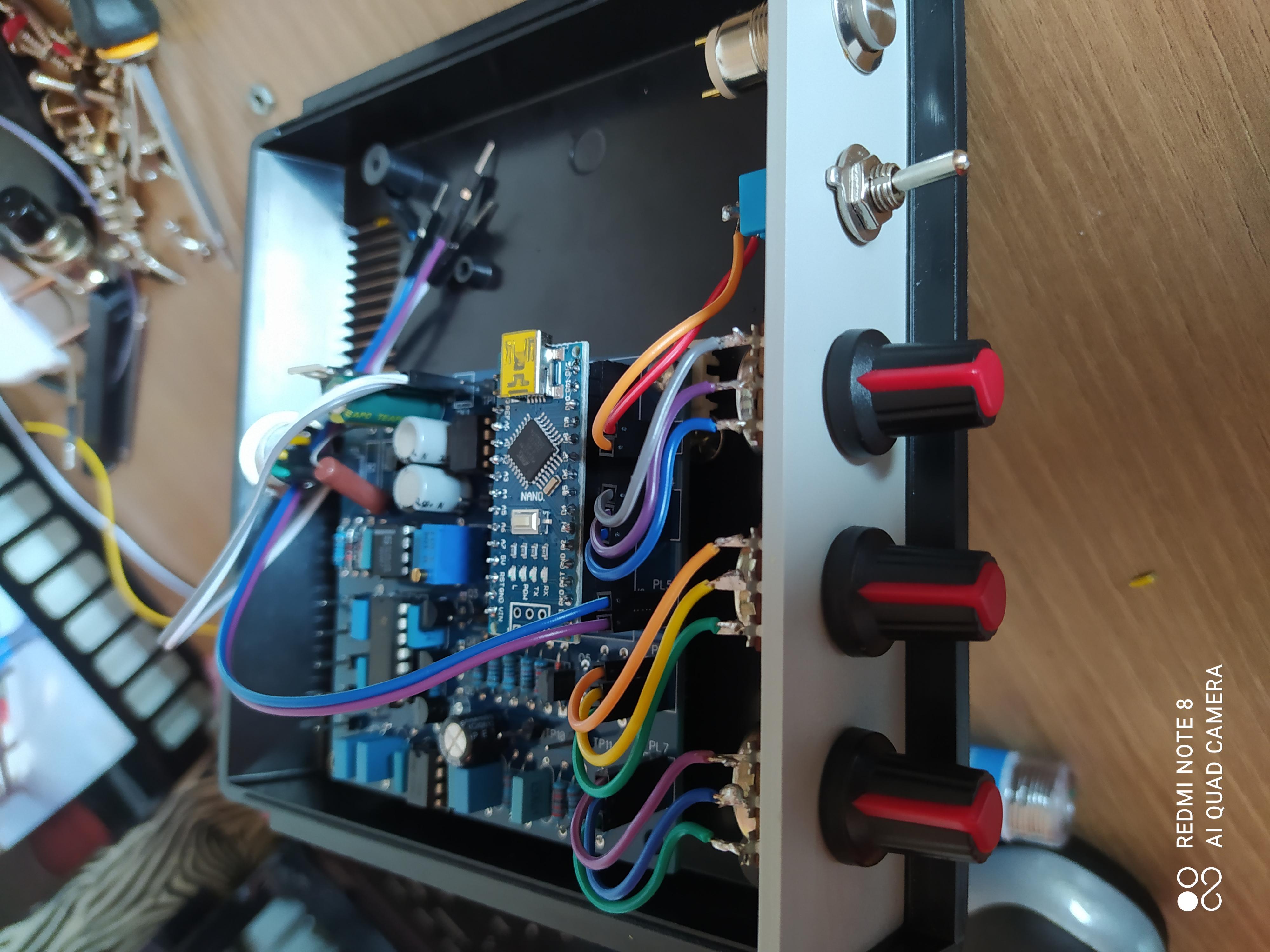

                  • @Emersonpaz,,,,Nice neat setup! Regards, Marty.
