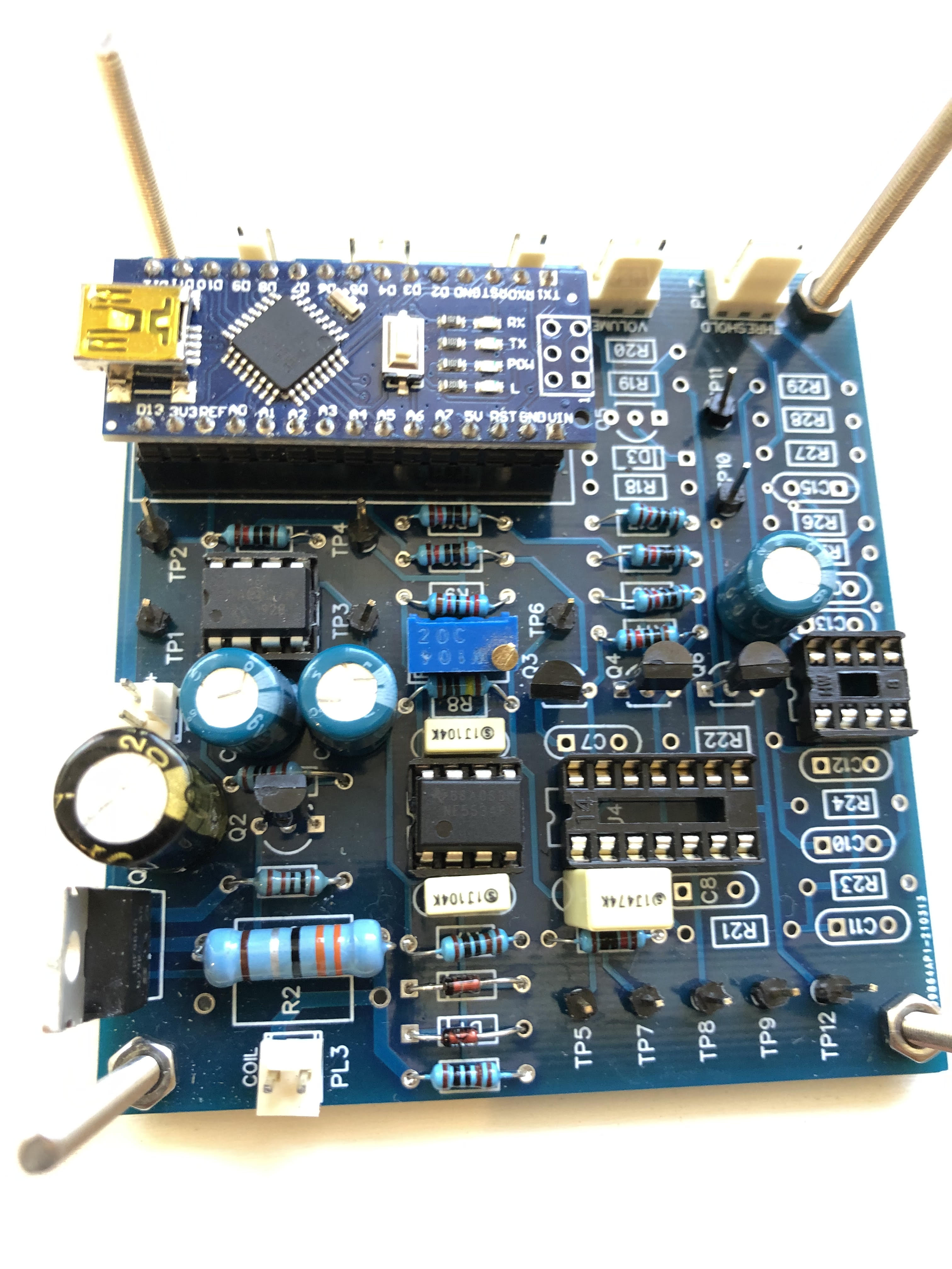

  • Hi I have built ANPI to the preamp stage but now I'm not getting -5v from TP3, I get circa -2.5v instead. When I remove the NE5534 I get -5v again. Could someone point me in the right direction? - I am a novice at this so any help would be appreciated?

      Are you building the ANPI on a PCB manufactured using the supplied Gerber files, or are you breadboarding the design?
      • I'm using the manufactured PCB I bought it from DiyDetector (used to be SilverDog I think)

          That's good, as it eliminates possible wiring errors.
          Have you tried swapping out the 7660?
          Also, I presume the 7660 is being clocked properly by the Nano?

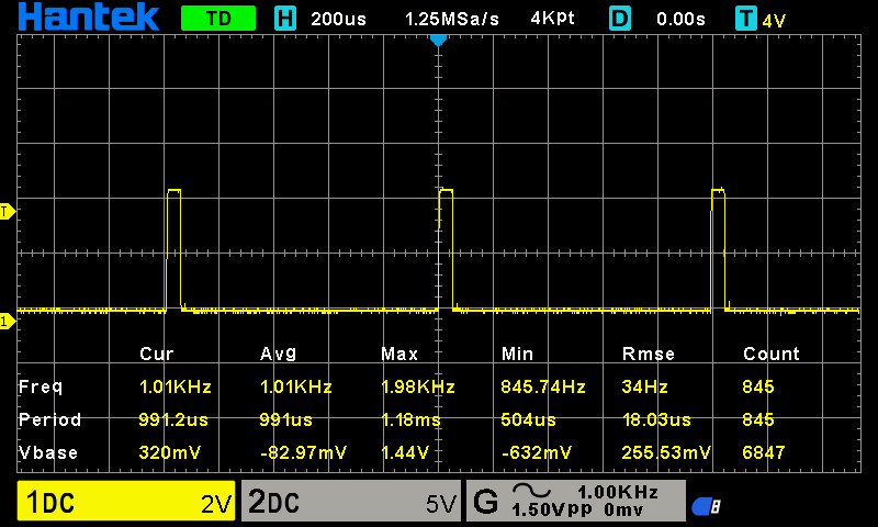

                  Two things:
                  1. Have you examined the signal at TP2 with an oscilloscope?
                  2. Can you post a clear photo of the PCB?

                    Hi, thanks for coming back to me:
                    1. Yes I have examined with an oscilloscope, output here Click image for larger version

                      Thanks for posting the details.
                      I cannot see anything wrong with the scope image or the PCB.
                      Where did you buy the 7660 ICs from? The symptoms still point to the voltage converter being a problem.

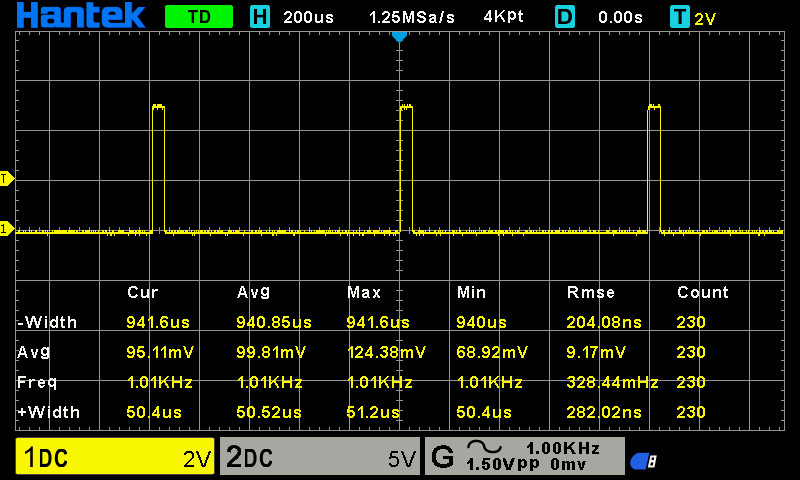

                          Can you post a scope image of the signal on pin 7 of U2 (7660) with R1 in-circuit?
                          The detector will work if the voltage converter is free-running, but (as it says on page 10): "If the voltage converter was allowed to free-run (that is, use its own internal oscillator) switching transients could potentially affect the receive signal".

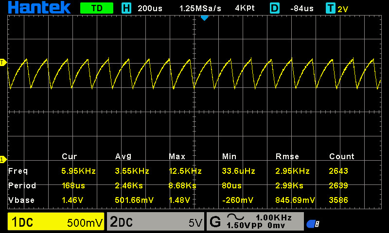

                            Here is U2 Pin7 with R1 removed Click image for larger version
                            Here is U2 Pin7 with R1 in-circuit Click image for larger version

                              It's must be a problem with the 7660 because your scope image (with R1 in-circuit) is the same as I see here.
                              Referring to the datasheet for the 7660, on page 8 it shows a series resistor of 1k, but I've never had a problem using 10K. It might be worth a try to reduce the value of R1 and see what happens.
