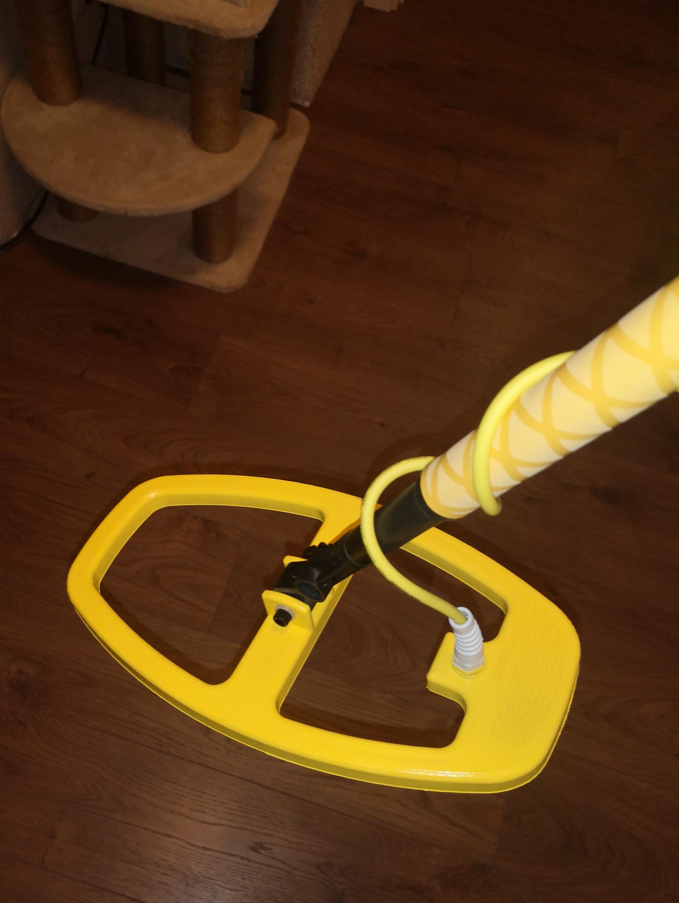

      • Hi all.
        While we are in winter, I decided to finish the postponed project.
        With this coil in air in VCO mode, 1 euro - 38 cm. Gold ring 14K 3 gr. 30 cm. In sand the same ring is 25-27 cm.

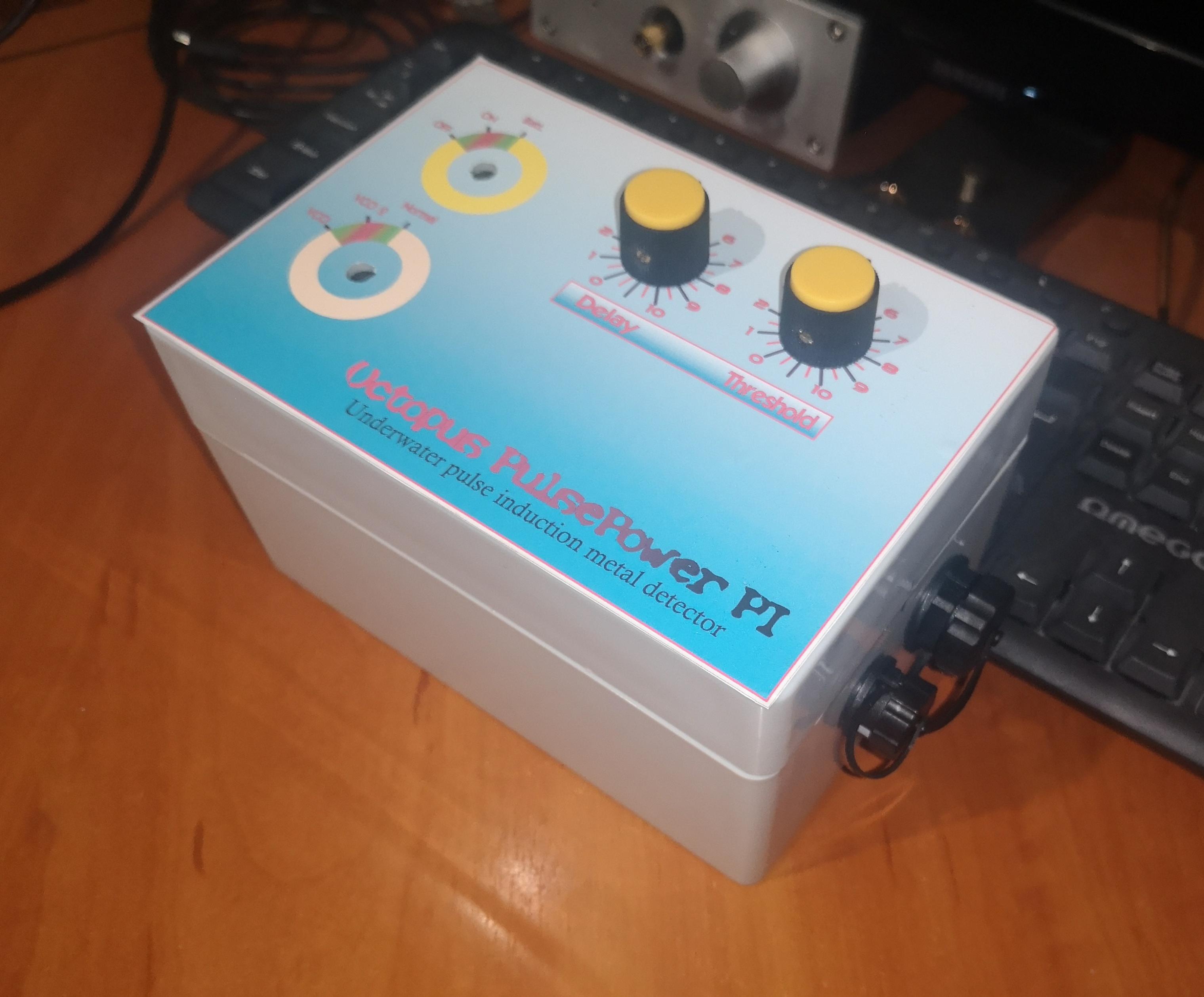

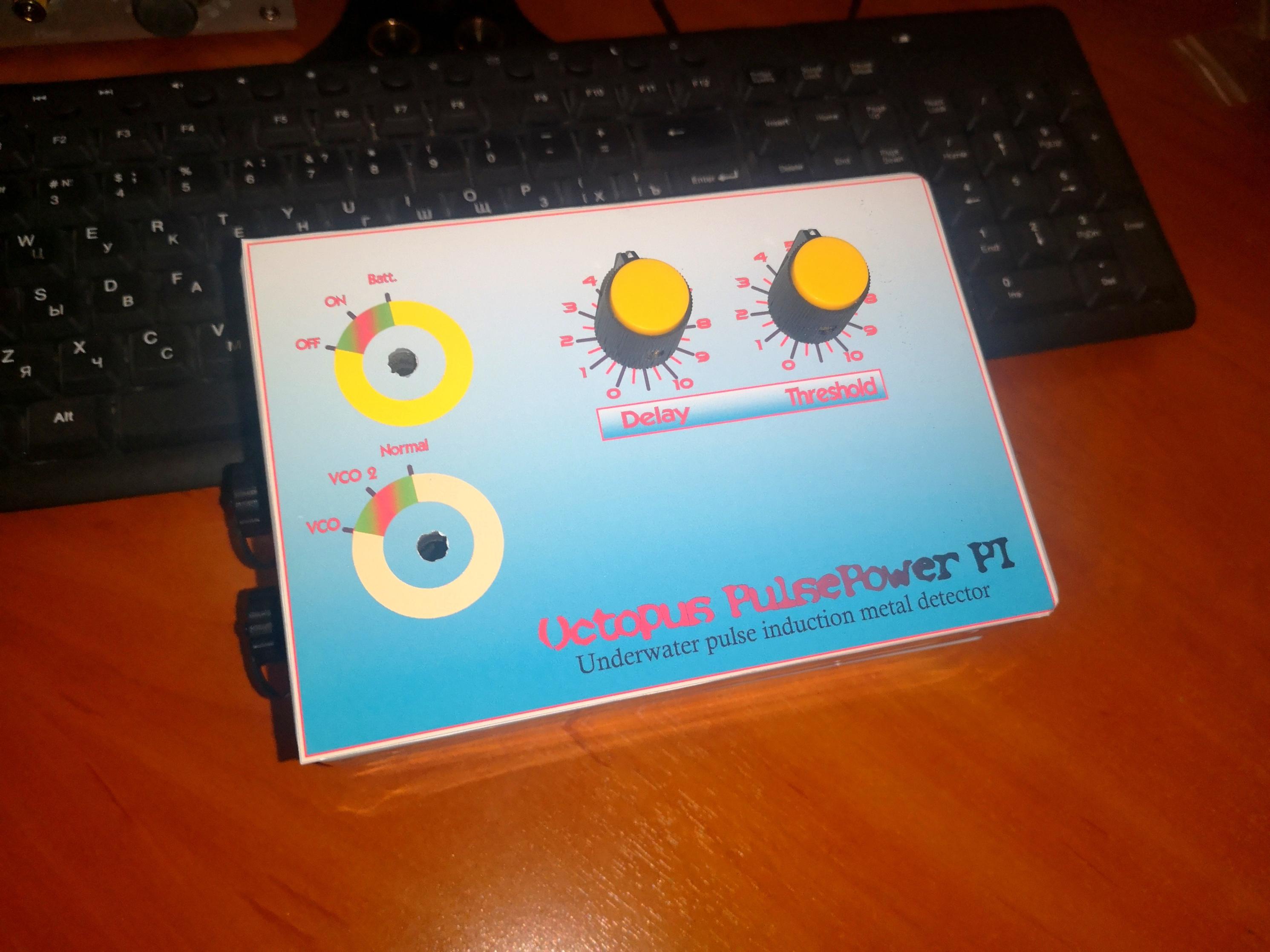

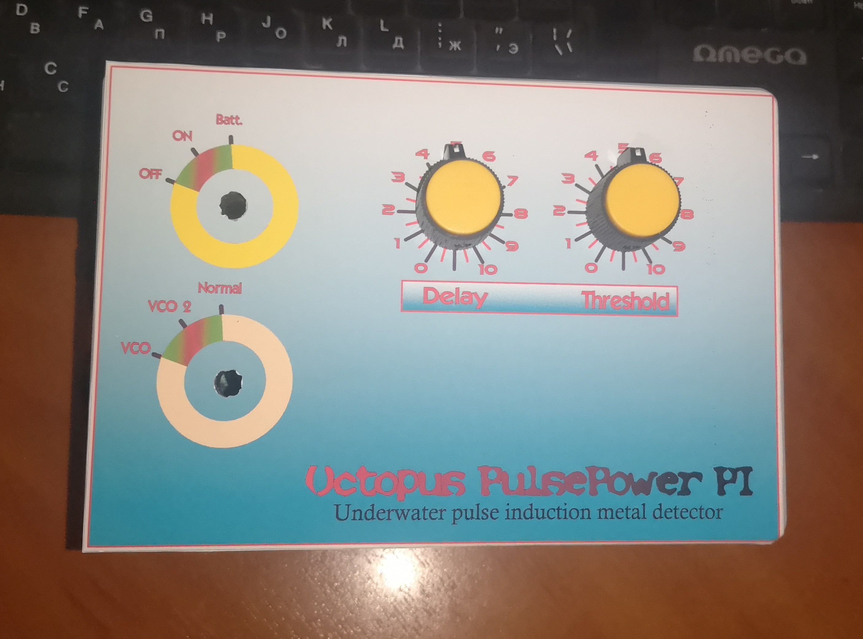

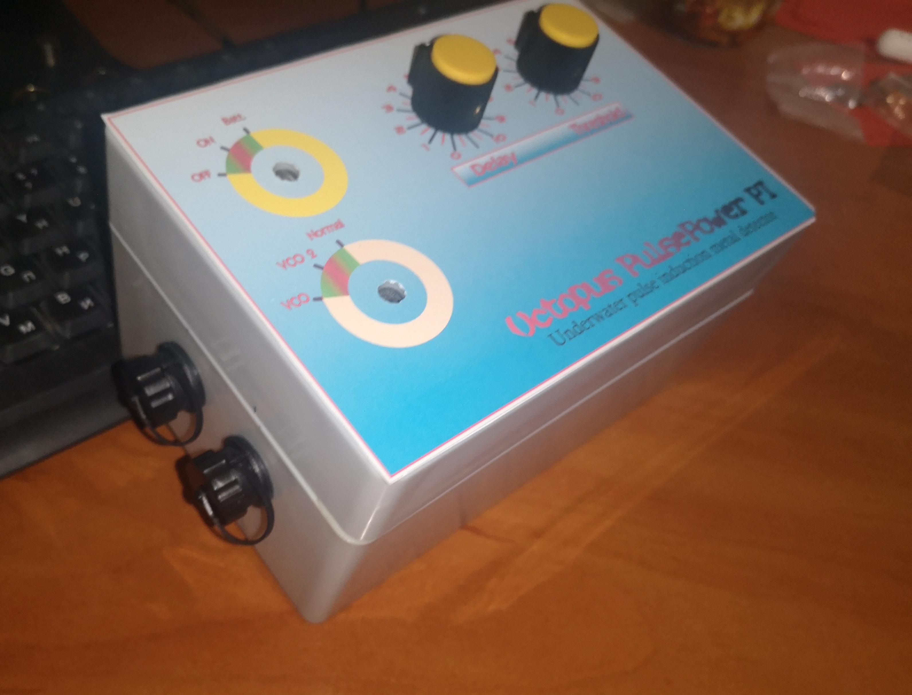

          • Front panel. The detector can be used underwater.
            Aliexpress sells a special A4 film. She's like a sticker. You can print on a regular inkjet printer. Does not wash off or wash off later. We print what you need and stick it on.​
            • The work is finished. Everything works. You can dive underwater.​

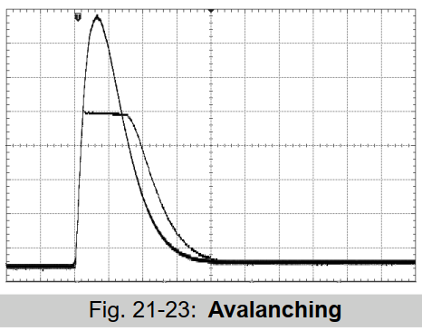

                        • Hi

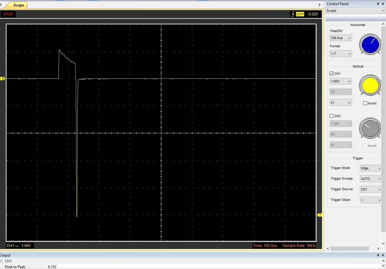

                          Wonder if someone could help with a basic problem. I'm building the detector for our local heritage society (Stamford Bridge UK); I'm at Step 7 Transmit Circuit of excellent book but I'm only getting circa 50v flyback rather than 200v. I've checked resistance values, component polarities and orientation etc. Using 9" 24 turn hook up wire test coil, changing number of coil turns by 30% doesn't change flyback greatly, so suspect Q1 Mosfet is the problem or fault in board. Attached screenshot of osc reading using 10x probe, Vpp is only 60v.
                          Apologies in advance if I'm missing something obvious, electronics experience very rusty!
                          Thanks in advance
Name:	Screenshot 2025-01-20 182327.jpg
                          • Try to zoom in on the flyback to see if it is avalanching. Here is a plot of avalanching vs non-avalanching:
                            Another way to tell is to vary the TX pulse width and see if it also alters the flyback peak.

                              What scope are you using? It looks a software-based unit, possibly connected to a sound card?
                              Is it fast enough to capture the peak flyback, or maybe limiting the maximum input displayed?
                              • Thanks Carl and Qiaozhi for your prompt replies, As you say scope is a PC-Oscilloscope (Hantek 6022BE), it had crossed my mind that the speed may be an issue. I'm tied up today but will try to look at the avalanche later; although I suspect that the speed may also be an issue in seeing that also. I guess I could proceed with project cautiously and come back to this stage if there is an issue.
