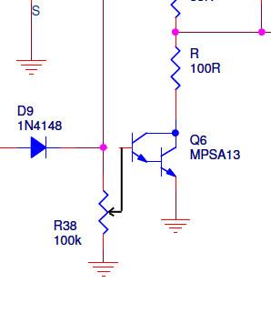

            I have the same problem with my IDX
            Thought about adding a volume but this would reduce the faint signals as well
            What is need is a audio limiter that does not affect the lower volume sounds but all above a certain volume is cut off without affecting the quality of the tone.
            Did find some commercial one to stop kids from damaging the ears playing music too loud but they were expensive. Others just chop the volume with a diode so the tone is affected. Have to have another look as some fields full of plow shear makes my ears buzz
              use IC's amplifier. too low price mc34119.
                This is interesting. A search for other opamp with disable pin gave LTC6091. But I wonder if it could be done with simpler components ?
                  http://mickael.devisschere.free.fr/p...imiter_prj.htm
                  Seems some kids headphones already have the limiter built in. Probably not worth making if we can find a pair of headphones that are of sufficient quality
