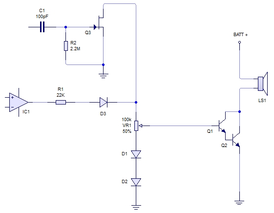

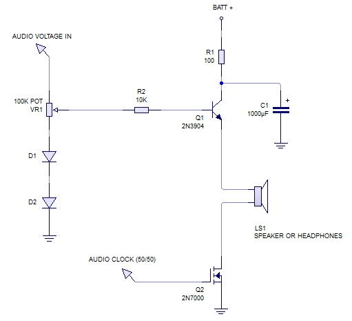

I have attached a pic below to modify detectors audio response.
its quite simple, and it works !!
done this on my last 2 detector designs.
basically add the 100k pot for volume,
this is set for your preferred MAXIMUM volume level.
the diodes on the volume pot that goes to earth serve to allow a MINIMUM
volume to pass without being regulated by the volume pot.
so sets your minimum volume.
2x diodes is about 1.1 volts,
after which point the volume pot starts to limit.
this allows faint signals to pass un hindered .
depending on preference any number of diodes (1,2,3,4) can be added in series,
dependant on the headphones used,
personal deffness etc......etc......
picture shows rough version of the barra audio,
that many different versions out there,
I just picked the 1st I came to.
enjoy.
