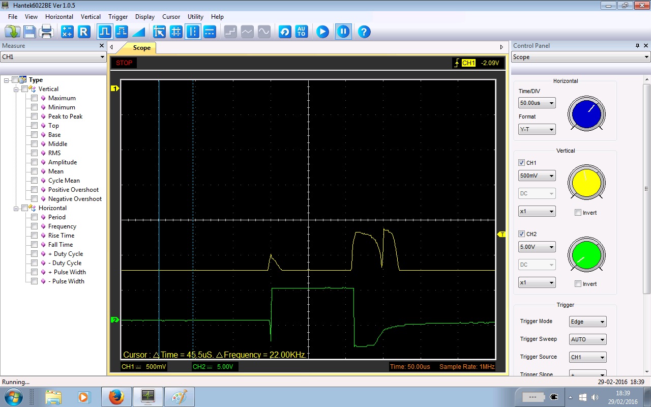

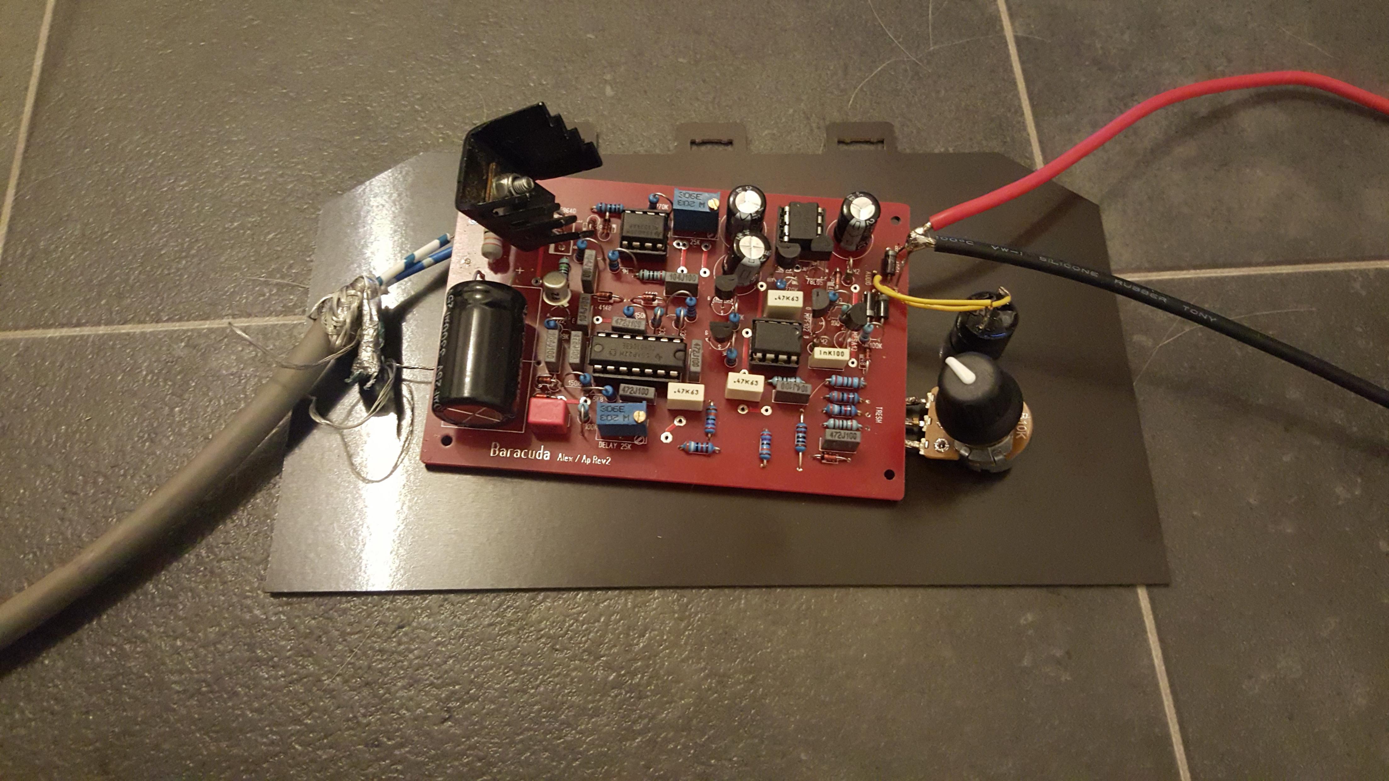

  • Try it at max delay. It still appears that the sample pulse generator is not quite right. Did you check for the shorting resistors I mentioned above? If you have then let me know and we can try to debug that circuit.
    • yep i have checked the resistor clearances i have also tried a new 412cn 7660 5534 nothing changed the circuit is at max trim delay

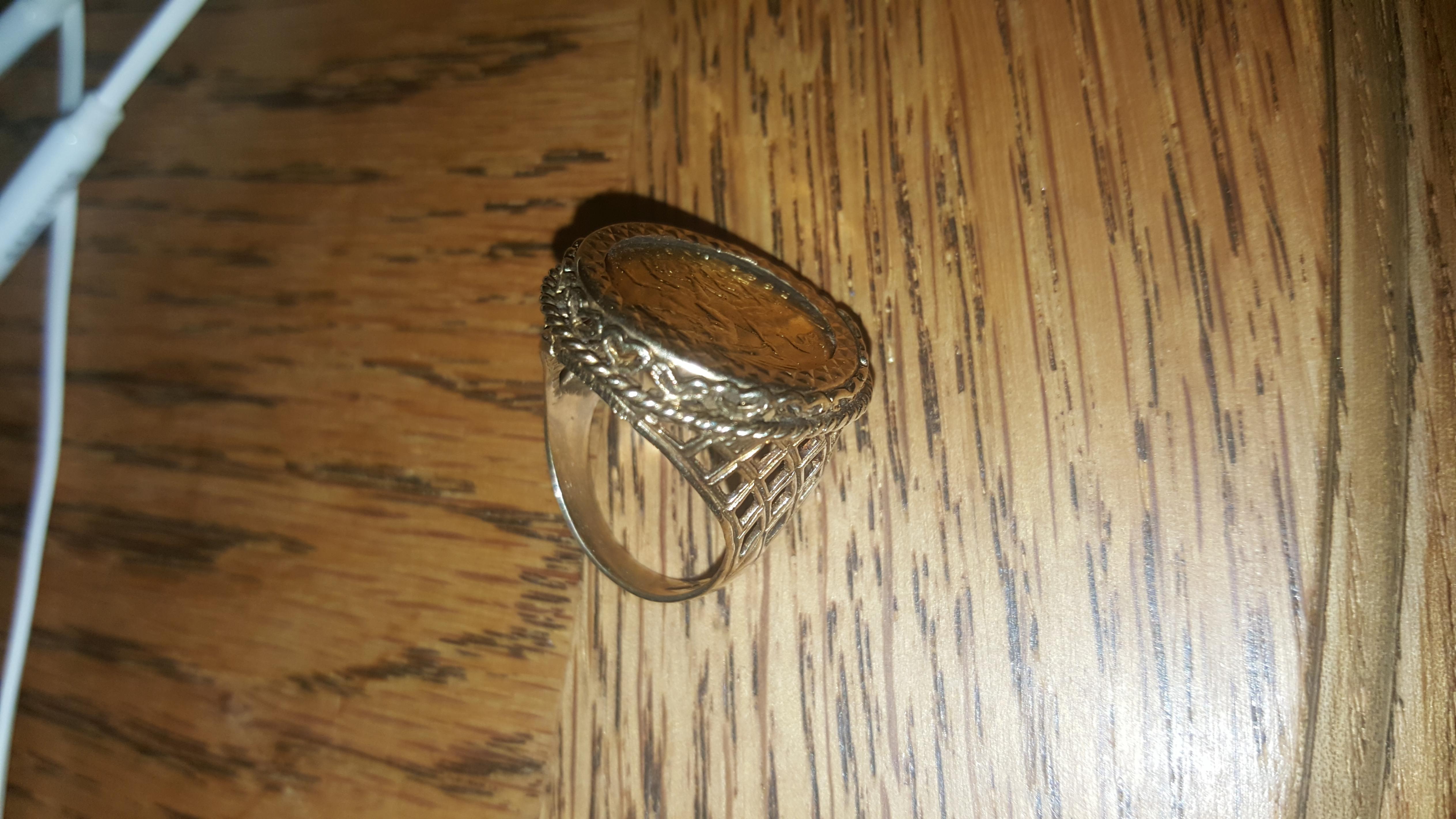

      • Sorry meant depth test...if you have time we can debug now.
        • ok i have time, use a ring for the depth test Click image for larger version

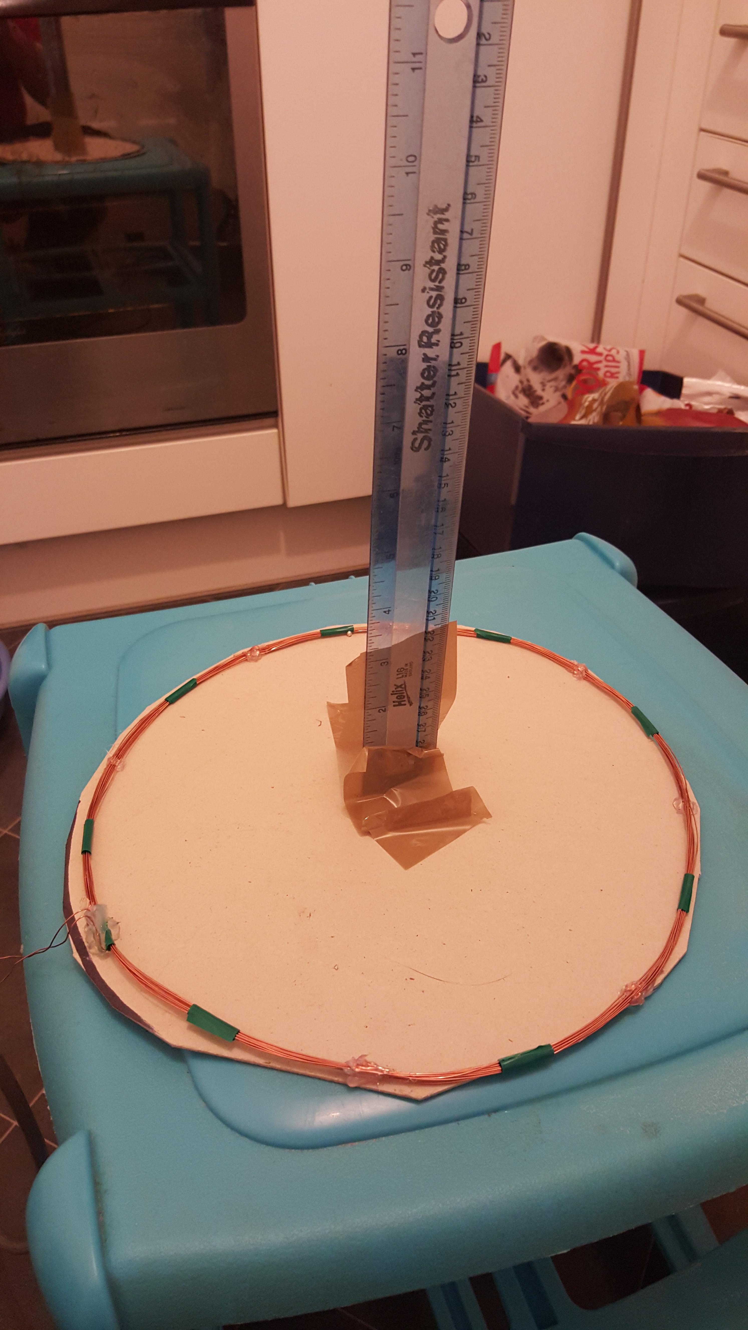

          • here is the setup
            with nothing changed i have 4" clear signal, 5" almost and 6" slight
            • What are you using for a speaker? Do you run it with a threshold ( low steady tone).
              • the speaker is the buzzer i had in the kit and yes the threshold is just before the constant tone (stable)

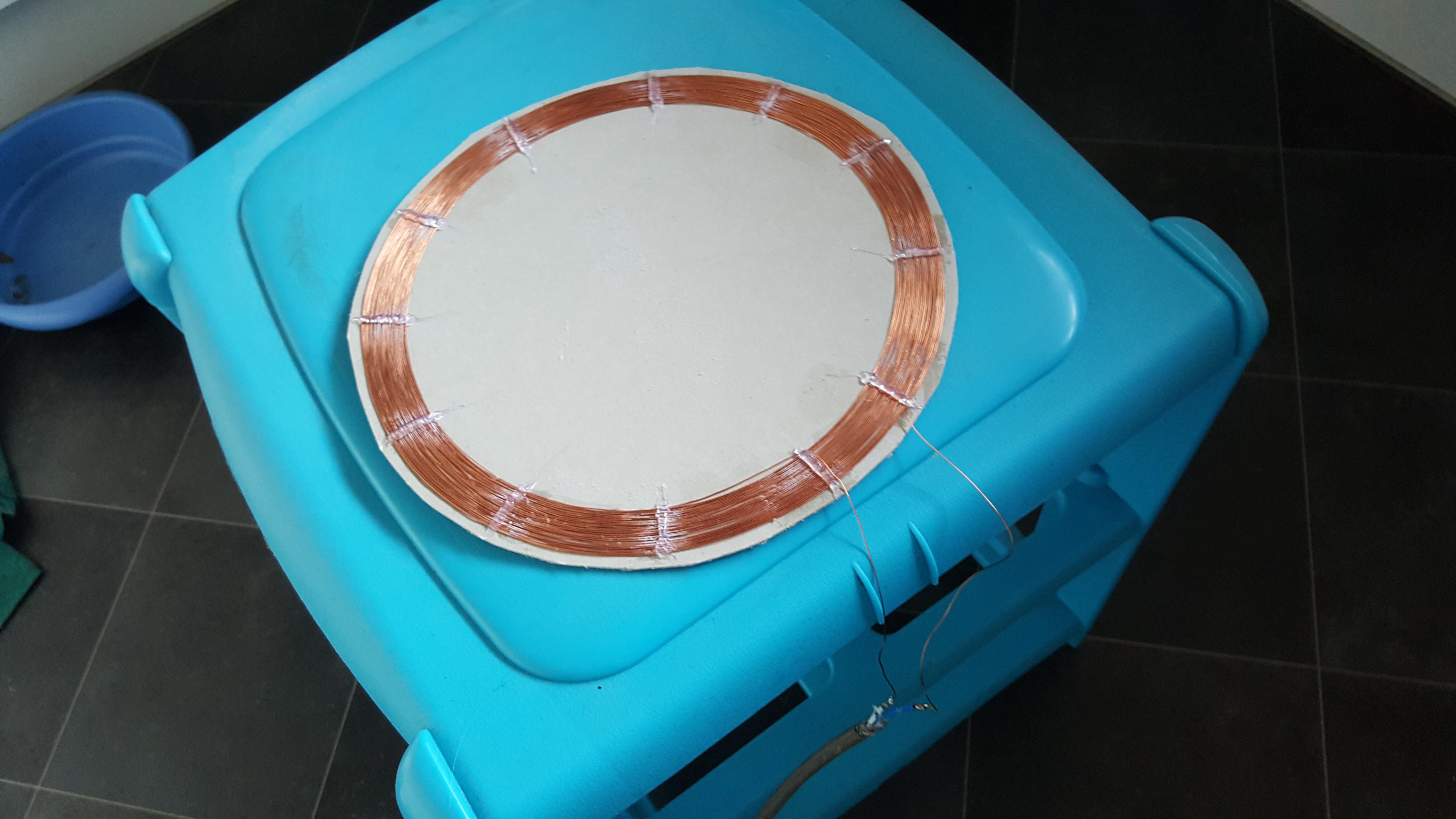

                        Hi impulse! I suggest you to make another coil in order to optimized the barracuda power. Spiral wound, spider wave and 3dss coil is far more better. 8" - 10" diameter is good.
                        • hey guys i have made a new coil (took ages) its a spiral wound 9.8" OD 27winds 313uH (as per online calculator) i am going to test it soon but the washing machine is going and it is upsetting the hole thing.
                          heres a pic Click image for larger version

                            • Originally posted by Impulse View Post
                              yes detector is working not great but is working
                              1k - [ATTACH]35344[/ATTACH]
                              Max - [ATTACH]35345[/ATTACH]
                              OK, this still does not look right. Put delay at center rotation.
                              Ch1 on 40106 pin 8 for all images, trigger off channel 1.
                              Take the following 5 images, include ch1 and 2 in each image at 50uS
                              pin 12, 2, 6, 4 then take one more shot of the last setting at 200 uS/ div.
                              Unless the sampling is working properly nothing also will get you max depth.
                              • ok so trigger to ch2? as i cannot turn it off?
