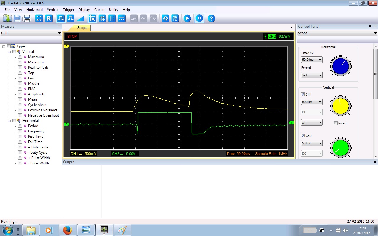

    ok i have circled pin2 of the 40106 or the test point i used and where i think Junction c11 and r20 is? by jumpy i mean the small pos blips are moving around the top of the pulse erratically and it is hard to see what any adjustment is doing.
    here [ATTACH]35318[/ATTACH]
    and here is the list i have [ATTACH]35319[/ATTACH] just so that you can see what i am referencing

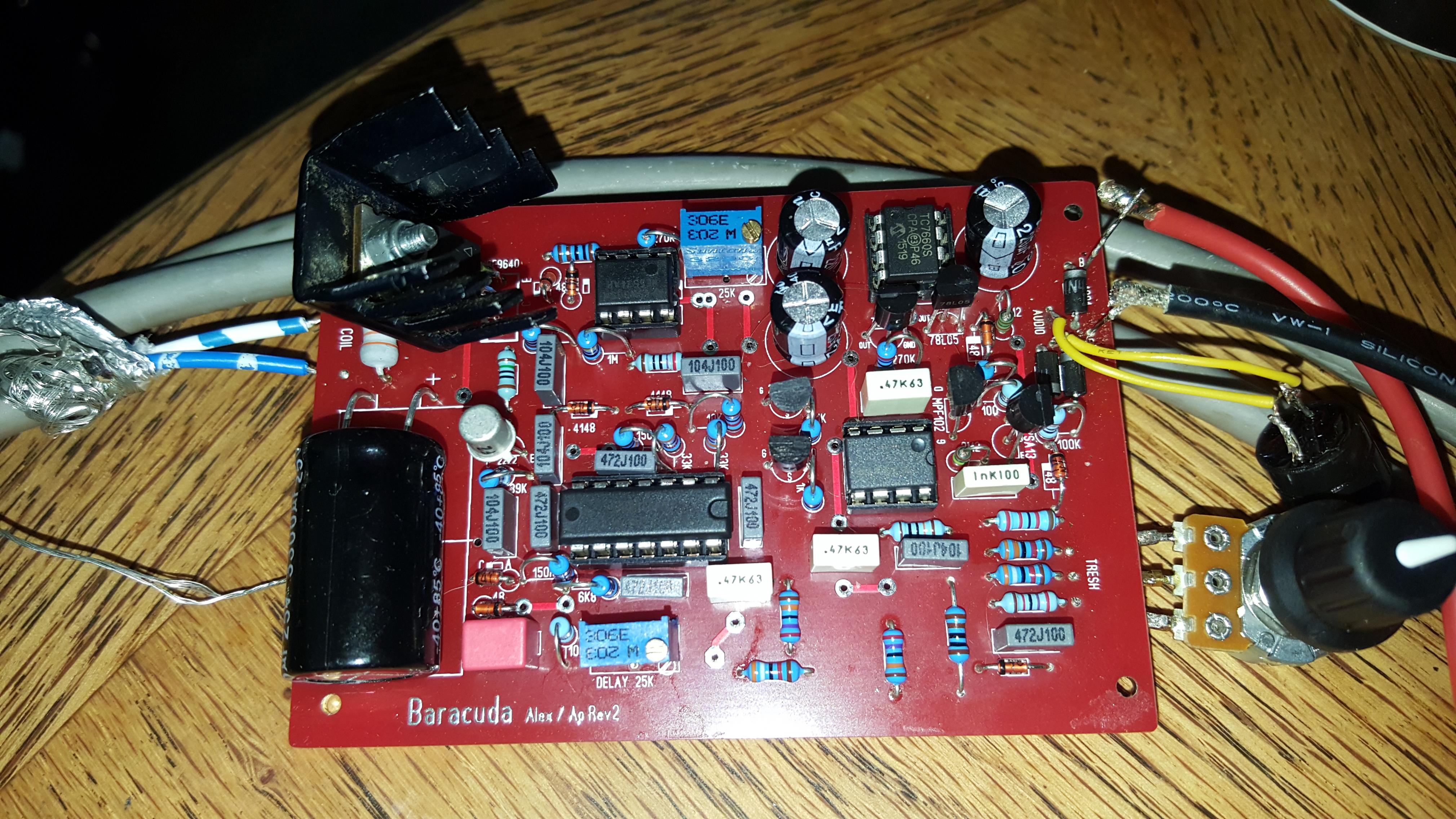

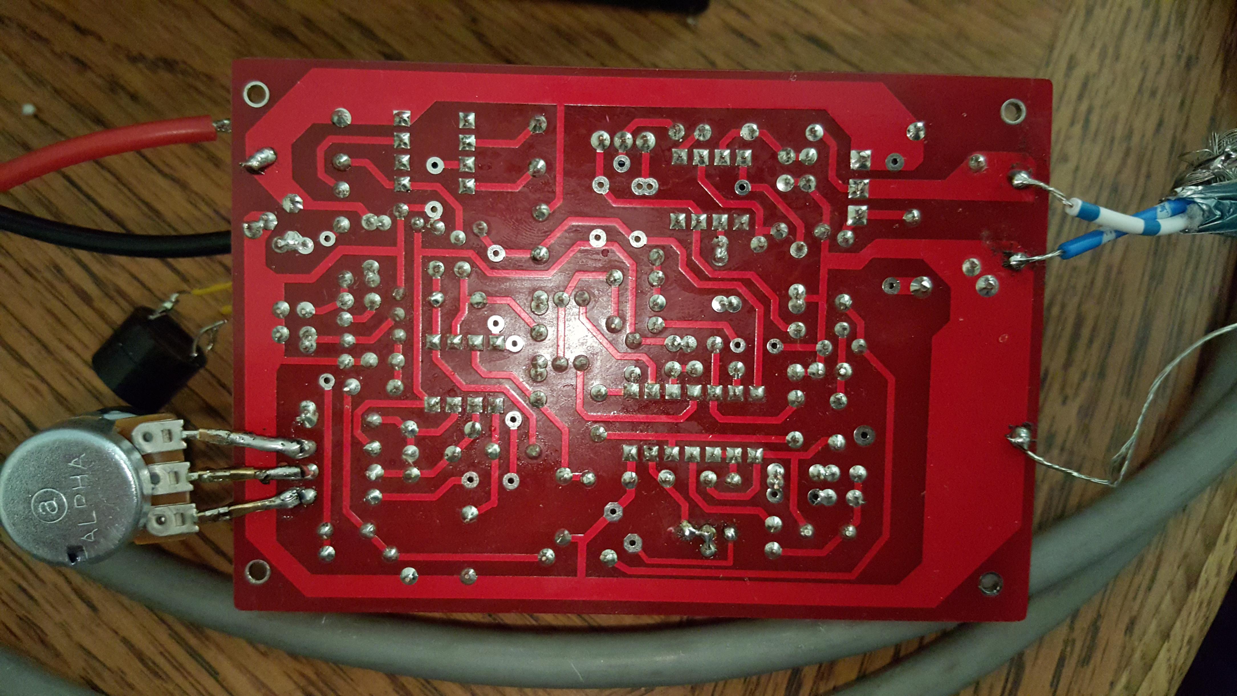

    • Hey old cart i have a rev2 board there is a link between those two points? and no i havent got any 10k pot i thought the 25k delay trim was the only adjustment
      heres the pics
      front Click image for larger version
      back Click image for larger version

        It is fine if that is jumpered but you must then very careful that the trimmer is never set to 0 ohms. I would set the delay trimmer to the mid position by counting turns alternately you can measure resistance with the power off between the center pin and the pin not connected to the center on that trimmer and set it to 12K ohm. Then put a scope probe on the G pin of each Gate FETS. There are the 2 devices next to each other right below the 2 caps on the top of the board as viewed the from the component side. For all measurements put both of the scope grounds on the shield lead very close to the board and to each other. Adjust to 50 uS per div and send me the pics. In this case adjusting the delay will have no effect of the position of these gate pulses becuase you are trigging on them. This makes them the reference position horizontally. It does appear that your model does not have a position adjustable trigger. btw did you ever figure out how to move the trace horizontally? I think you can drag it with the mouse or maybe use the scroll wheel. What do those two arrows do above the screen?

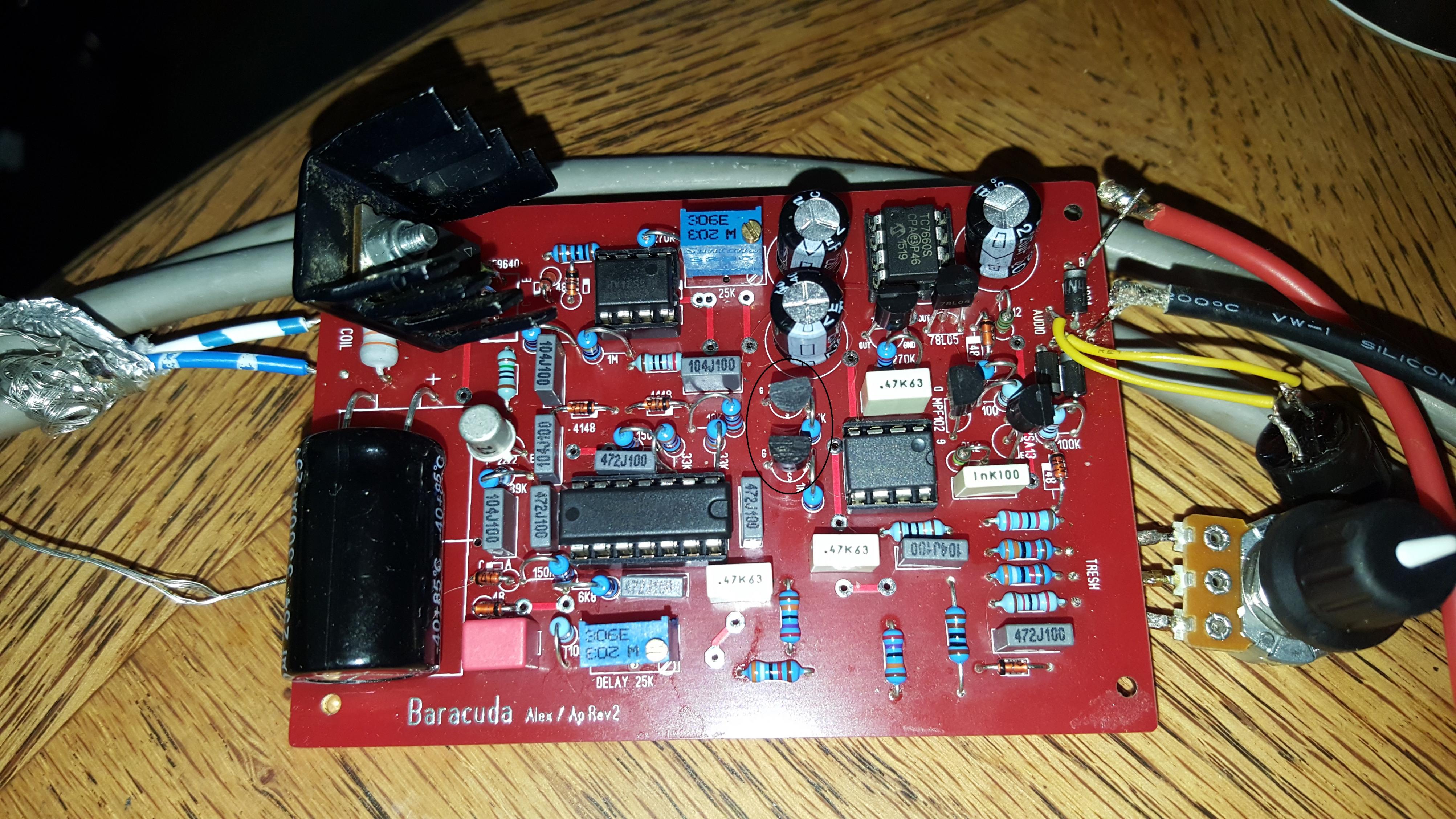

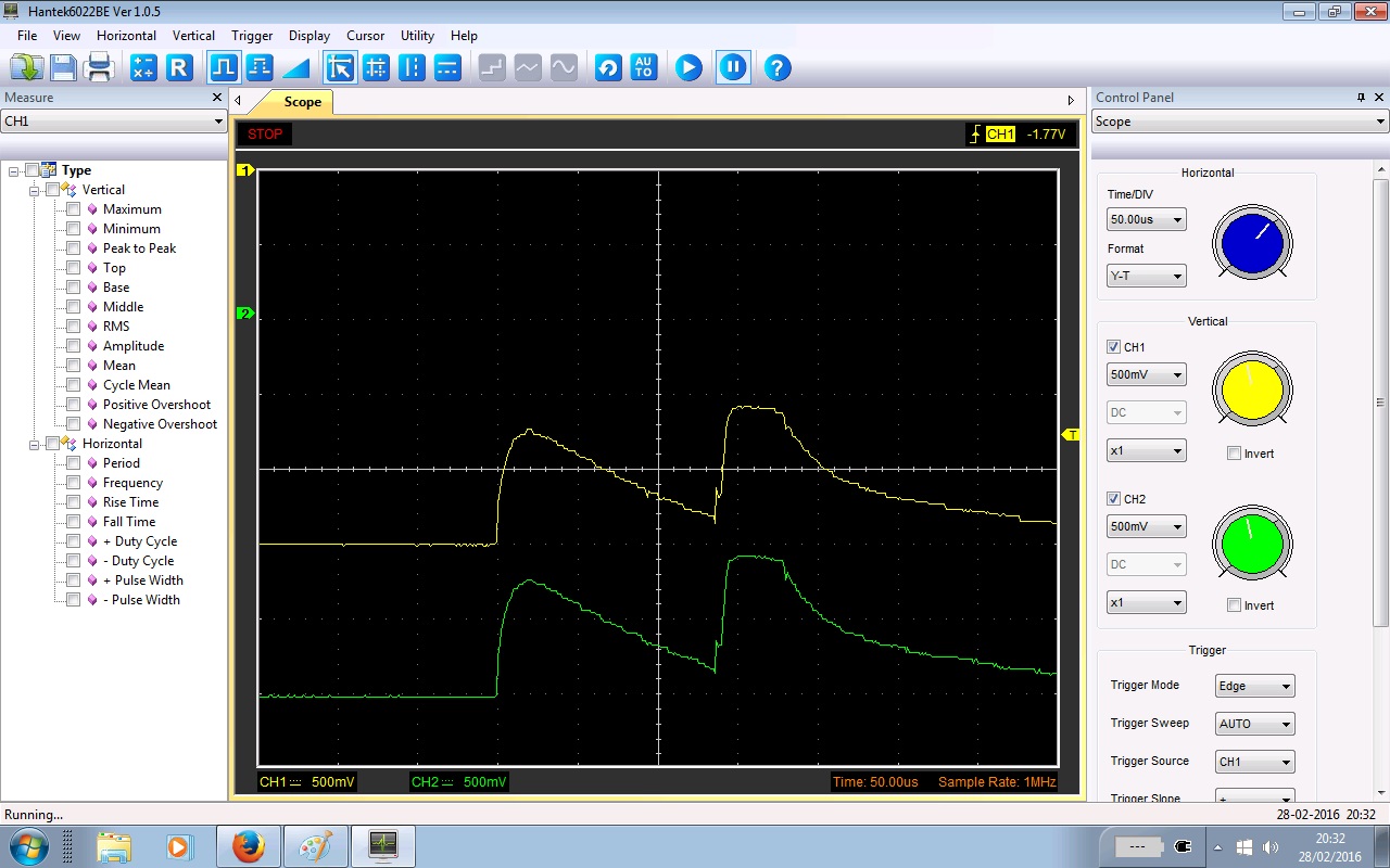

              • Ok so i have set the delay trim to 12k Ohms, i have also put the scope on the Gates of top and bottom FETs circled Click image for larger version
                here Click image for larger version
Name:	yellow top FET green Bottom FET GATES shield gnd.jpg
                • Originally posted by Impulse View Post
                  Ok so i have set the delay trim to 12k Ohms, i have also put the scope on the Gates of top and bottom FETs circled [ATTACH]35333[/ATTACH]
                  here [ATTACH]35334[/ATTACH]
                  Can you repeat at 200uS/ div? These still look wrong to me, I do not understand the first wider pulse or the pulse not being rectangular. Perhaps Kt315 or others can comment whether this is normal for a gate pulse.
                  If it is easy you might also be wise to try switching out the 40106. Those two gate pulse should not look the same. The second one should occur maybe 100 uS later than the first repeated at 600 Hz. Also check the power leads where they solder to the board, the joints look like crystals in the photos. Just reheat them and add a little solder. Check the whole board for cold solder joints. Check for any solder bridges and components that may have leads touching (r17 and 19 look close) on the component side of the board, focus on the area around the 40106. Something seems funny.

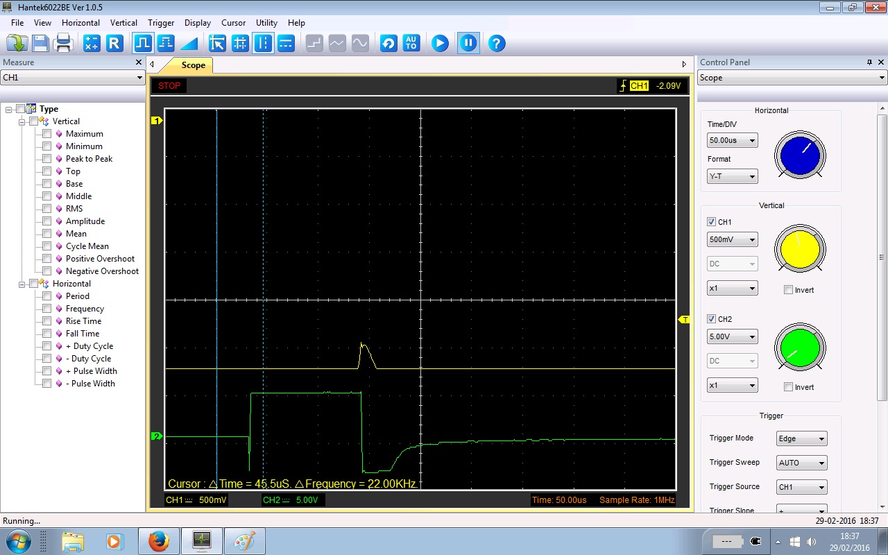

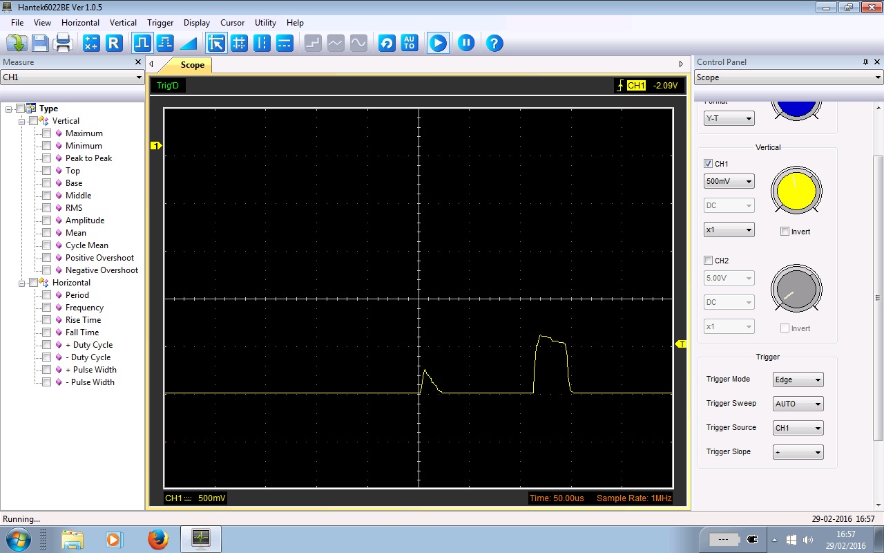

                      • Hey guys i have changed the 40106 to a differnt one and this is the resault at pin2
                        • OK better, follow the items in #133, then leave this probe as is and add a second probe on pin 6 to the 5534. we need to see the relative timing. As usual we will need to see that trace. Sorry this is such a pain but it is hard to troubleshoot without "seeing"!

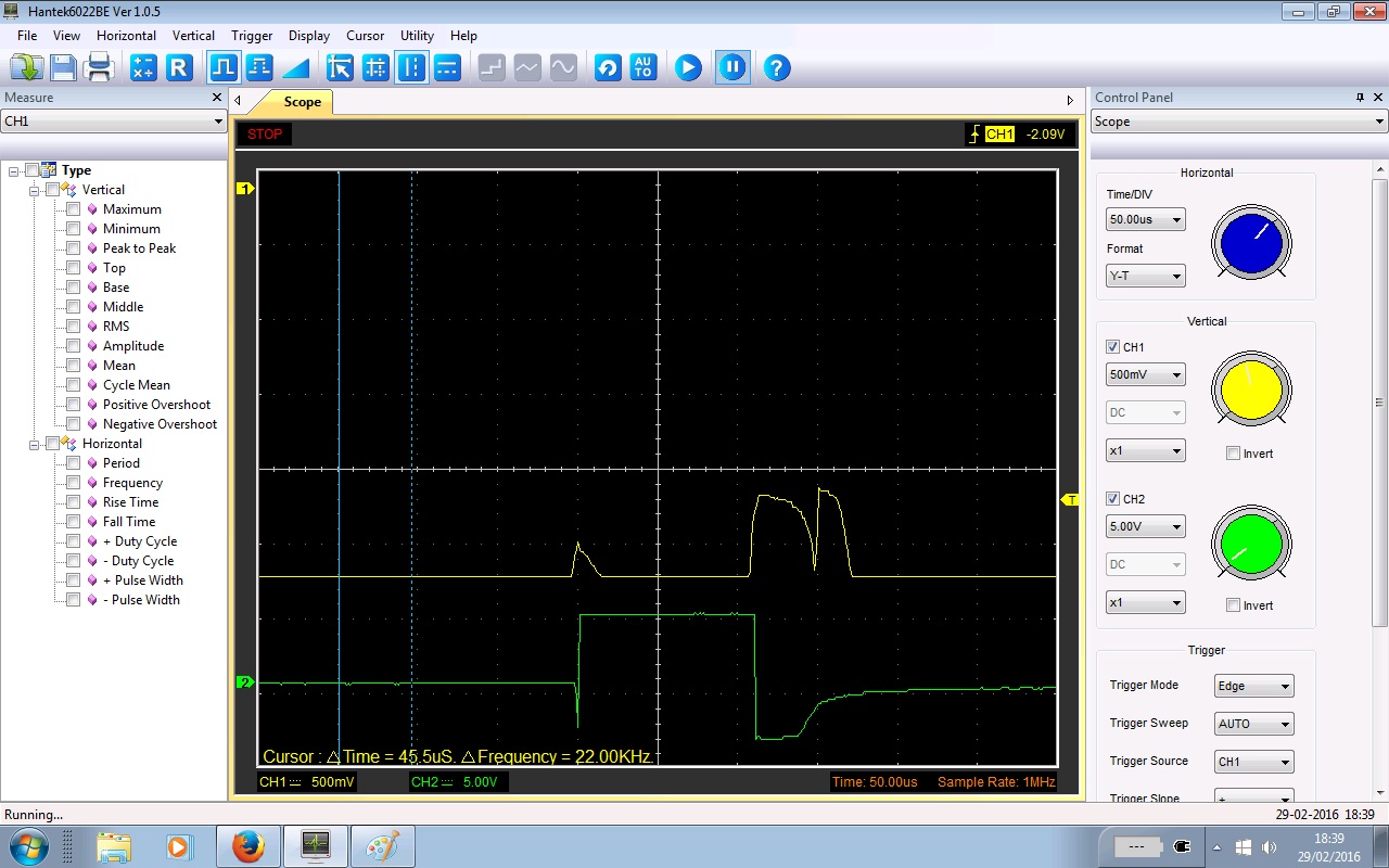

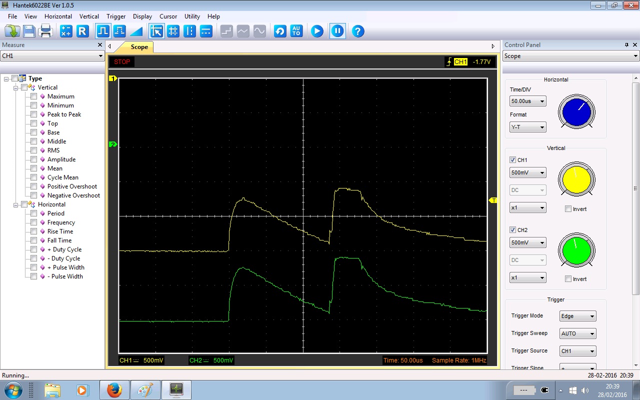

                          • Heres the 40106 pin2 and 5534 pin6
Name:	CH1pin2 40106 CH2pin6 5534.jpg
                              [ATTACH]35343[/ATTACH]
                              now try adjust the delay pot to near both ends of it taking two pictures one near each end.mThis still does not look right. Is the detector working?
                              • yes detector is working not great but is working
                                1k - Click image for larger version
                                Max - Click image for larger version
