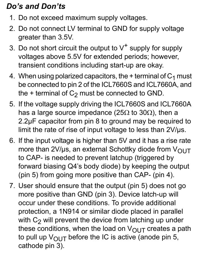

      This may also be part of the problem or compounding it (if I remember right - many were having issues with the 7660)
      See Number SEVEN & possibly SIX ( I don't have Osci, so can't measure that) of datasheet info:
      Could you please also check why most schematics for the Barracuda have a 2M2 resistor going to pin 7 of the 7660.
      Some older schematics have a 1k resistor which works fine and is also shown on the data sheets. Anyway, the whole diode/cap/resistor combo going to pin 7 of the 7660 defies my understanding.
      Perhaps you have an explanation of how it works.
      Hope I haven't stretched this to far, but this looks like a great opportunity to get some more things about the Bara clarified,
      In appreciation, Polymer

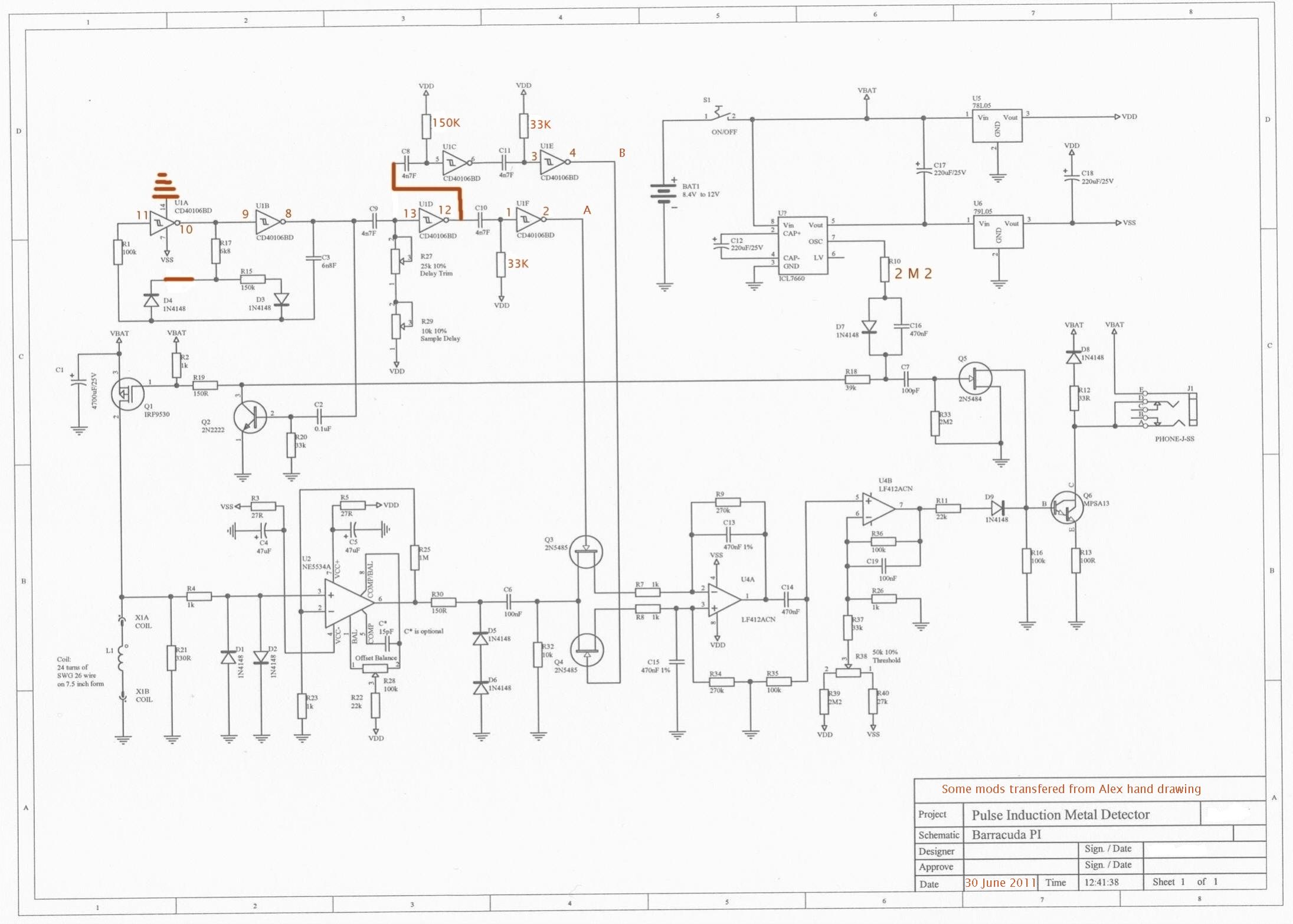

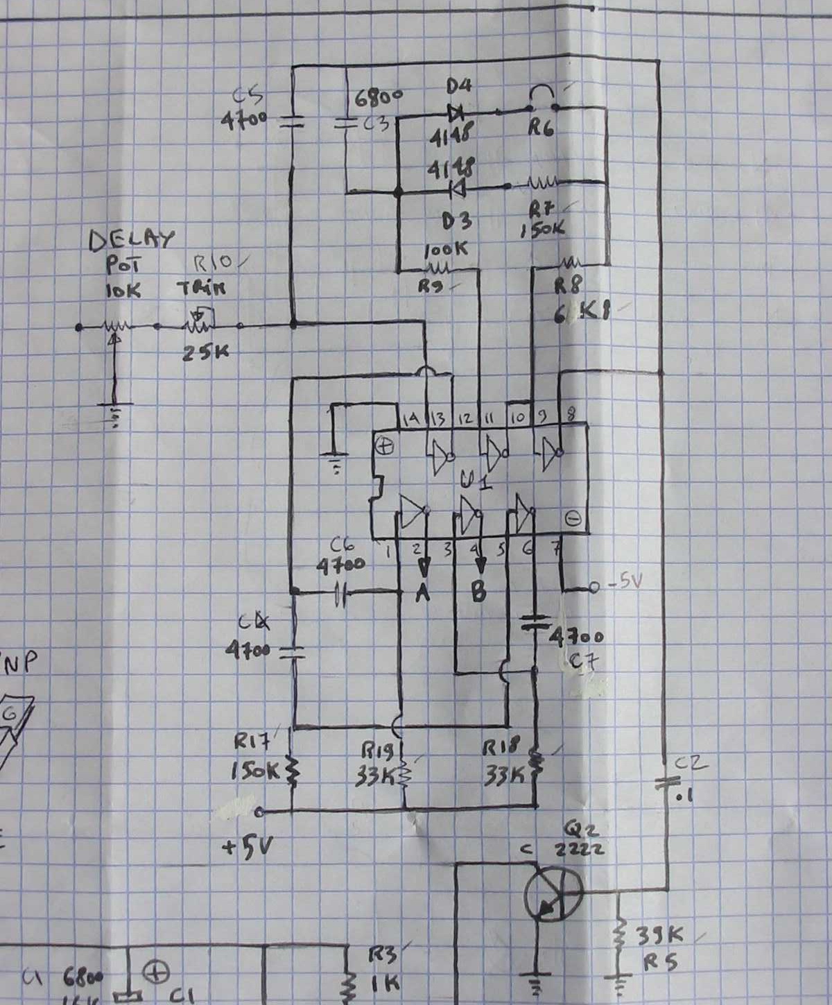

                  I found some time over the weekend to look at the Baracuda that Impulse sent to me.
                  Firstly, referring to post #414:
                  After replacing the CD40106, the detector started working with some improved results. This meant that the detection depth for a Victorian penny was around 6" instead of the previous 2 to 3". I've noticed that 6" appears to be the type of results being achieved by many Baracuda builders, but this [to me] seems quite poor performance. After some further probing with the scope, it was clear that the TX oscillator output and sample pulses / delays are corrupted in some way. Unfortunately, the replacement CD40106 then decided that it was time to kick the bucket, with the result that detection distances for a coin were again reduced to a few inches. During these tests I had been using a 12V lead-acid pack, so I replaced the CD40106 for the second time and changed over to a bench power supply with current limit (just in case there was surge problem at switch-on).
                  I also decided to modify the PCB to connect the pull-up resistors to the 0V line rather than +5V. Wow ... what a difference! Detection of a Victorian penny was now easily achievable at 12" (and maybe even 13") with a 300uH 9" diameter mono coil. There was also a dramatic increase in stability regarding the audio threshold.
                  Now, let's backtrack a little:
                  The original CD40106 was kaput, and upon replacing it I took some measurements with the scope. It was possible to adjust the main sample delay between 11us and 38us with R29 (sample delay) pot. The lower limit is restricted by R27 (delay trim) to 11us because the sample pulse disappears at any setting below this value. On occasion it was noticed that the TX oscillator would fail to start.
                  TX pulse rate = 645 pps
                  TX pulse width = 95us
                  Main sample pulse width = 17us
                  Earth field pulse width = 34us
                  Earth field pulse delay = 182us
                  From the above results it is clear that there's a problem. The EF pulse is twice the width of the main sample, and hence the Earth field is not being eliminated correctly. This is something that's been noted by some people, and in fact (on this particular detector) it was responding to a whiteboard magnet several inches from the coil.
                  After the modification (shown in the attached Modification.jpg file) - which consists of cutting a track and soldering in a short jumper wire - the TX-on pulse was approximately the same at 94us, but with an amplitude of -5V (this was previously at -4V), and a pulse rate of 644 pps.
                  Main sample pulse width = 98us
                  Earth field sample pulse width = 120us
                  Earth field sample pulse delay = 440us
                  In practice it was found that the lowest main sample delay was 27us (and not 11us) as the main sample pulse gradually reduces in width below this setting. You can readily see that the EF pulse width still does not match the main sample pulse width exactly, but it did improve the EF elimination. Clearly there is still room for improvement in this area.
                  However ... after saving the scope shots and taking the two photos, I thought it might be a good idea to try the detector outside to check for any instability in the coil winding, especially as this appears to be a recurring issue. To carry out the test I disconnected the PCB from the bench power supply and reconnected to the battery pack. Would you believe it? ..... there was an immediate reduction in detection depth, and it turned out that the CD40106 was [yet again] damaged in some way.
                  Anyway, this is what I think is happening:
                  If you examine the schematic in the area of the power supply (top right), you will see that there is a 220uF electrolytic capacitor connected between VSS (-5V) and VDD (+5V). At power-on, the 78L05 becomes active first (since it's connected to the battery input) whereas the 79L05 is driven from the output of an ICL7660. This charge pump takes a finite time to get started, with the result that the -5V supply lags behind the +5V supply when the battery is connected. Unfortunately there's a 220uF electrolytic capacitor connected between the +5V and -5V supply lines. This is wrong, and there should be two separate capacitors connected from each of the power supplies to 0V (not to each other). When the battery is connected, the 220uF capacitor looks like a short-circuit, which means that the +5V supply gets connected momentarily to the -5V supply. The result is that the CD40106 has its power line connected in reverse when the detector is switched on. When I was using the bench power supply, there is an additional delay while the PSU output ramps up, and so the circuit survives. But as soon as you connect a battery pack, then things can go horribly wrong.
                  I'm going to have to order some replacement CD40106 ICs, and then modify the power supply section. Hopefully the 12" detection range can then be restored. Finally, note that there's a second 220uF electrolytic capacitor across the regulator inputs as well, which needs attention.
                  In the meantime, it might be a good idea for others to make the same scope measurements and compare to my "good" readings below.

                  • Originally posted by Michaelo View Post
                    Qiaozhi, on the Main sample pulse delay.BMP, can you give me the pin numbers for both traces and which pin is the Earth field sample?
                    I made changes to both the 220uF caps and the noise on the +5 volts has disappeared, -5 has a little noise still but it's better...
                    Mike
                    TX oscillator -> U1 pin 8
                    Main sample pulse delay -> U1 pin 12
                    Main sample pulse -> U1 pin 2
                    Earth field sample pulse delay -> U1 pin 6
                    Earth field sample -> U1 pin 4

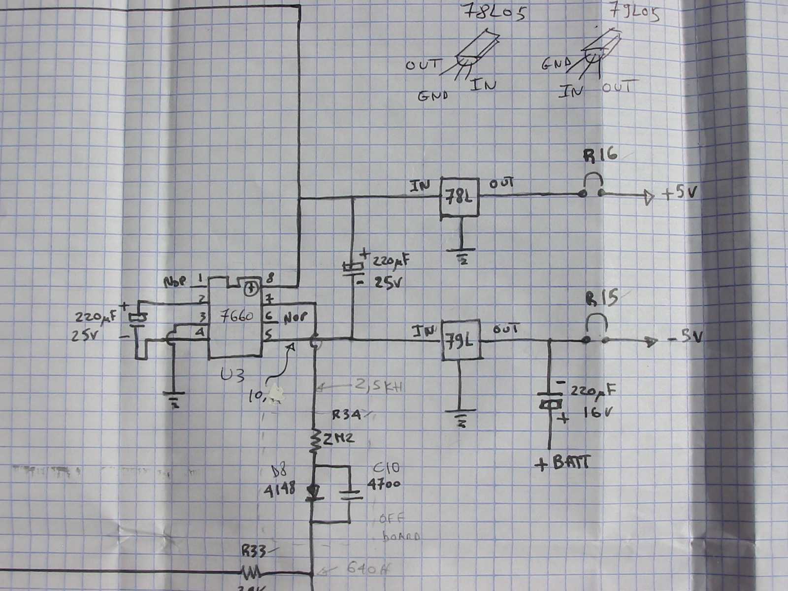

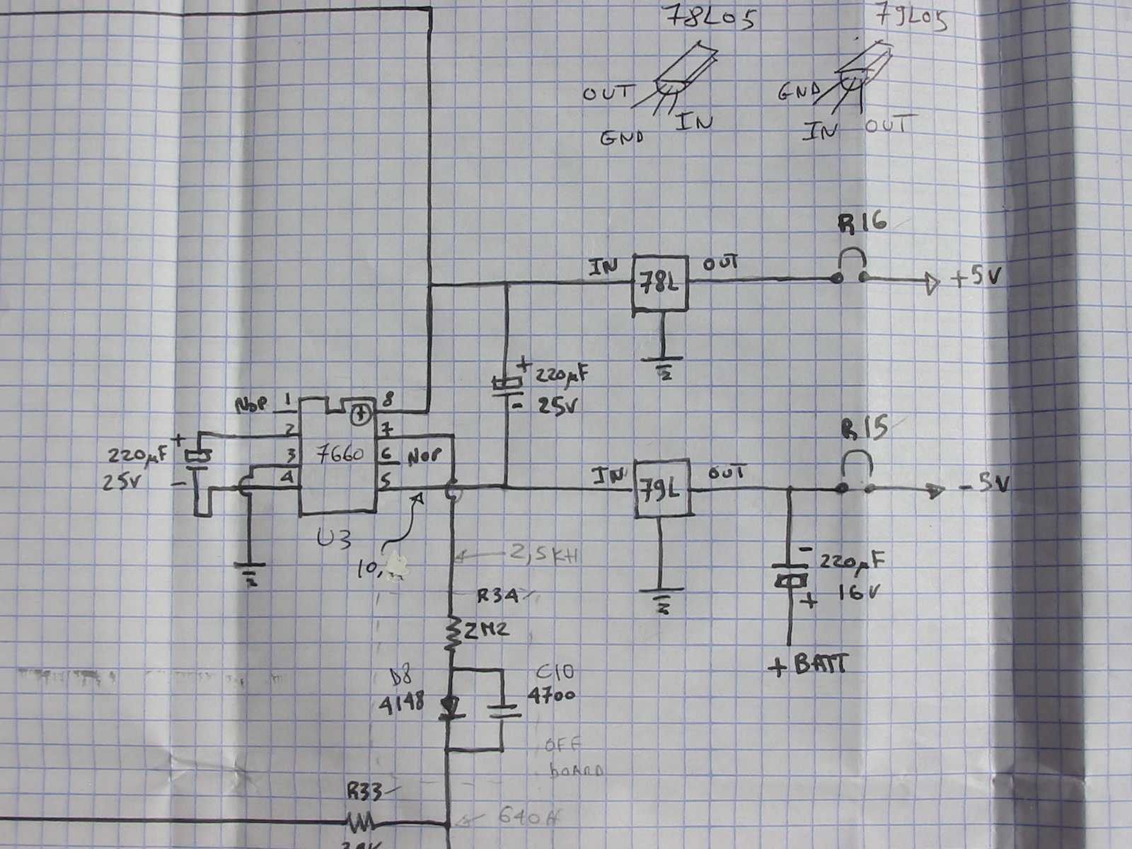

                    The schematic (attached) shows the 220uF cap connected between -5V and +5V, but looking the PCB layout (also attached) it appears to be the same as your circuit. This is even worse, as the full battery voltage (in reverse polarity) is momentarily applied across the CD40106 at power on. No wonder the ICs keeps blowing. Also, this means that there's no capacitance at the output of the 78L05. In fact, this is not the only difference between the schematic and the layout. There's a reverse-biased diode across the battery input pins, and there's none shown in the schematic.
                    The points you highlighted in the datasheet are related to device lockup, which doesn't seem to be the problem here.
                    Pin 7 of the 7660 is used for connection to an external oscillator. However, the TX oscillator in a PI is not normally suitable for the driving the 7660, so it appears (as is the case with the MPP) that this arrangement of components is designed to keep the internal oscillator of the 7660 in sync with the TX oscillator. What happens in the MPP is that the 7660 internal oscillator is temporarily stopped to get the edges in step, and a similar thing is happening with the Baracuda. However, I haven't checked the effectiveness of this particular configuration yet.

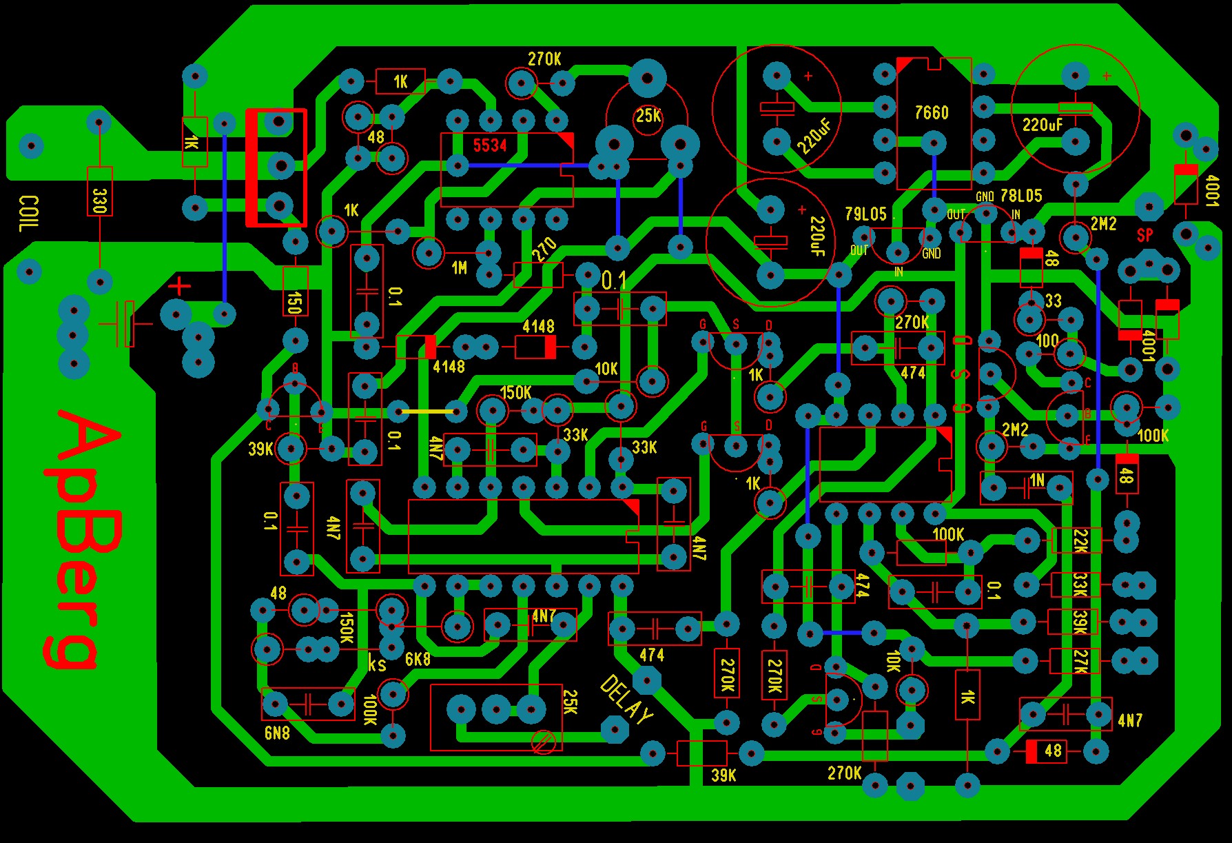

                        It appears that the PCB layout (previously attached) does have an external threshold pot, as does the schematic; but the actual PCB has this shorted out. I can see where Impulse broke the track on the upper layer.

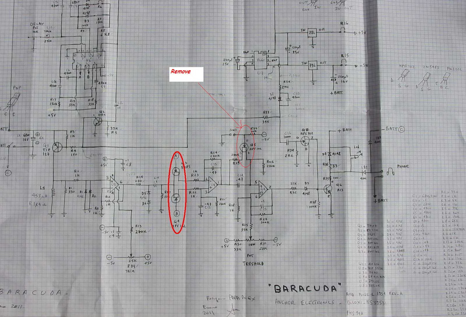

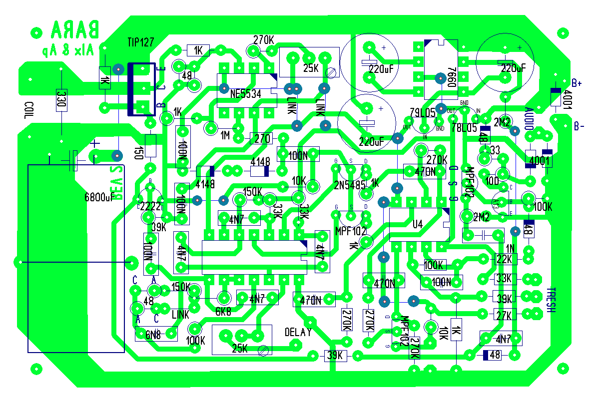

                              • The schematic (attached) shows the 220uF cap connected between -5V and +5V, but looking the PCB layout (also attached) it appears to be the same as your circuit. This is even worse, as the full battery voltage (in reverse polarity) is momentarily applied across the CD40106 at power on. No wonder the ICs keeps blowing. Also, this means that there's no capacitance at the output of the 78L05. In fact, this is not the only difference between the schematic and the layout. There's a reverse-biased diode across the battery input pins, and there's none shown in the schematic.
                                Hi Q
                                The schematic with the orange writing should not be used, the orange writing is mine, I started to mod that old schematic which has mistakes but never finished it, dont use it.
                                You should be useing the hand written schematics by Alex and the pcb layout both attached they best reflect the REV2 pcb
                                How the REV2 pcb was arrived at went something like this, from what I can remember.
                                There were 2 old schematics that both had mistakes on, Alex redraw the schematic, APberg made a new PCB layout, there was a bit of discussion about layout with Silverdog and he had the REV2 pcb made and provided kits, the TIP127 was an option, the led on the audio output was an option,
                                An optional delay pot can be fitted , a link is provided between 2 spare holes on the REV2 pcb , which needs to be cut if a external delay pot is fitted.
                                and leaving out OR removing Q5 the mpf102 was an option for increasing stability with the threshold, I removed the mpf102 and the threshold stability improved a lot.
                                There was also some discussion about the 2 gate fets, weather they should be different fets or the same to help improve stability and sensitivity, so there is a mixture of gate fet combinations out there, apparently there were 2 different fets on an original PCB, I have 2 different fets but the Bara works fine, hope this helps.
