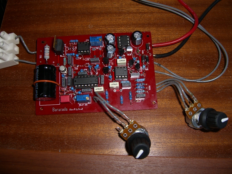

                        • Update on Baracuda from Impulse
                          I found some time over the weekend to look at the Baracuda that Impulse sent to me.
                          Firstly, referring to post #414:

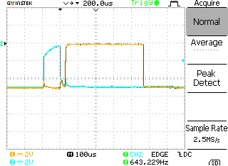

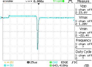

                          I have the Baracuda here, and gave it a cursory glance a few nights ago. The unit was very unstable and with poor detection depth. The first thing I noticed was that the MOSFET was very hot, so I detached the coil and found it to be 166uH which is far too low, and the reason for the excess heat. Power supplies were all in the correct range, but the TX oscillator output was distorted and the main sample pulse was false triggering and giving two separate pulses. During further testing the CD40106 went kaput, with the result that the -5V supply was being pulled down to -3.84V. Literally, a few minutes ago. the postman arrived with a bag of parts including the CD40106 replacement.

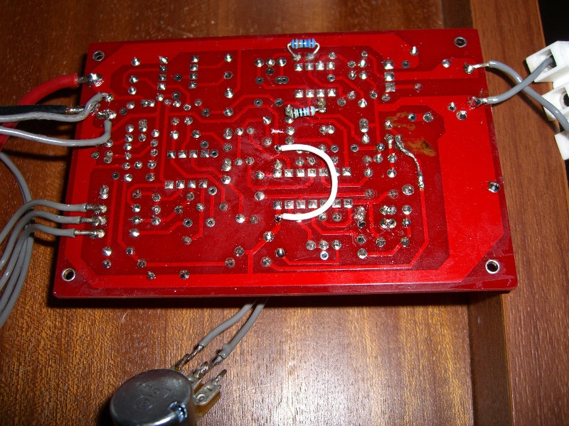

                          After replacing the CD40106, the detector started working with some improved results. This meant that the detection depth for a Victorian penny was around 6" instead of the previous 2 to 3". I've noticed that 6" appears to be the type of results being achieved by many Baracuda builders, but this [to me] seems quite poor performance. After some further probing with the scope, it was clear that the TX oscillator output and sample pulses / delays are corrupted in some way. Unfortunately, the replacement CD40106 then decided that it was time to kick the bucket, with the result that detection distances for a coin were again reduced to a few inches. During these tests I had been using a 12V lead-acid pack, so I replaced the CD40106 for the second time and changed over to a bench power supply with current limit (just in case there was surge problem at switch-on).
                          I also decided to modify the PCB to connect the pull-up resistors to the 0V line rather than +5V. Wow ... what a difference! Detection of a Victorian penny was now easily achievable at 12" (and maybe even 13") with a 300uH 9" diameter mono coil. There was also a dramatic increase in stability regarding the audio threshold.
                          Now, let's backtrack a little:

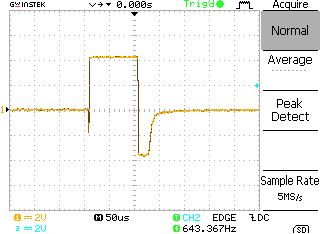

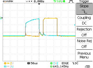

                          The original CD40106 was kaput, and upon replacing it I took some measurements with the scope. It was possible to adjust the main sample delay between 11us and 38us with R29 (sample delay) pot. The lower limit is restricted by R27 (delay trim) to 11us because the sample pulse disappears at any setting below this value. On occasion it was noticed that the TX oscillator would fail to start.
                          TX pulse rate = 645 pps
                          TX pulse width = 95us
                          Main sample pulse width = 17us
                          Earth field pulse width = 34us
                          Earth field pulse delay = 182us
                          From the above results it is clear that there's a problem. The EF pulse is twice the width of the main sample, and hence the Earth field is not being eliminated correctly. This is something that's been noted by some people, and in fact (on this particular detector) it was responding to a whiteboard magnet several inches from the coil.

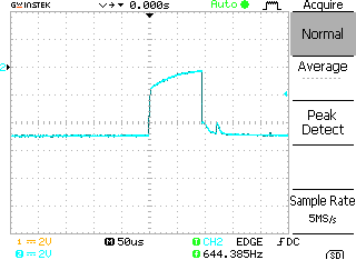

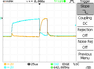

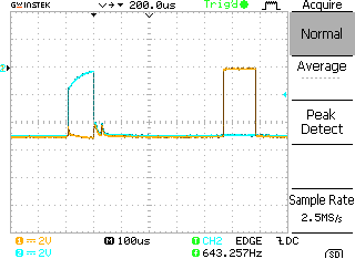

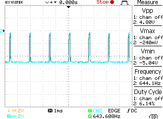

                          After the modification (shown in the attached Modification.jpg file) - which consists of cutting a track and soldering in a short jumper wire - the TX-on pulse was approximately the same at 94us, but with an amplitude of -5V (this was previously at -4V), and a pulse rate of 644 pps.
                          Main sample pulse width = 98us
                          Earth field sample pulse width = 120us
                          Earth field sample pulse delay = 440us
                          In practice it was found that the lowest main sample delay was 27us (and not 11us) as the main sample pulse gradually reduces in width below this setting. You can readily see that the EF pulse width still does not match the main sample pulse width exactly, but it did improve the EF elimination. Clearly there is still room for improvement in this area.

                          I'm going to have to order some replacement CD40106 ICs, and then modify the power supply section. Hopefully the 12" detection range can then be restored. Finally, note that there's a second 220uF electrolytic capacitor across the regulator inputs as well, which needs attention.
                          In the meantime, it might be a good idea for others to make the same scope measurements and compare to my "good" readings below.

                            • Qiaozhi, on the Main sample pulse delay.BMP, can you give me the pin numbers for both traces and which pin is the Earth field sample?

                                Q Could you also do any testing with an English pound coin as well thanks, and what revision PCB do you have ?
                                Which schematic are you useing? on my REV2 pcb there are no caps on output of 78l05
