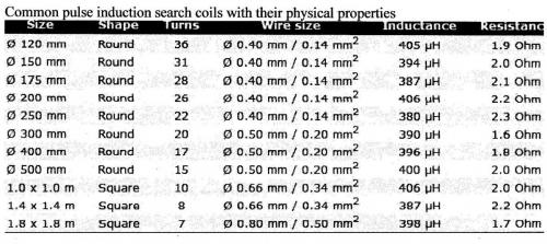

                        That is why I proposed some small standardized test coils be made available, maybe through Silverdog. If this was desirable what coils would we need? Maybe a 100mm in diameter 300uH, 450uH, others?

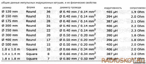

                          • KEEP THOSE TABLES ANYWHERE. i give them again and again and again. i gave them 10th times.
                            you dont need a calculator and calculate

                              Sorry KT, I have never seen those tables, and I spend a lot of time on this forum.
                              But that is not exactly what I was looking for. I think it is a table that you published that showed the L and R of coils listed by the name of the detector they go with. I can not find it now. As we say in America- I have my **** together, I just can not lift it! ( I do not know if that wil translate well)

                              • Hi Old cart,
                                This might be the list you are looking for. I found it accidentaly whilst I got "lost" clicking around on this site ...
                                http://www.geotech1.com/cgi-bin/page...oils/index.dat
                                I know I have a very comprehensive coil parameter list from this site on hard disk, It'll take a bit to find it, but I will post once found ...
