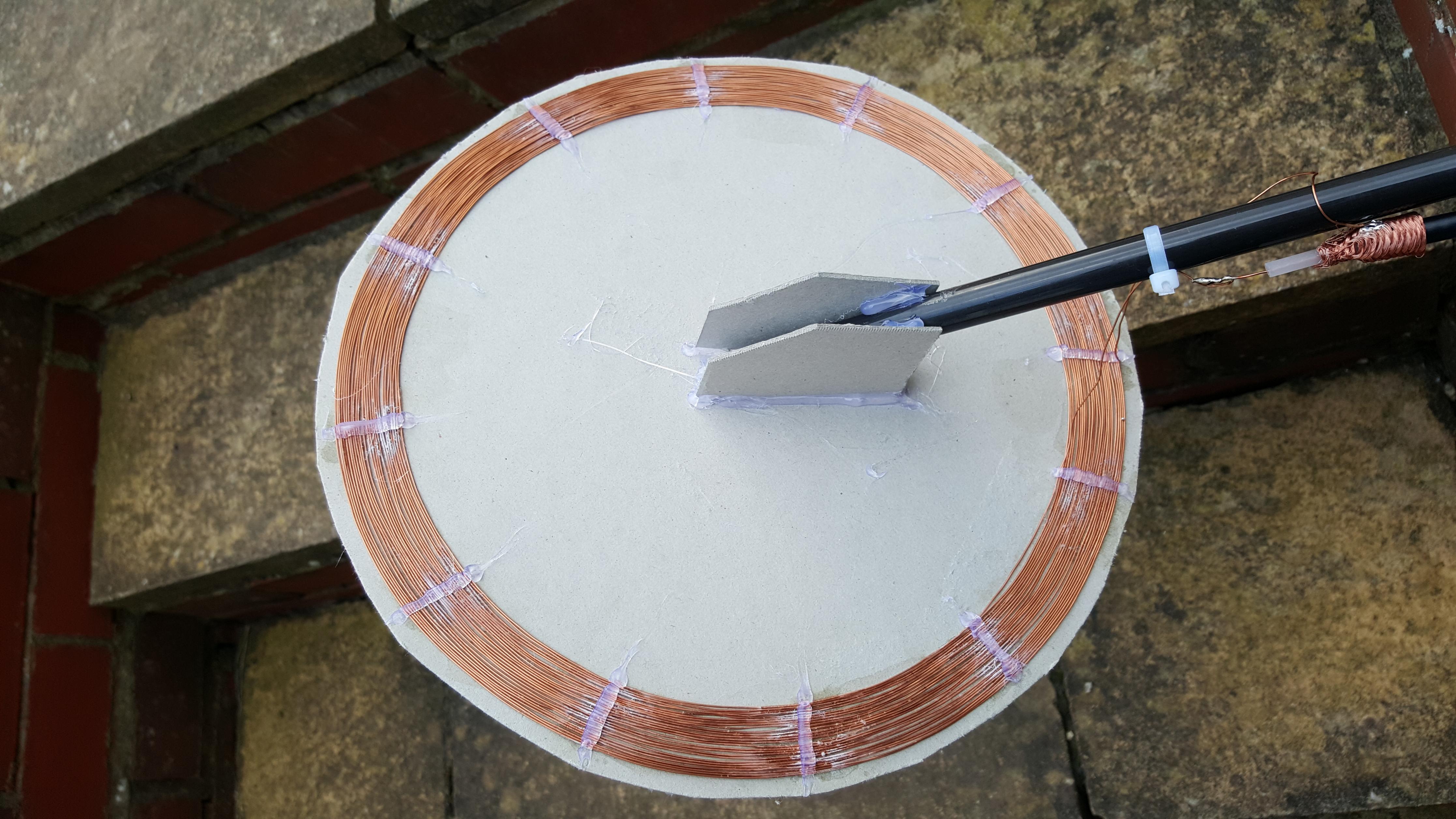

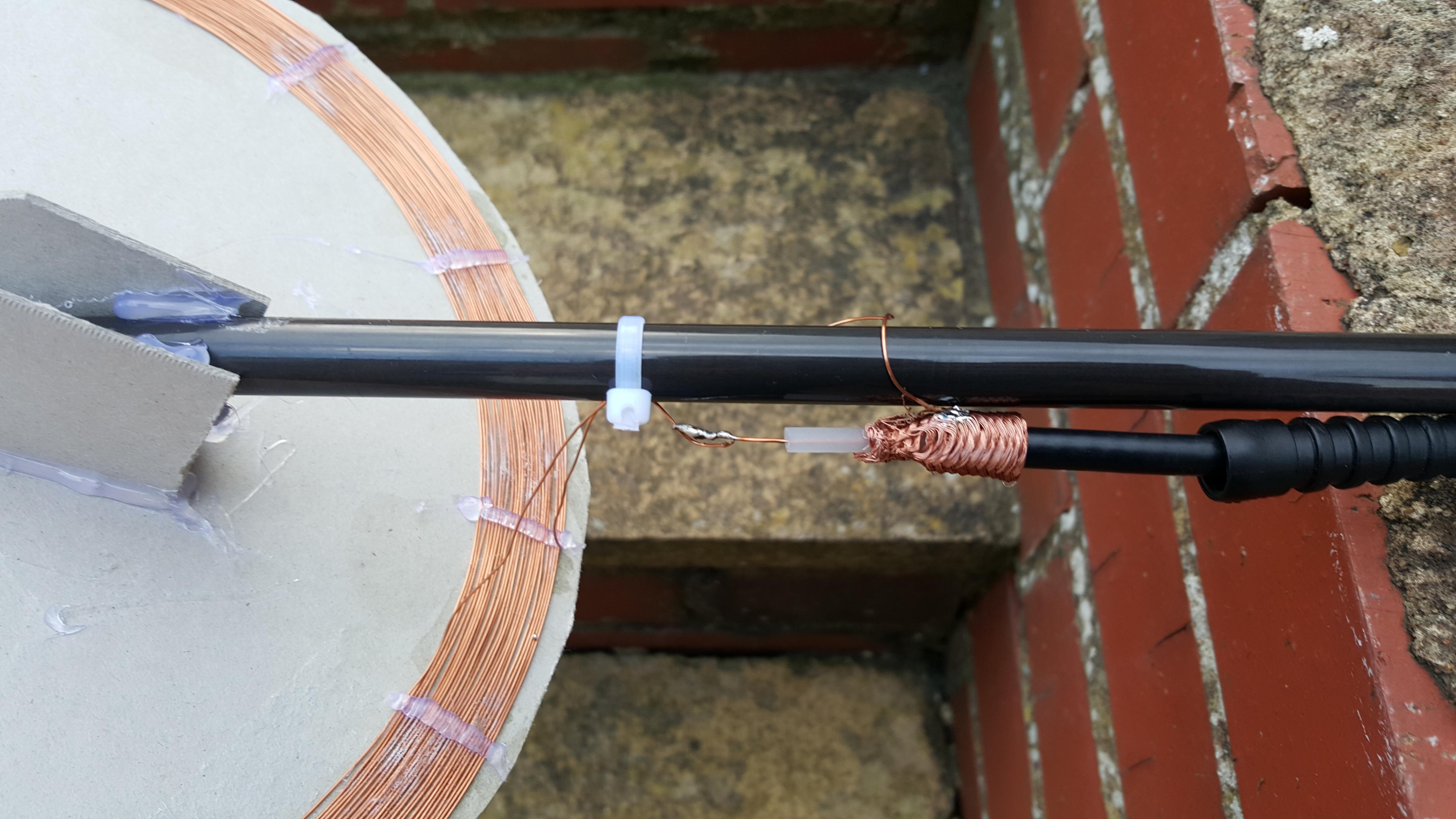

            • Originally posted by Impulse View Post
              no i mean i cannot physically move it around if i move it BEEPBEEPBEEP i do not understand why? what wire are you using between the coil and board? I have a dual core foil covered + sheilded cable.
              I'm with you now. I've yet to use coil screening. I'd do experience some mild ground effects on the PI-1 with a low capacitance thick plastic insulation wound coil, which is to be expected. Also I do remember the odd beep at end of a swing, until I tightened the coil restraints.
              I use spare TV extension leads that come with video recorders and the like. Length a metre and a bit. (Just discovered that lengths do vary). Remove socket on one end only. I repurposed parts from a TV aerial splitter socket box for a plug to go in the wall of the electronics box. Plan B there would be to glue in the plug just cut off as they are a mating pair. That is of course the "use what's to hand" approach.
              Ahh... I've pulled all the wires, added a battery and my Barracuda has had its first trip to the garden and yes random...ish Beep...Beep. I'm moving the coil around holding it mid lead, as there may be some hand capacitance effects, if I hold the bare coil. (Seems to make little difference actually). My first shot at sorting this will be securing the short coil ends leading to the cable. I'm using quite thick coil wire. I'll have to play with it later, but I mine would have to be coil movement I would have thought. Another idea will be trying it mobile with the PI-1. It may just be the same. Then try some another coil. Look for a pattern.
              Stopping movement is one of the reasons for "potting" the coil. I've just got a few thread ties holding mine plus occasional masking tape securing it to a backing plastic disk for rigidity.

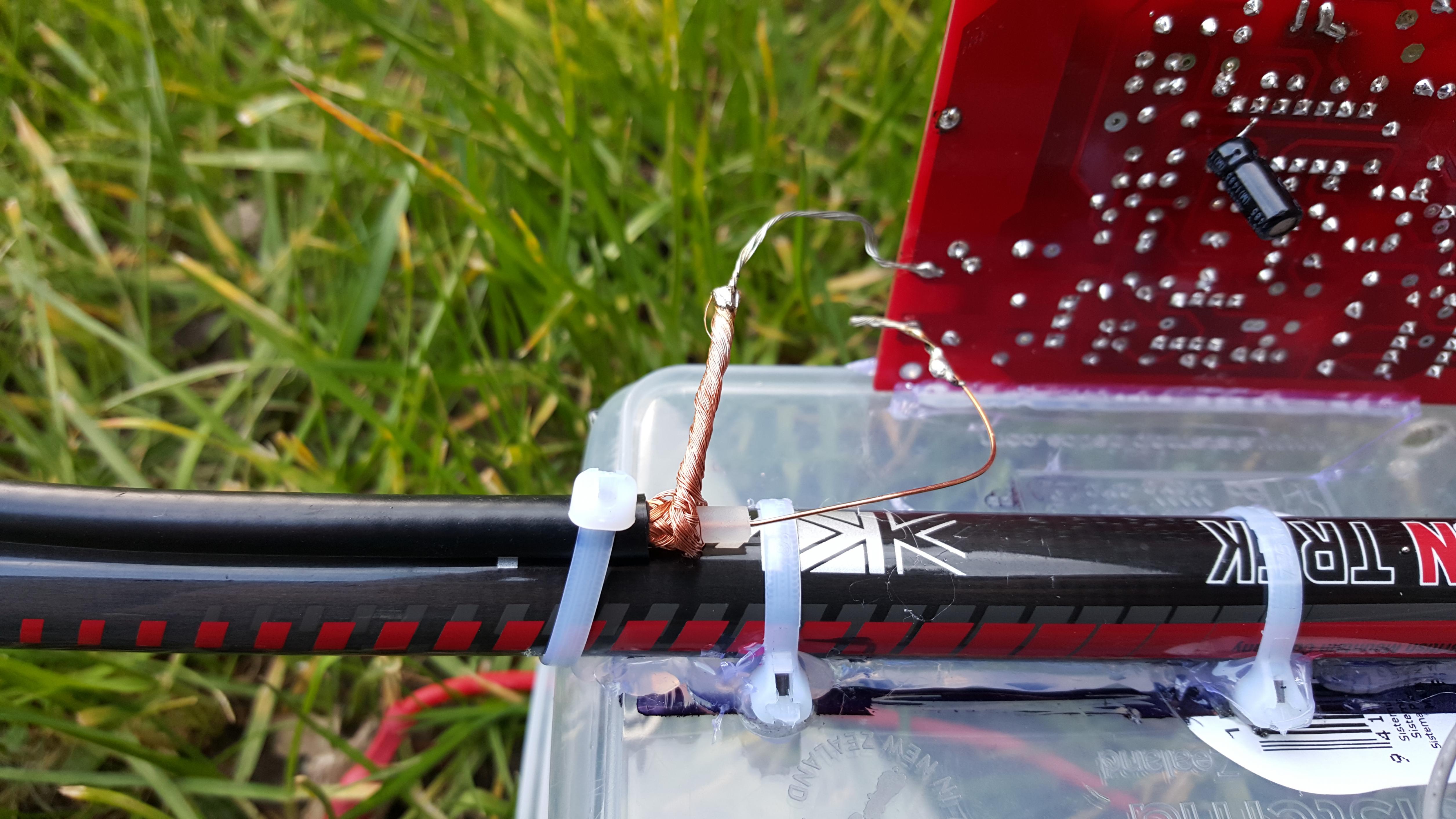

                • Originally posted by Old cart View Post
                  This is progress! Try depth test now. Have you got a .1uf cap? If so please solder it, with the leads cut as short as possible. One the back of the board between pins 7 and 14 on the 40106. Remember the pins are upside down and reversed becuase this is the back of the board so confirm before soldering.
                  on second thought this dual core coax probably has high capacitance. Swap it for coax as soon as you can.
                  I have swapped the cable for a peice of coax and now my pc won't work again. I still cannot move it without it giving a false signal
                  • Originally posted by jladre View Post
                    "Beep...beep..beeep" sound?
                    Be sure that your coil cable has a good and not loose connection, the screen must properly connected to the ground, and last be sure your coil is properly fix to the shell so that it will not have movement inside during sweeping.
                    I have zip tied the cable down and the connections are solid I have the coax core as the + and the shield as the -. The coil is glued to a piece of thick cardboard and then glued to the shaft that I am going to use

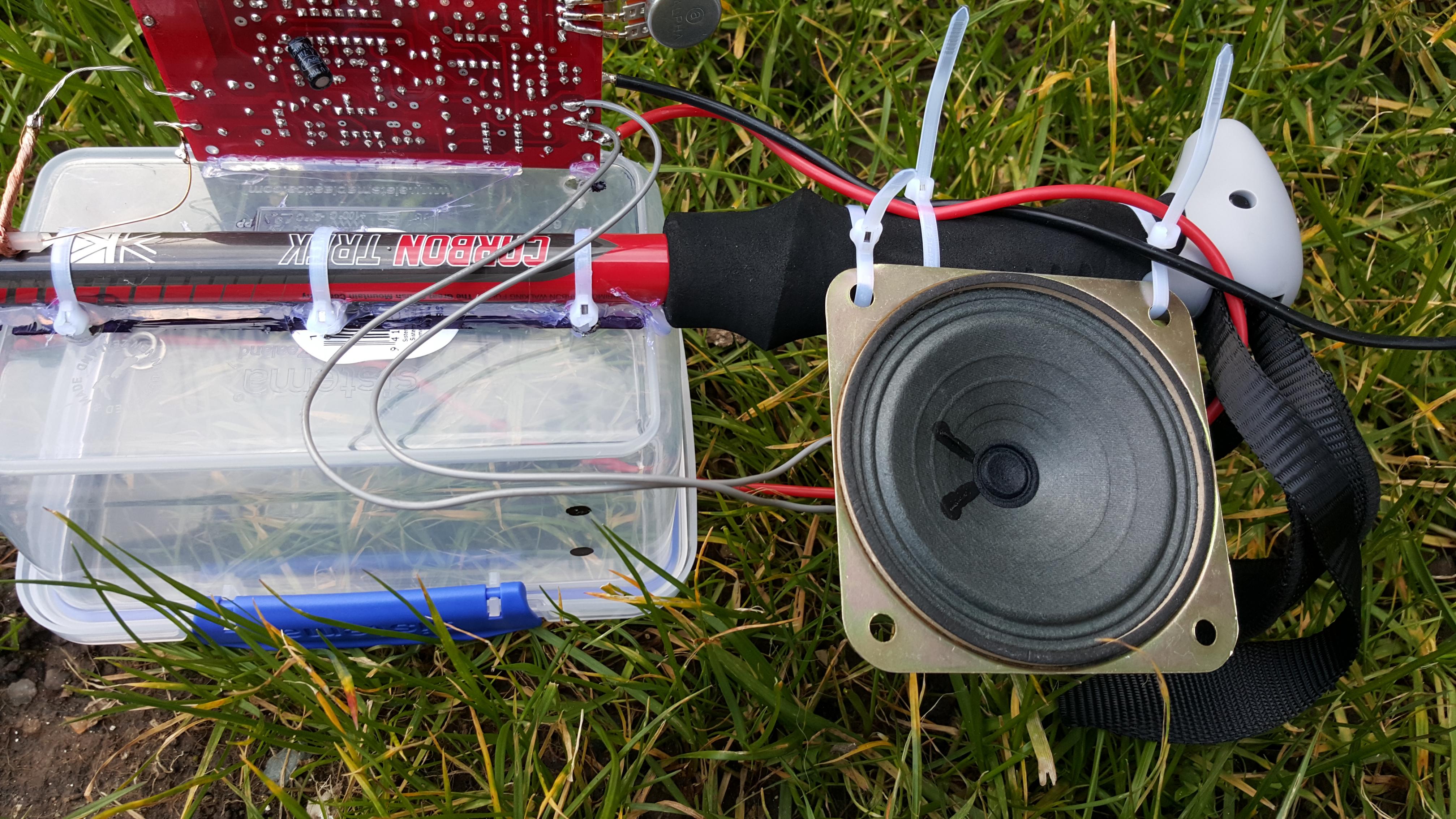

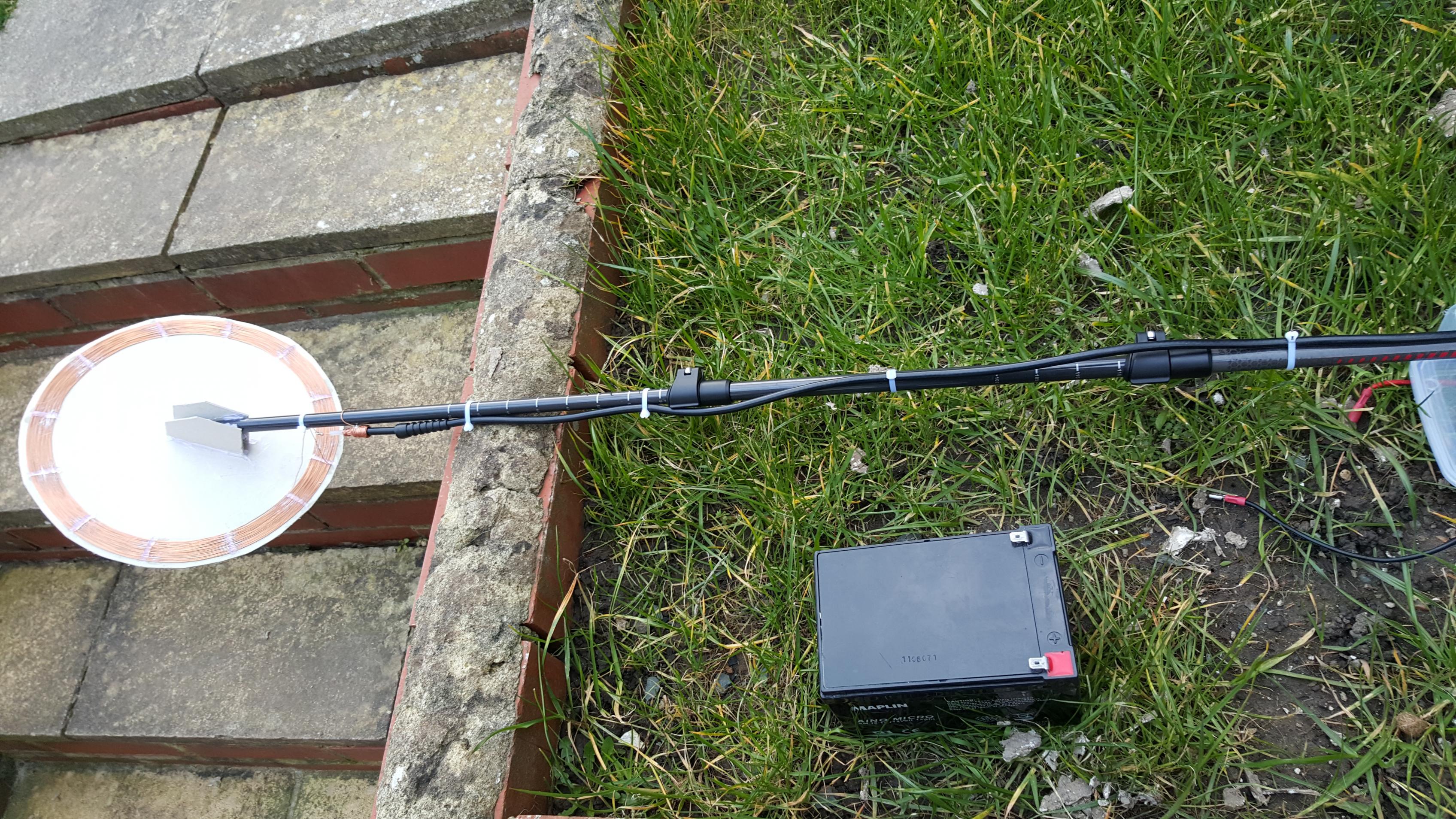

                        This must be very frustrating... All these motion problems! Show me a clear picture of the coil, cable, board end of cable and general surrounding pics. Do you have any radio stations. industrial plants or large electrical equipment like power lines near your house?
                        if no take on of you coils and connect it to the scope, no detector just the coil and the set the scope to the most sensitive range.
                        try 5 uS per div.

                          Here's my test set up I have tried it in the garden and still beep beep beep in mid air. I live next to the coast the most powerful electrical thing near me is my TV and I turn it off when I am testing the board.
