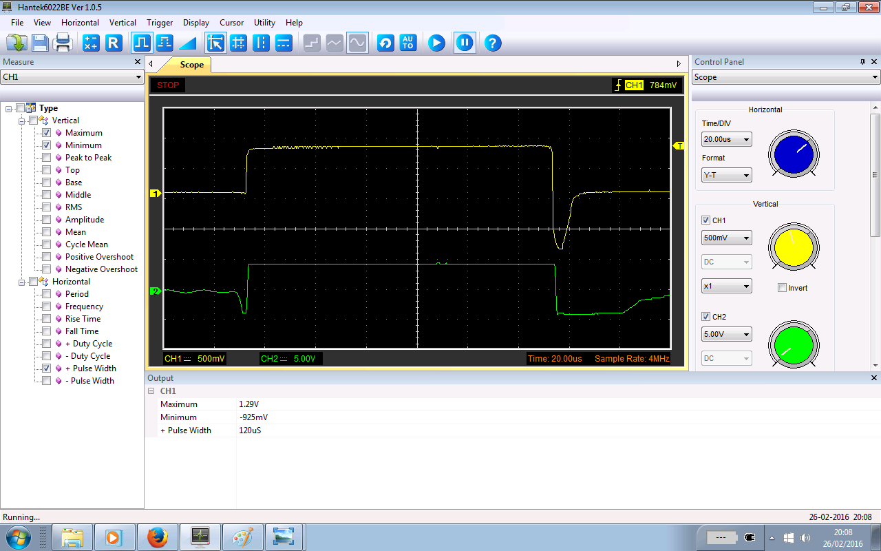

                    • hey guys ok i have tried the scope on pins 3 and 6 i have taken a screen shot of what i get
                      here Click image for larger version
                      so yellow is pin 3 and green is pin 6 on the 40106
                      does this look right to you?
                      • Impulse the setting are about but that is the wrong chip. It needs to be the 5534!, I think that is U1 on the KT 315 schematic. In addition raise the trigger level, the yellow T on the right side, until it is vertically further up on the waveform. Also, set the time base to 50uS per division and take a second shot at 20 uS per division. Lastly set the bandwidth limit to the lowest available 20 or even 5 MHz.
                        You might also select max min frequency and +pulse width from the measurements.
                        This ultimately will require a number of screenshots.

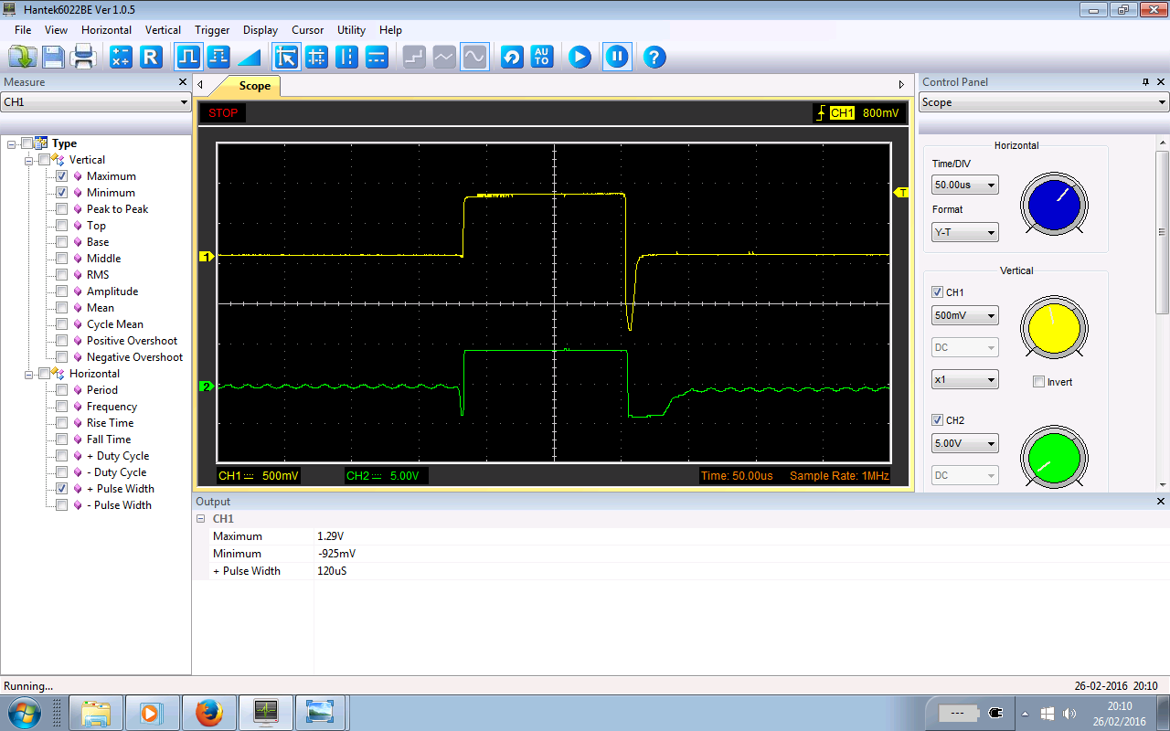

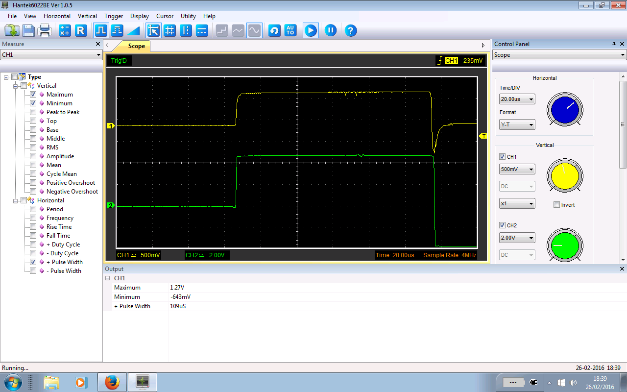

                        • Ok i have taken 2 screen shots one at 50us and one at 20us and i cannot adjust the bandwidth limit theres no option in the software
                          hope these are better

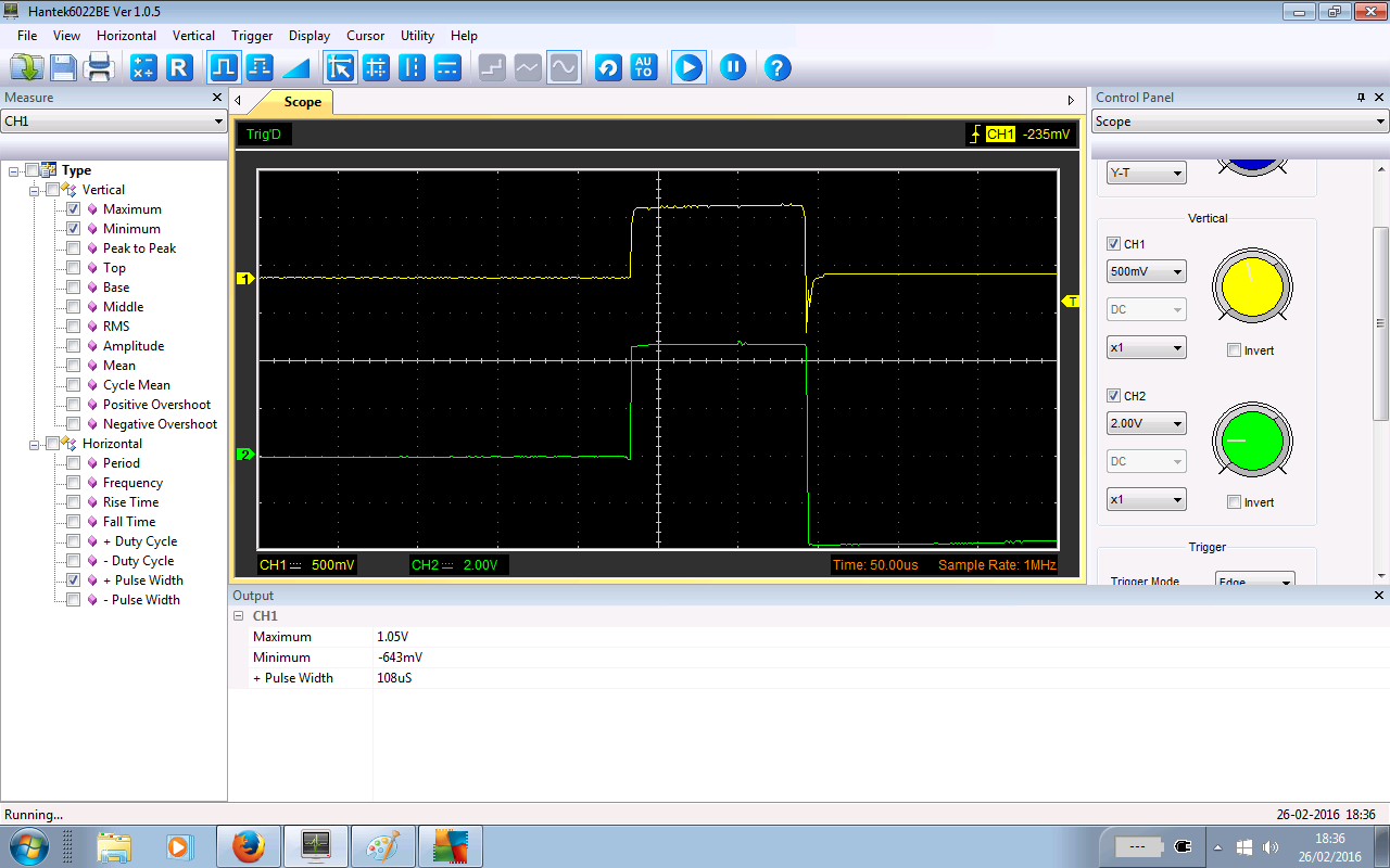

                          • o and yellow pin 3 and green 6
                            • ok heres with trigger raised
                              • Originally posted by Impulse View Post
                                [ATTACH]35286[/ATTACH]
                                [ATTACH]35287[/ATTACH]
                                Well Done, you are getting it! The second set are quite nice. This looks like everything is working well. It may be possible to slightly tweak the damping and get slightly better performance. But you are close. You will also find that slight changes in trigger level can make a big difference in how stable the signal is.
                                Do you see the tiny positive going blips on the yellow trace taken at 50uS with the trigg level raised? Those are likely where the main (1st) sample is being taken. The first blip should be moved to the left using the delay control up to about 10 uS. You want 1st of these two spikes to start right where the green trace finishes the linear part of its rise. You may have to tweak slightly +/- from there because this will have an large effect on the sensitivity to small gold.
                                However, before you do this remove the probe from pin 3 and move it to pin 2 of the 40106. This is the main sample pulse gate and shows exactly where this most important sample occurs. Change the trigger to ch2 and trigger on the negative edge of the green ch2 trace about the same relative level as you have been triggering on channel one. It is also desirable to make each trace fill the screen and superimpose them so that as little of the traces are obscured as possible. The whole objective here is to use the controls to get as much of the signal of interested on the screen as possible. The better you do this the more accurately you can measure the signal.
                                Send us that display.
                                While waiting for an answer You can search this forum and read about adjusting damping.
                                Later as you adjust the damping watching the green trace you may see significant change in the negative going pulse width and shape. Though you have the Dc level at pin 6 set about right you may find that this offset also changes the pulse shape and width. The green trace is after the preamp so shows what is getting to the sampler. You was to to adjust damping with only pin 6 connected as the probe loading on pin 3 can have a slight effect on pin 6.
                                After the damping is adjusted you may have to tweak the delay again. This is also true after you make any changes to the coil or coil wiring.
                                Damping, offset, sampling delay and threshold (for audio part only) all interact and must be adjusted in that order.
