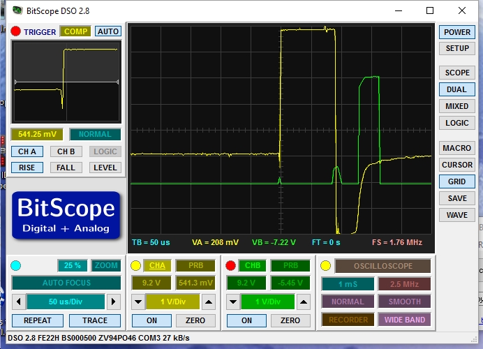

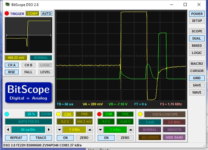

        Hi Old cart,
        Abbreviated post as managed to lose the original...
        I installed a replacement 40106 and amazingly all the unwanted spikes disappeared, and the current went down from 110mA to 90mA!
        Usual pins before: Click image for larger version
        (A garden coil movement test seemed to have improved, only noticable on change of direction of swing.)
        Sadly when I reconnected to grab an after image the spikes started again.. but much lower for now.
        Gut feeling is that it gradually degrades with use. I am noting a spark like sound from headset on start up. I think that hasn't been there for long. Used to be a tone. I'm wondering whether there could be a voltage spike at start up.
        Back to plan A and add those capacitors I guess.
        Good range on a small GB 1p coin. so worth persisting I guess. :-)
        Ray

            Ray good progress. I don't think this problem is anything other than a instrumentation problem. Low cost scopes are great for hobbiest use but you can not expect them to be perfect. They can easily be very noisy, can have poor grounding, and even inject noise back into the circuit. Indeed if you are trying to make critical analog measurements like this I would not even consider a scope that cost less 5-10,000USD.
            That having been said few hobbiests have such a scope nor would I recommend that they get one unless they are very serious about electronics.
            So so we have to use the scopes we have as sort of a compass to help us debug and set up the detector.
            Do you happen to have a US nickel? That would be a good target for testing purposes. Lacking that we can go with a 1cm square section cut from an ordinary Coke can.
            One last point, I did notice your transmitter pulse changed width. This is probably due to the fact the 40106 is a digital IC just to square up and invert a signal. They were never intended to be used as precision timing devices.
